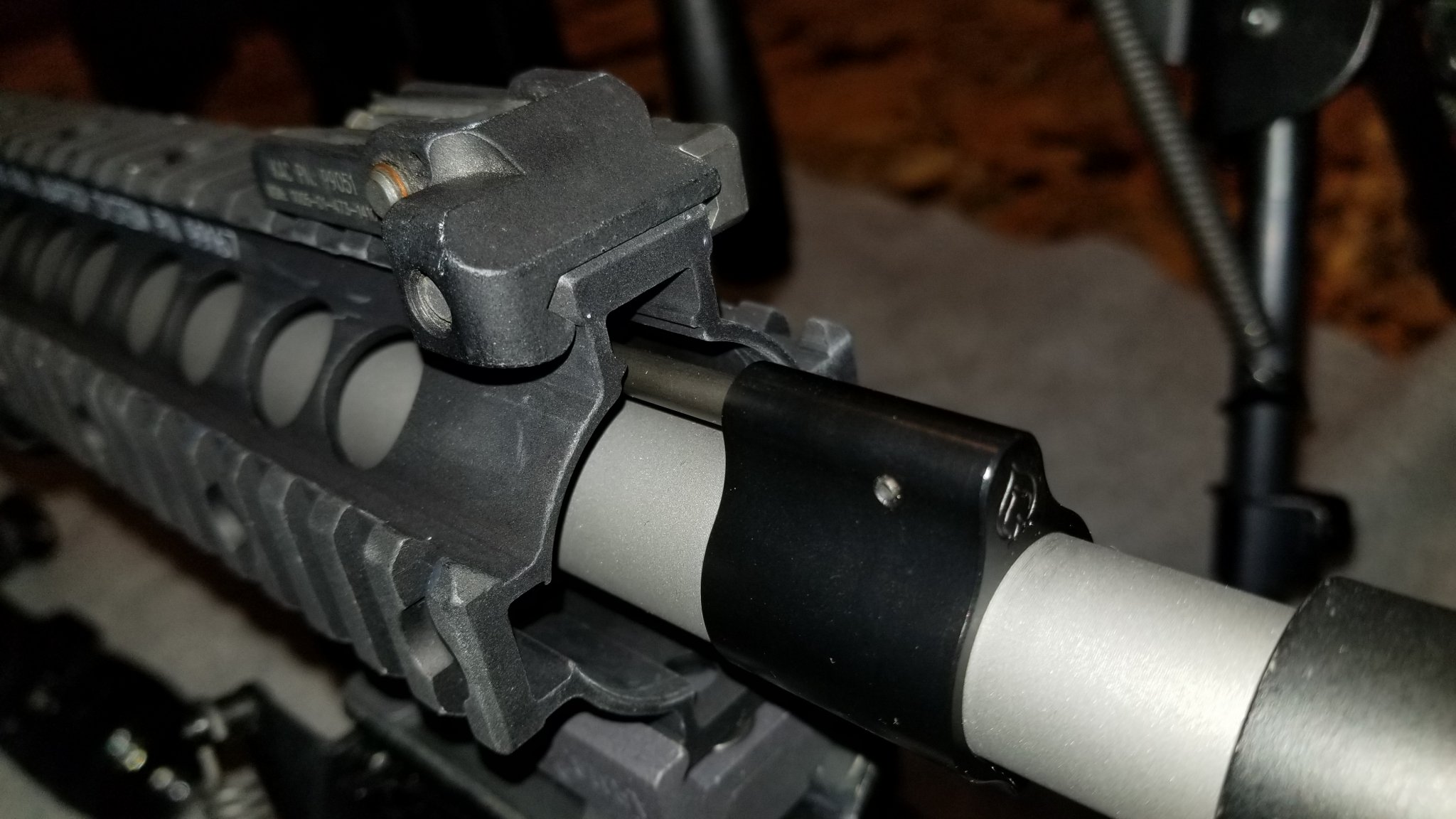

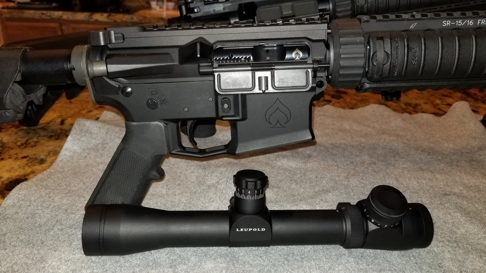

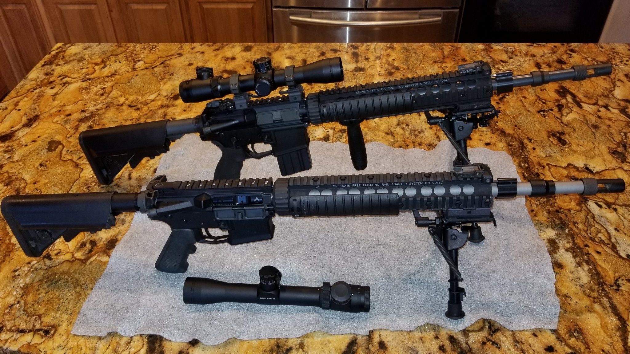

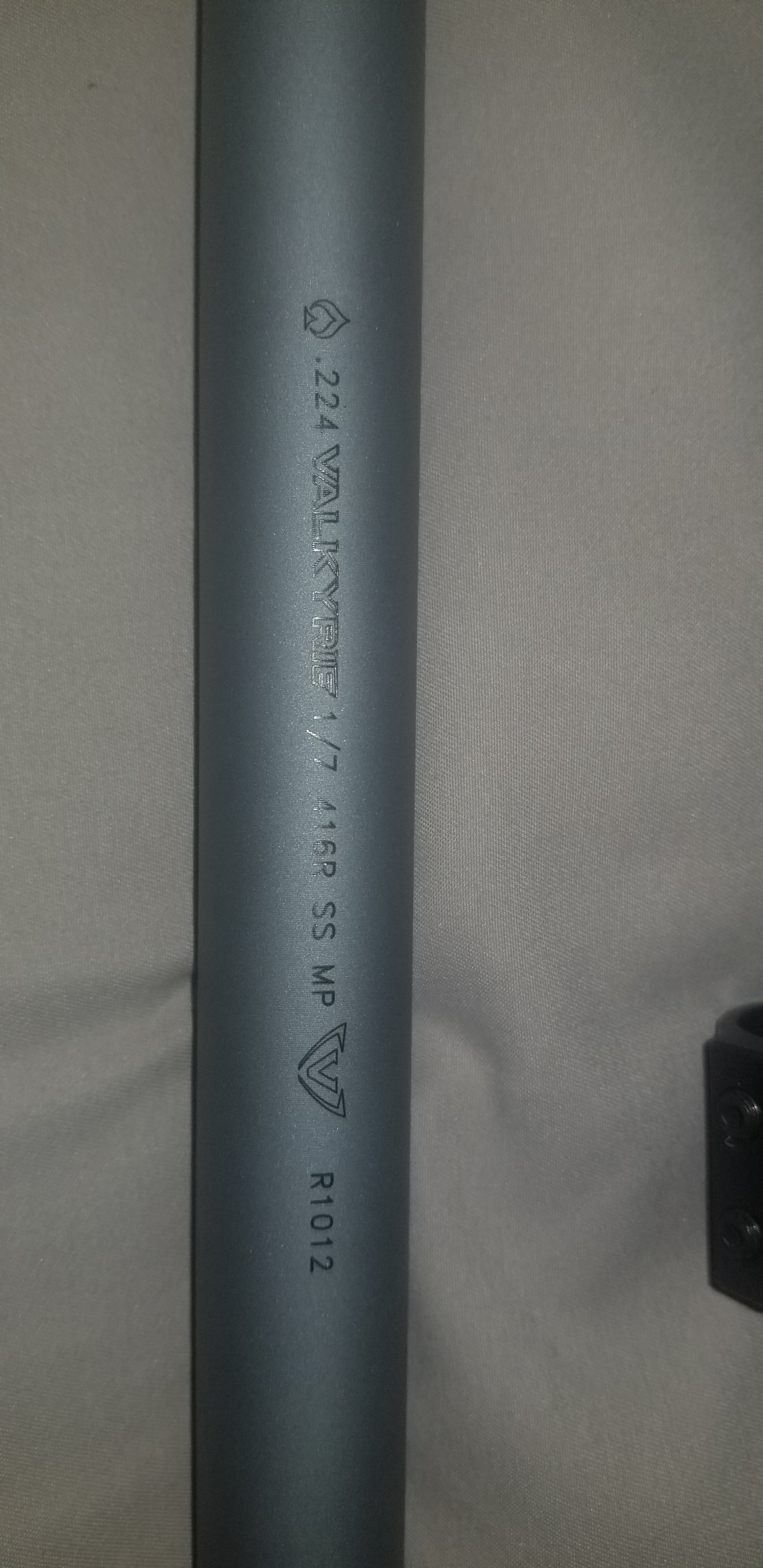

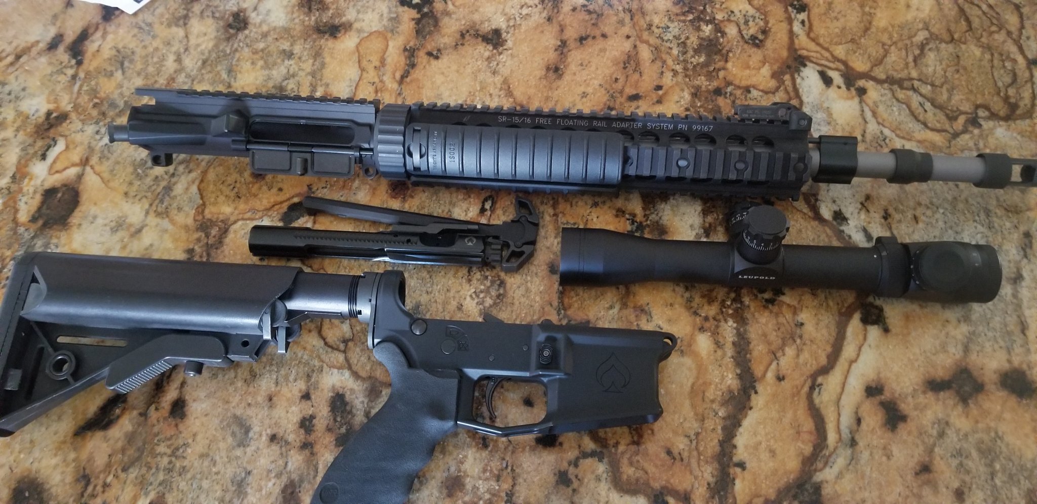

I wouldn't touch a savage my all BA cost
BA receiver set $170
BA Valkyrie BCG $130
BA gas block $30
BA .224 SPR 18" barrel $240
Ergo stainless LPK set $60
Ambi handle $50
Geisselle SSAE $215
KAC MK12 handguard $345
AE brake and collar $125
Tube and heavy buffer and spring kit $75
Sopmod Stock $75
mags $35
KAC sights $200
so I'm $1750 into the build not bad for a MK12 clone let alone in .224 Valkyrie
subtract the KAC sights $200
Larue trigger instead of SSAE $125
CTR stock instead of sopmod $30
BA handguard instead of KAC $120
BA comp instead of AE brake $75
So I could have build it for $1200 less than the savage
Disclaimer I have not made it to the range waiting on ammo will be testing Fed 75 and Hornady 88 we will see if it was worth it, I'm hoping the 18" barrel performs decent. If tit does and all the hype behind this round pans true I will invest in a custom barrel
Long story short dont throw away your money on a savage Valkyrie everything seen is garbage

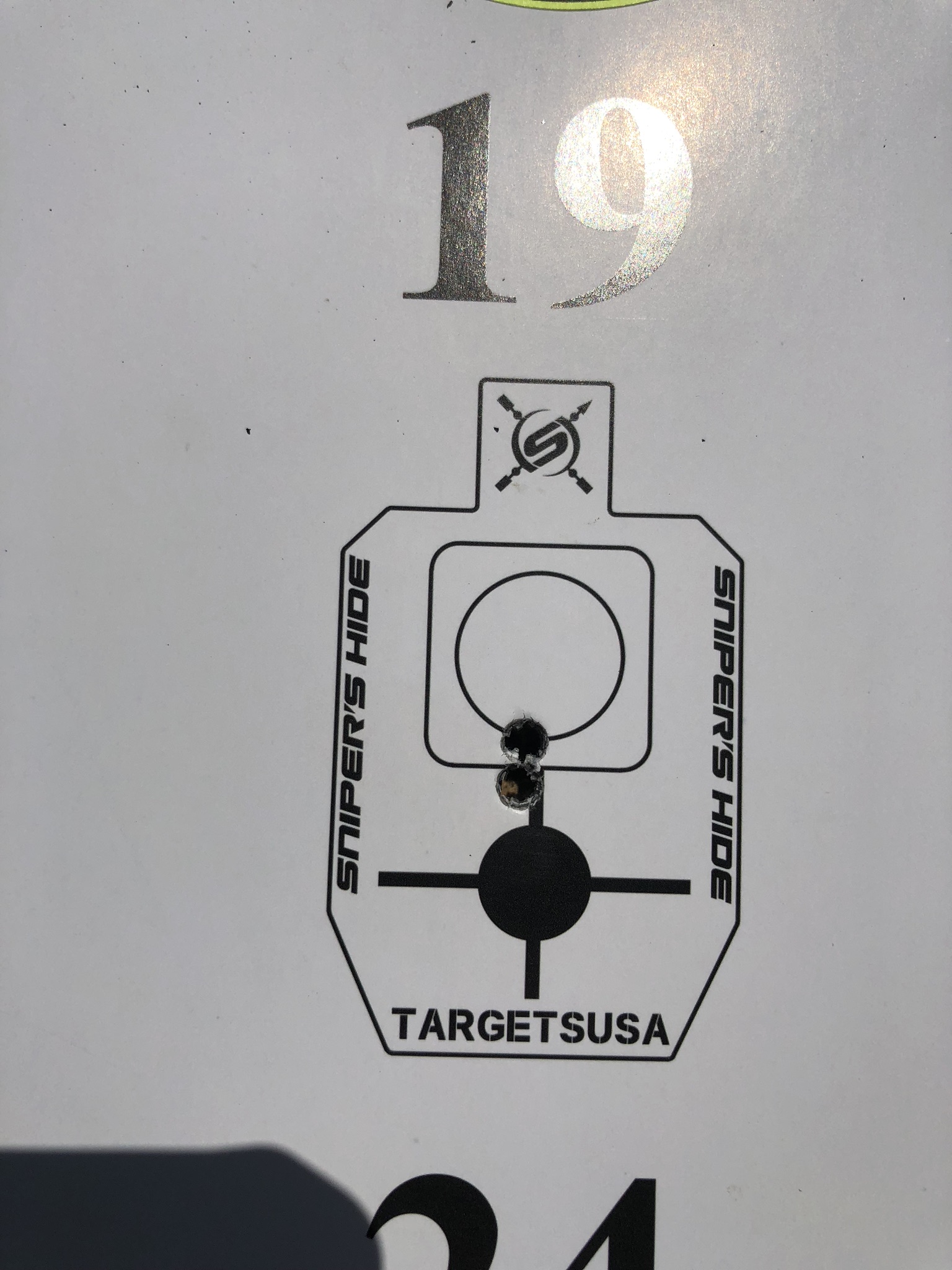

Federal absolutely had issues, that was stated and admitted, 3/4 was often reported and it was not up to par. I even received a call from JP when it was changed as many helped fine tune the load correctly.
That was a 3 Shot group with my Valkyrie up in AK recently, this was factory 75gr Federal, this is what they expected vs something just barely sub moa.
I shot the same JP with 88gr Hornady and first try at a competition came in 12th with very little prep.
This was definitely discussed and remedied with a new load

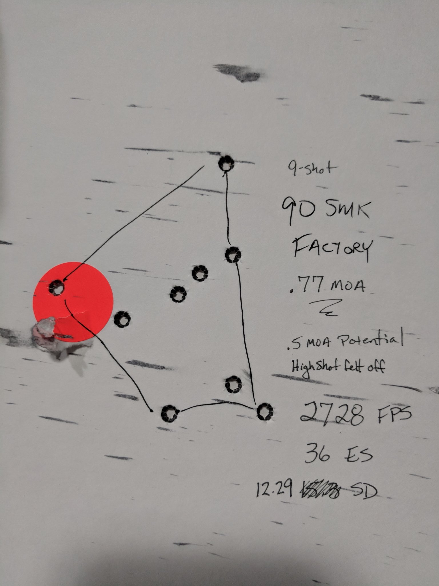

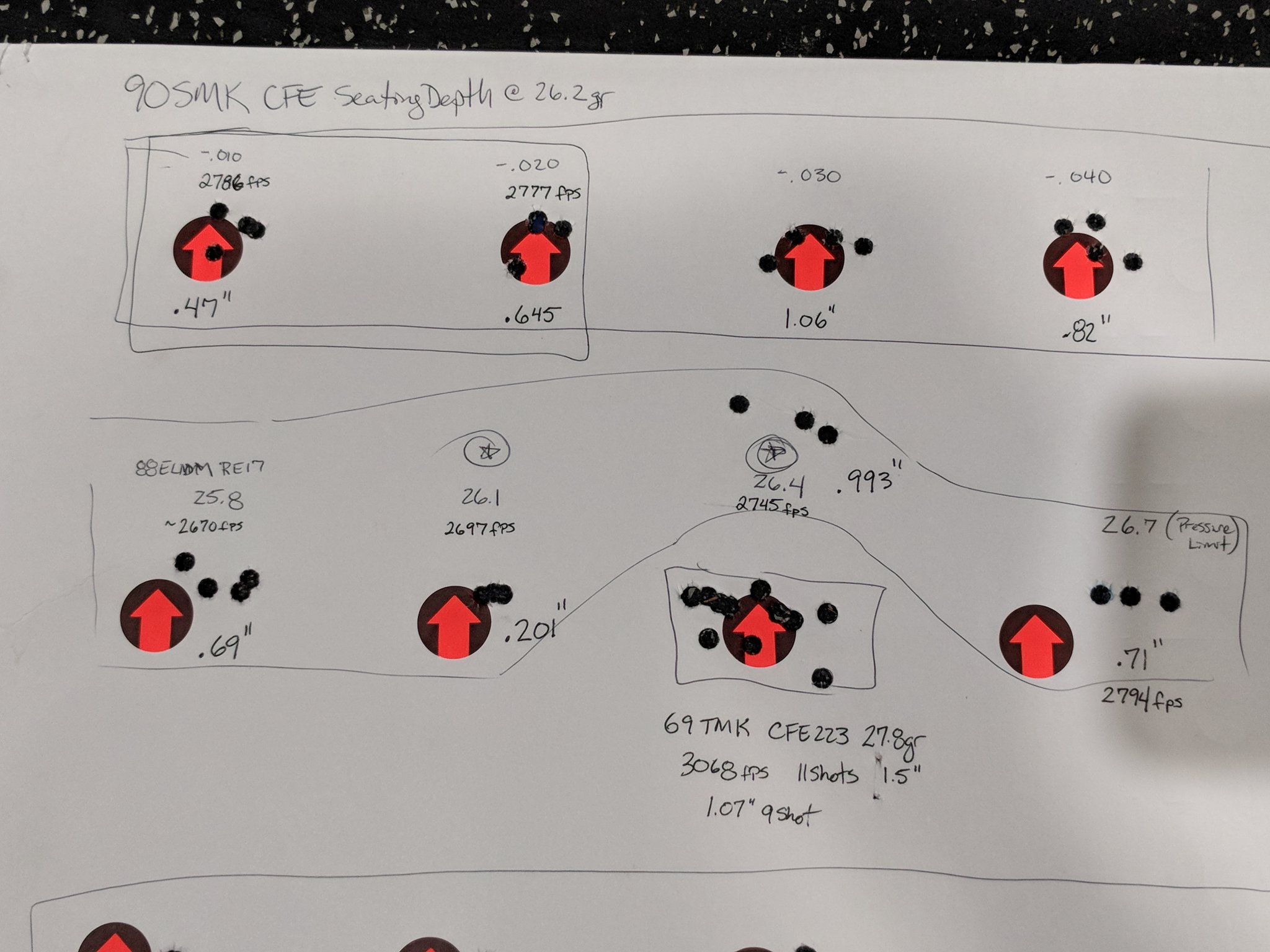

I'm with Lash and Redneck. Here is some load Dev with 90 SMK at 100yds (.75" stickers) and factory ammo at 388yds (1" sticker). Bullet is fine but the load is not right for some rifles. They haven't found that chocolate ice cream load like the 168gr FGMM for the 308Win.
