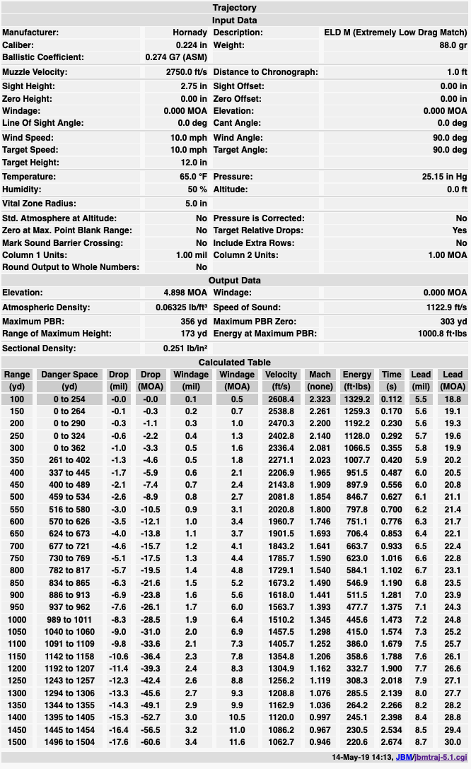

Mine is a 22” Rock Creek 6.7 twist with +2 gas chambered by Craddock Precision. My results on target agree with this trajectory chart.
.224 Hornady 88gr Eldm Factory
G7 BC, 2750 fps
BCBullet
Weight
Muzzle
Velocity
Zero
Range
Sight
Height
LOS
Angle
0.274 G7 88gr27501001.8 in
AltitudePressureTempRH Wind
Velocity
Wind
Angle
35.0 29.95 Hg. 89.0 °F65%0.090°
Zero
Altitude
Zero
Pressure
Zero
Temp
Zero
RH
Max
PBR Zero
0.0 29.95 Hg. 89.0 °F0%291
Bullet Trajectory
Range
(yards)
Drop
(in)
Drop
(mrad)
Wind.
(in)
Wind.
(mrad)
Veloc.
(fps)
Energy
(ft-lbs)
Time
(sec)
0-1.8 0.0 0.0 0.0 2750 1478 0.00
25-0.9 -1.0 0.0 0.0 2710 1435 0.03
50-0.3 -0.2 0.0 0.0 2670 1393 0.06
750.0 0.0 0.0 0.0 2630 1352 0.08
1000.0 0.0 0.0 0.0 2591 1312 0.11
125-0.3 -0.1 0.0 0.0 2552 1273 0.14
150-1.0 -0.2 0.0 0.0 2514 1234 0.17
175-2.0 -0.3 0.0 0.0 2475 1197 0.20
200-3.4 -0.5 0.0 0.0 2437 1161 0.23
223-5.0 -0.6 0.0 0.0 2403 1126 0.26
225-5.1 -0.6 0.0 0.0 2400 1125 0.26
250-7.2 -0.8 0.0 0.0 2362 1090 0.29
275-9.7 -1.0 0.0 0.0 2325 1056 0.33
300-12.6-1.20.0 0.0 2289 1023 0.36
325-15.9 -1.4 0.0 0.0 2253 991 0.39
350-19.7-1.60.0 0.0 2217 960 0.43
375-23.9-1.80.0 0.0 2181 929 0.46
400-28.5 -2.0 0.0 0.0 2146 900 0.49
425-33.6 -2.2 0.0 0.0 2111 871 0.53
450-39.2 -2.4 0.0 0.0 2076 842 0.57
475-45.3 -2.7 0.0 0.0 2042 815 0.60
500-51.9 -2.9 0.0 0.0 2008 788 0.64
525-59.1 -3.1 0.0 0.0 1974 762 0.68
550-66.8 -3.4 0.0 0.0 1941736 0.71
575-75.1 -3.6 0.0 0.0 1908 711 0.75
600-84.0 -3.9 0.0 0.0 1875 687 0.79
625-93.5 -4.2 0.0 0.0 1842 663 0.83
650-103.7 -4.4 0.0 0.0 1810 640 0.87
675-114.5 -4.7 0.0 0.0 1778 617 0.92
700-126.0 -5.0 0.0 0.0 1746 595 0.96
725-138.2 -5.3 0.0 0.0 1714 574 1.00
750-151.2 -5.6 0.0 0.0 1683 553 1.05
775-164.9 -5.9 0.0 0.0 1651 533 1.09
800-179.4 -6.2 0.0 0.0 1621 513 1.14
825-194.8 -6.6 0.0 0.0 1590 494 1.18
850-211.0 -6.9 0.0 0.0 1559 475 1.23
875-228.1 -7.2 0.0 0.0 1529 457 1.28
900-246.1 -7.6 0.0 0.0 1499 439 1.33
925-265.1 -8.0 0.0 0.0 1470 422 1.38
950-285.1 -8.3 0.0 0.0 1441 405 1.43
975-306.2 -8.7 0.0 0.0 1411 389 1.48
1000-328.3 -9.1 0.0 0.0 1383 374 1.54
