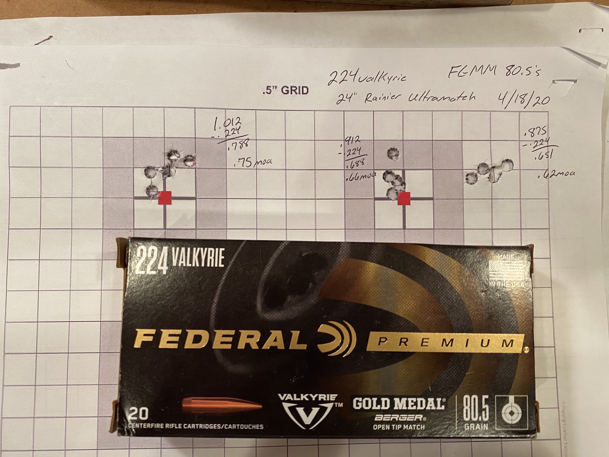

I’ve built 3 to date in AR platforms, one 22” 6.5t WOA and two 24” 1:7.5t Rainier Arms Ultramatch. All 3 have been under sub moa. For loads developed, I had a load figured out or damn close within 50rds or less. The WOA shoots the FGMM 90’s sub moa, as well as my handloads (80 eld’s and 95smk’s). I’ve ran the FGMM 90’s out to 850yds with repeatable hits; haven’t had the chance to go further.
The RA barrels shoot the 80elds, 80.5 and Bergers sub moa. I need to test the Berger 85.5’s a bit more, but the first groups showed a lot of promise. I tried the FGMM 80.5’s yesterday and averaged .67moa across 20 shots. I then went to my club’s 500yd range and rang the 6 or 8” plate consistently, starting off with a first round hit using the velocity listed on the box and stacking the next 4 right on top of it.
For stretching out at 800+, I’d go with the 80elds over the 88/90’s. The BC and added velocity make for it to be a better option in most situations. Higher BC and weight doesn’t always mean the best ballistics.
The 80 eld’s like to be jumped 35 thou.
The 85.5’s like to be 15-30 thou.
The 80.5’s are like the 85.5’s, but seem to jump ok out to 50 thou from what I’ve seen.
Never loaded the 90’s because they just can’t be pushed fast enough to be worthwhile imo.
Brass will be trashed at 1-3loadings depending on how hot you run it.

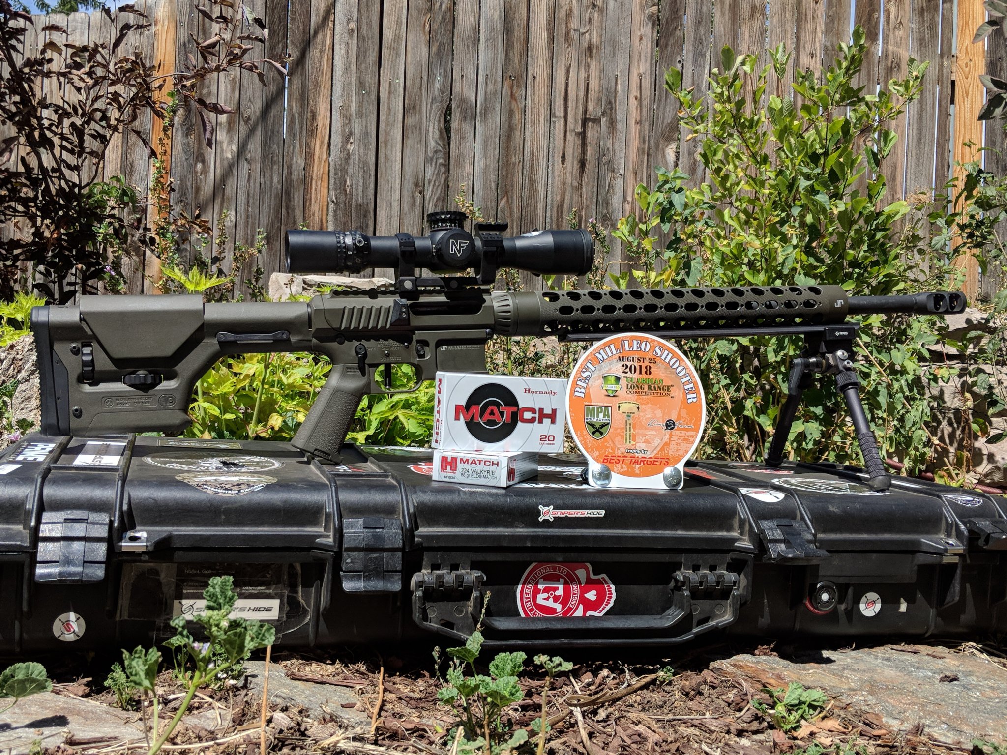

I love it in bolt action and shoot it all the time
The bullet is the same as a 6.5CM to about 500 yards, 600 yards here, and then changes a little bit

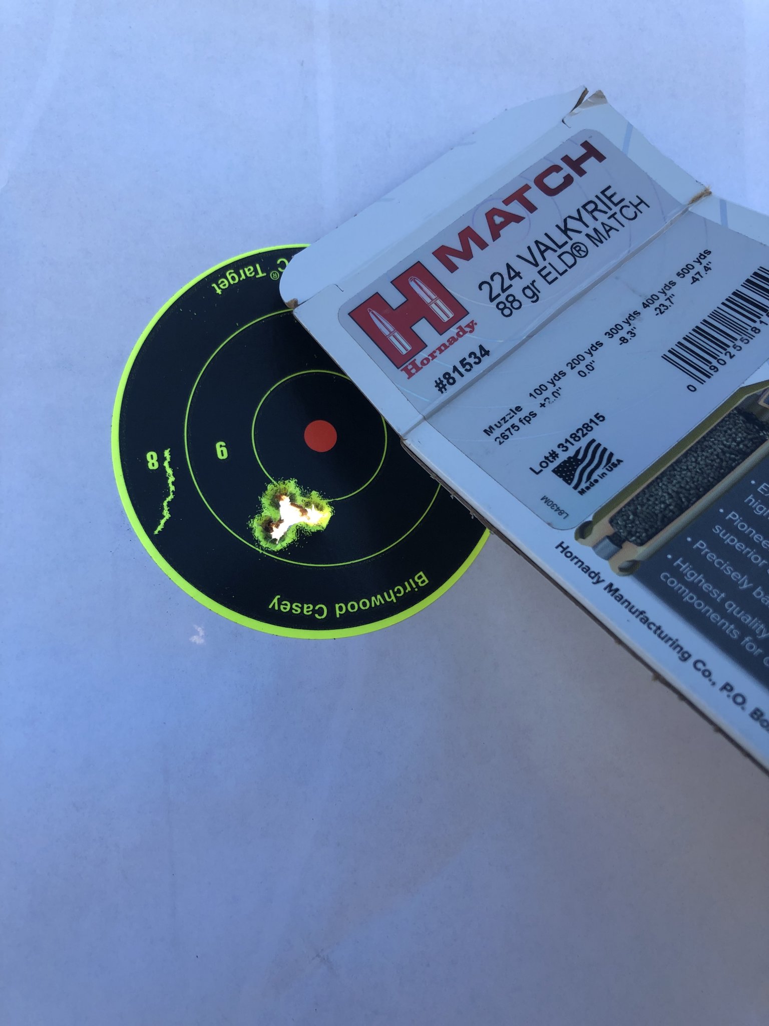

You all just went the wrong direction early on and didn;t listen. Sure the 90gr was an issue, but it works great in the better rifles.
The first week the Hornady 88s came out I top 15th a match with a 224V, and in Oct I shot the Competition Dynamics Team Safari with a 224V and it's clear how easy it was. Top 20 there as a last-minute addition shooting JP 224V.
And I have shot the 224V to beyond 2000 yards with success,
my Valkyries all rock but I paid attention and can actually shoot a semi-auto unlike most others out there, it's a 223AI without effort or work. And nobody out there is saying a 223AI is shit, which is odd
People keep going back to the original problem which has been solved, the 90gr bullet was changed, the reamers were updated if you are smart and there is no drama with a valkyrie
I am using a Gain Twist Barrel and even the old bad 90gr works in my rifles, nothing is shooting 1/2 MOA with either of my rigs
If you can't a Valkyrie to work it is you.
They work great
If you don’t like it don’t buy one, pretty fuckin simple solution.
My Q Mini Fix shoots .75” MOA or better with factory Hornady match 88s and around that with Hornady factory 60 VMAX. I can consistently kill ground squirrels at 300 yds. Ammo is relatively cheap. My wife and son enjoy ringing steel at distance.
Can other calibers do the same things? Sure. But I find the 224V more versatile than most 22 calibers

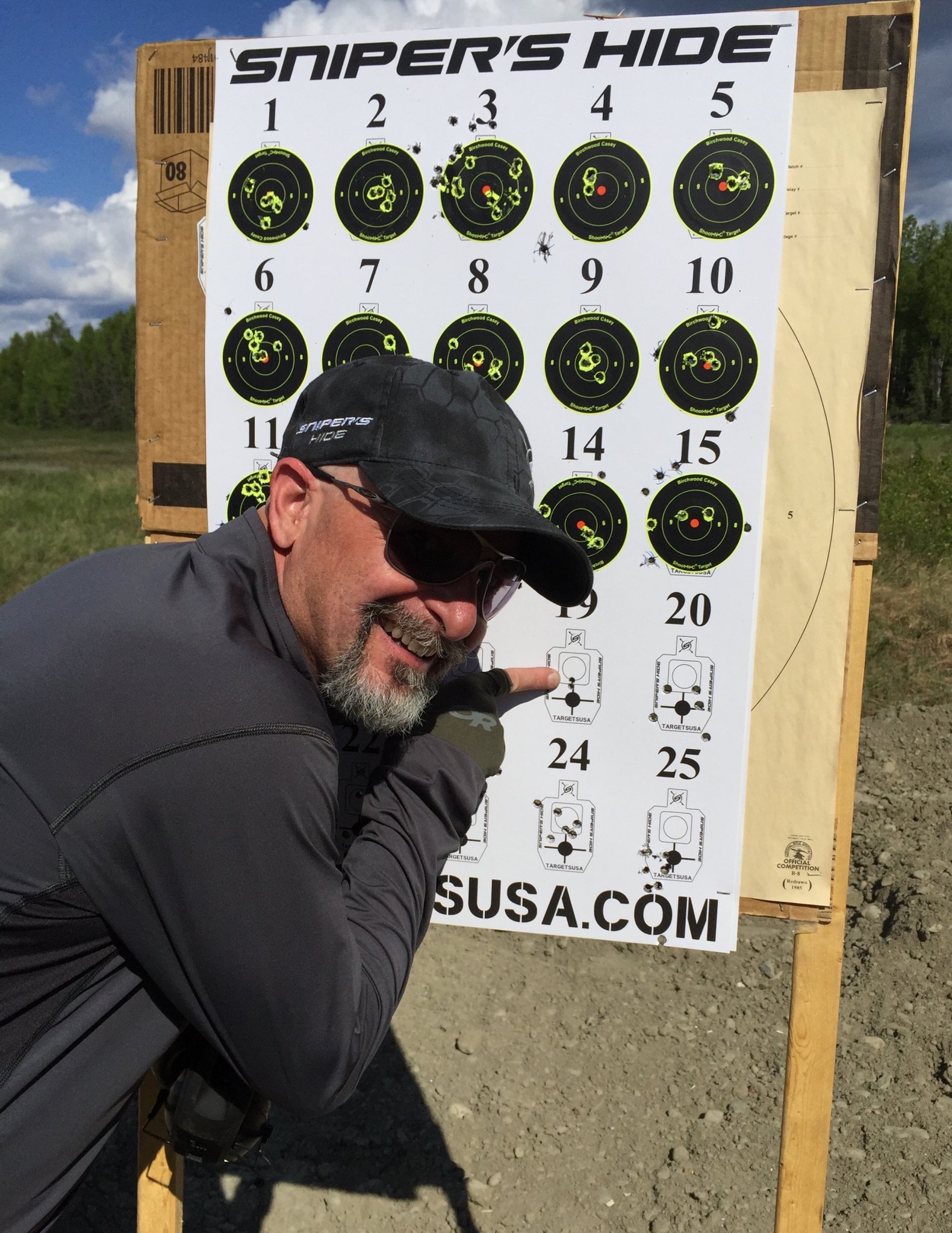

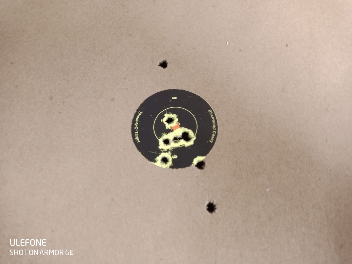

I went to AK with my JP 224V and had them grab me 75gr American Eagle at $8 a box in Alaska
I went the range to zero it and was like WTF because there was only one hole in the paper, so I moved my POA up a tick to see if it changed, well yes,
This is 3 shots, not 2, made me laugh at all the complainers
Pretty funny the factory guns that people jumped on early was a Savage and it didn't work, well you bought a Savage before they figured out their stuff was wrong

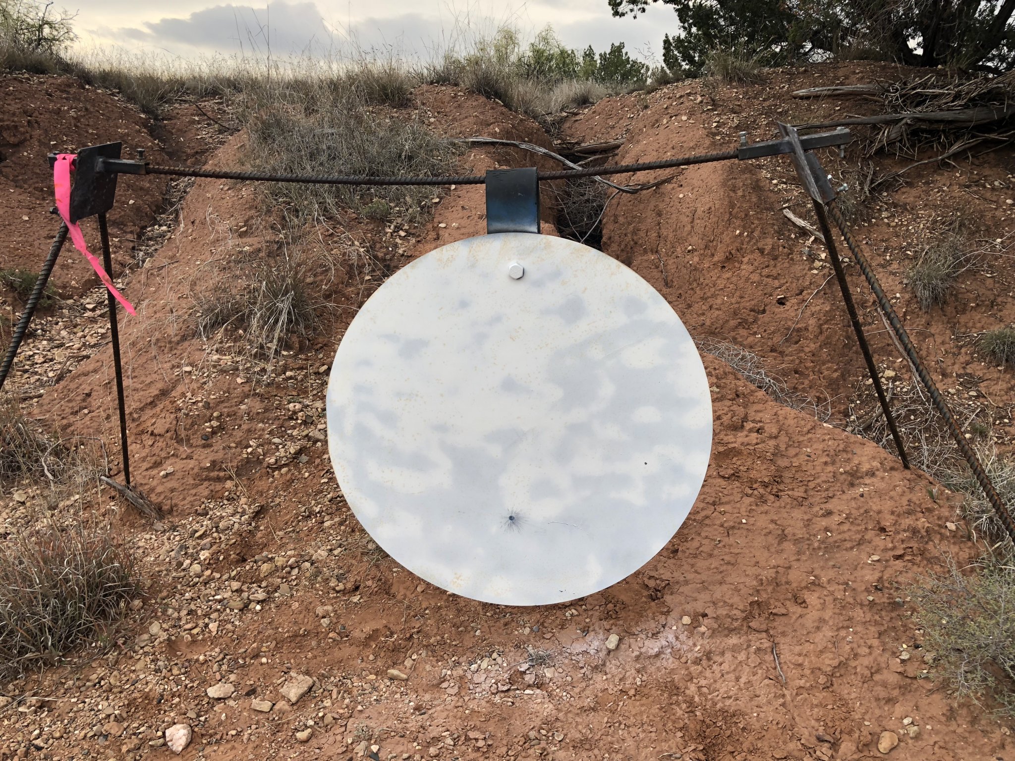

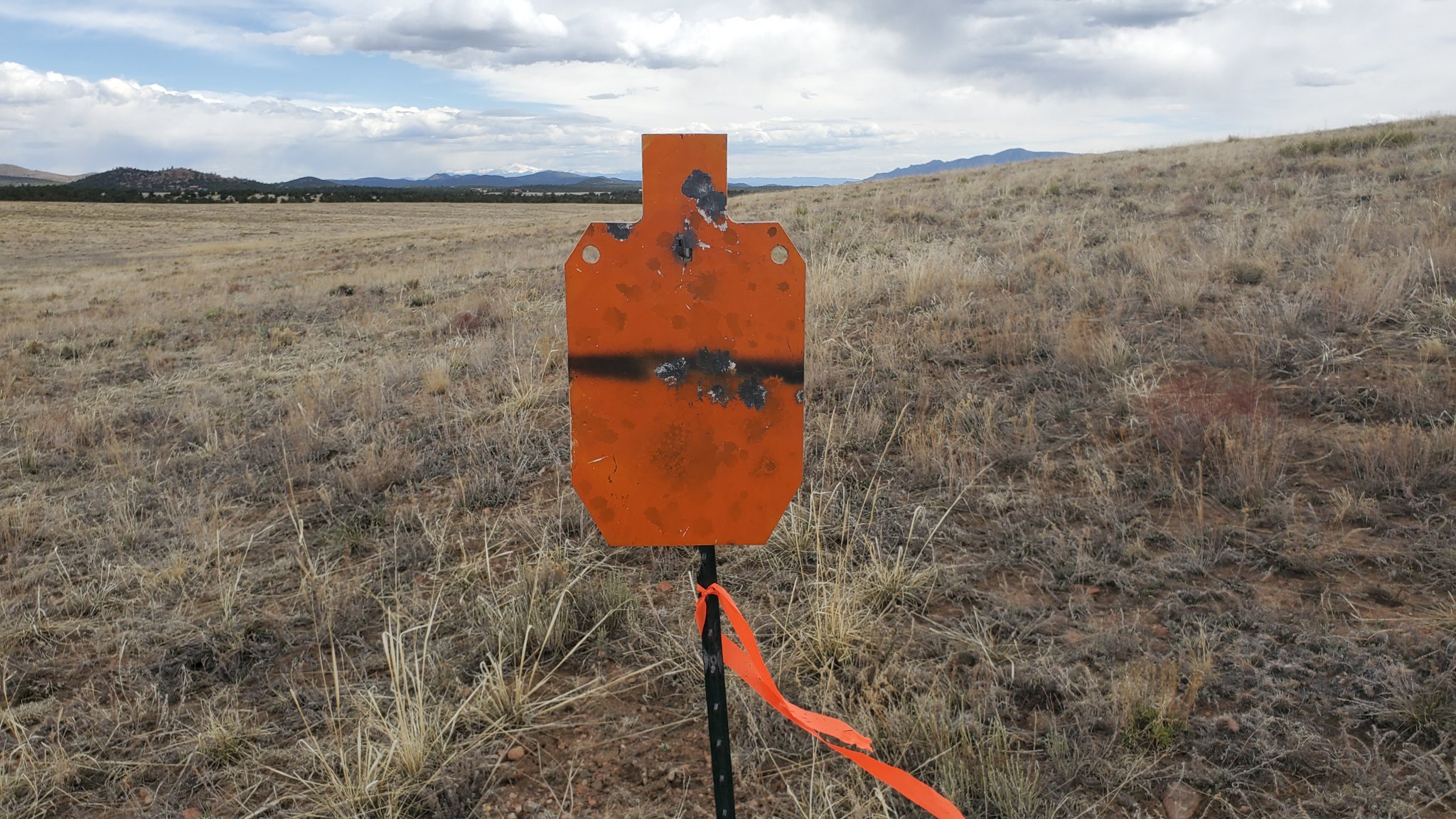

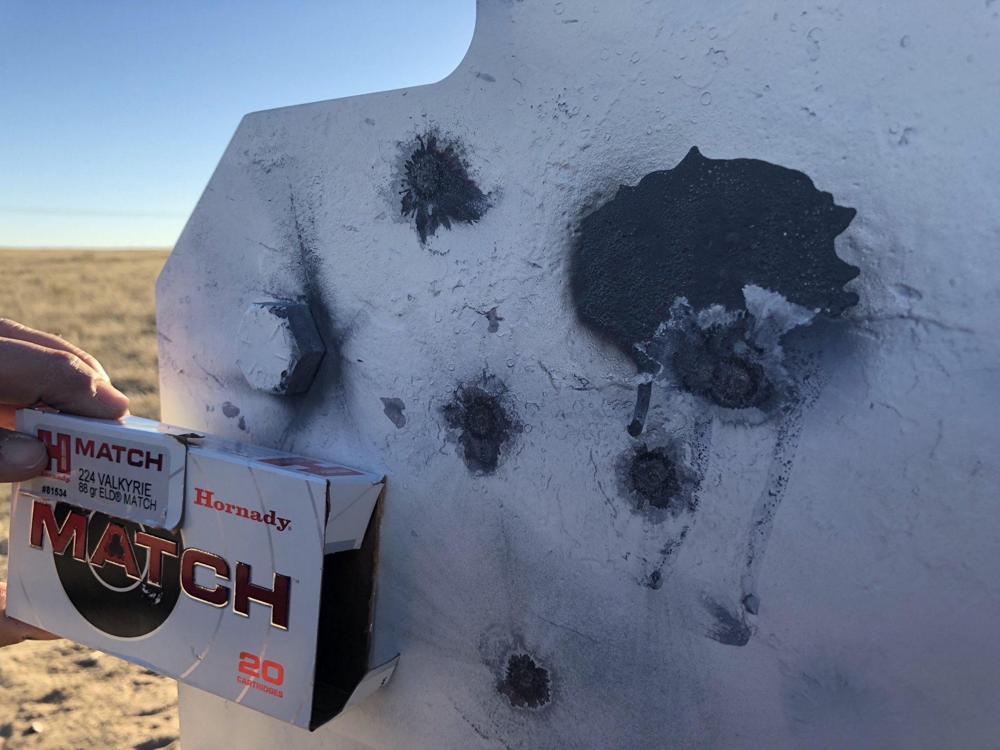

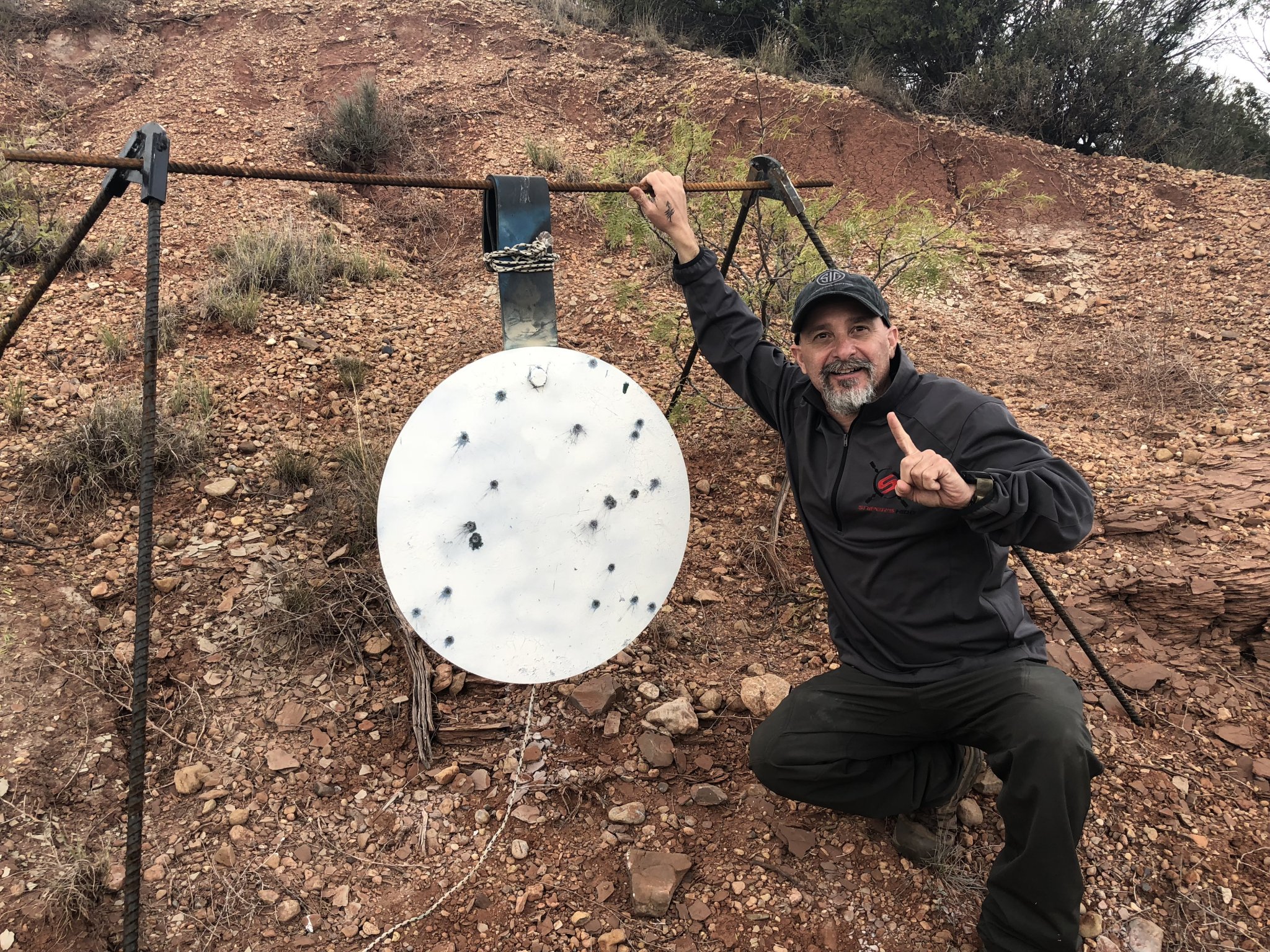

I see hits no problem,
I had the Army guys at my Range for the Gathering last year 2nd round impact on demand in front of a crowd
Again this goes back to competence, a 224V is not a 223, it's different requires a different approach
I posted the videos you can see them clearly
All Valkyrie Hits
One Mile
2000 yards

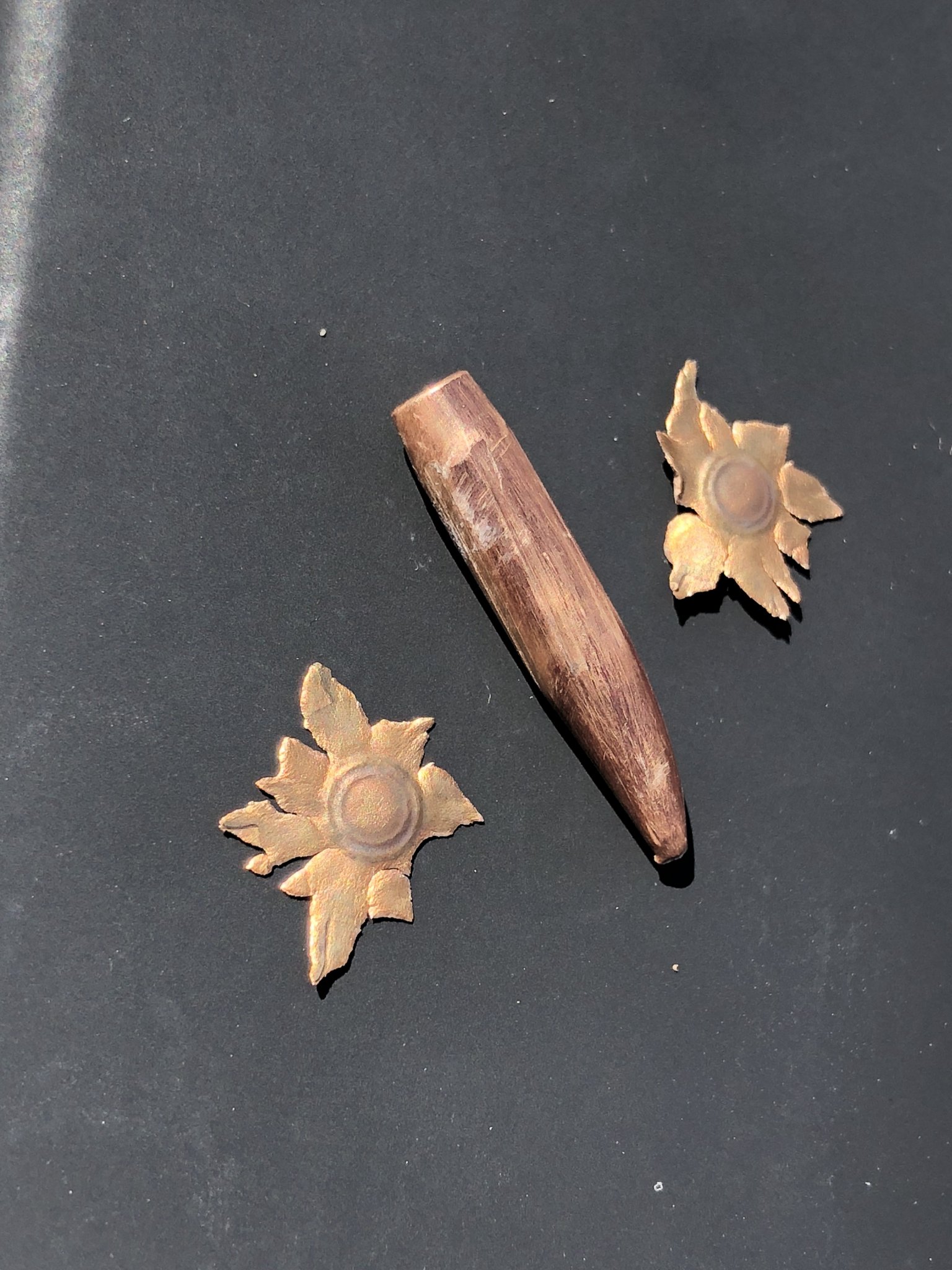

Recovered Bullets
Seeing and spotting

Just finished up my 80gr load for my origin w/26" 1/7 twist.
This group was 1.25" tall @ 500 yards and wind was 6-10 mph.
I have no doubt this load is going to do great at 1k.
This was just playing around shooting fast.
