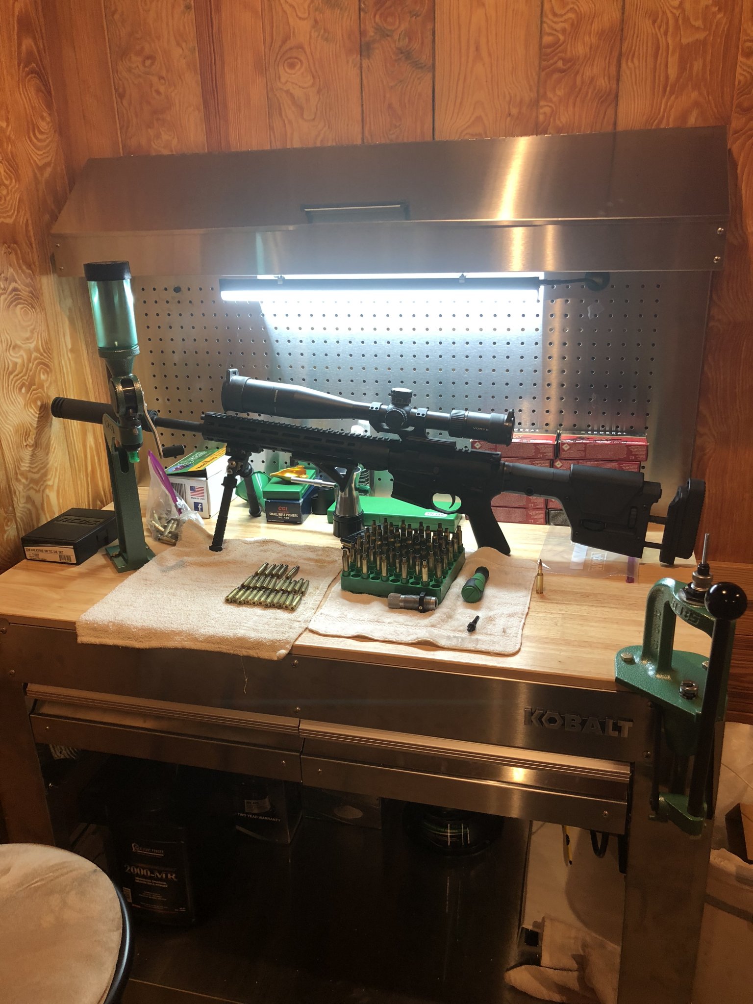

    Ran a few strings of test loads through the rifle late this evening after the weather cleared up a bit. Overall was pretty pleased with the results, other than the fact that I should have been a bit more thorough when going through the brass. Had some slight issues with some full length resized brass from the first batch of Federal ammo that I got that was showing signs of being overpressured, and had some brass that had some bent rims that were just barely noticeable. The next test loads I work up I will be much more stringent with brass selection, but some very light filing allowed me to get these rounds to chamber properly.
    Running a 18" Savage 5R barrel, with a Silencerco Omega
    90 grain Sierra MatchKings, Alliant Power Pro 2000-MR
    Sizing and Seating RCBS AR series Full Length Die Set
    I ran a comparison with some Factory Federal Ammo to have an accurate atmospheric comparison (Altitude 154 ft., BP 29.701, 66.4 degrees, 96% humidity)
    Federal GMM 90 g SMK's ran 2585 fps, with an SD of 7.1
    String 1- 26.2 grains, 2597 fps, with a SD of 40.4 (thinking that was on me)
    String 2- 26.8 grains, 2650 fps, with a SD of 17.5 (ehh, probably still getting in the groove, but better)
    String 3- 27.1 grains, 2676 fps, with a SD of 1.4 (finally found my groove haha)
    Alliant lists a max charge of 27.1 grains for the 90 SMK, but I saw no signs of pressure on any of the rounds I fired with these loads, and at 27.1 grains there is a considerable about on room south of the shoulder to bump that up a bit. Going to work some larger samples up for the next test at 1/10th increments from 26.9-27.1 and see how that goes, overall accuracy was pretty good other than the last group that I basically shot in the dark.

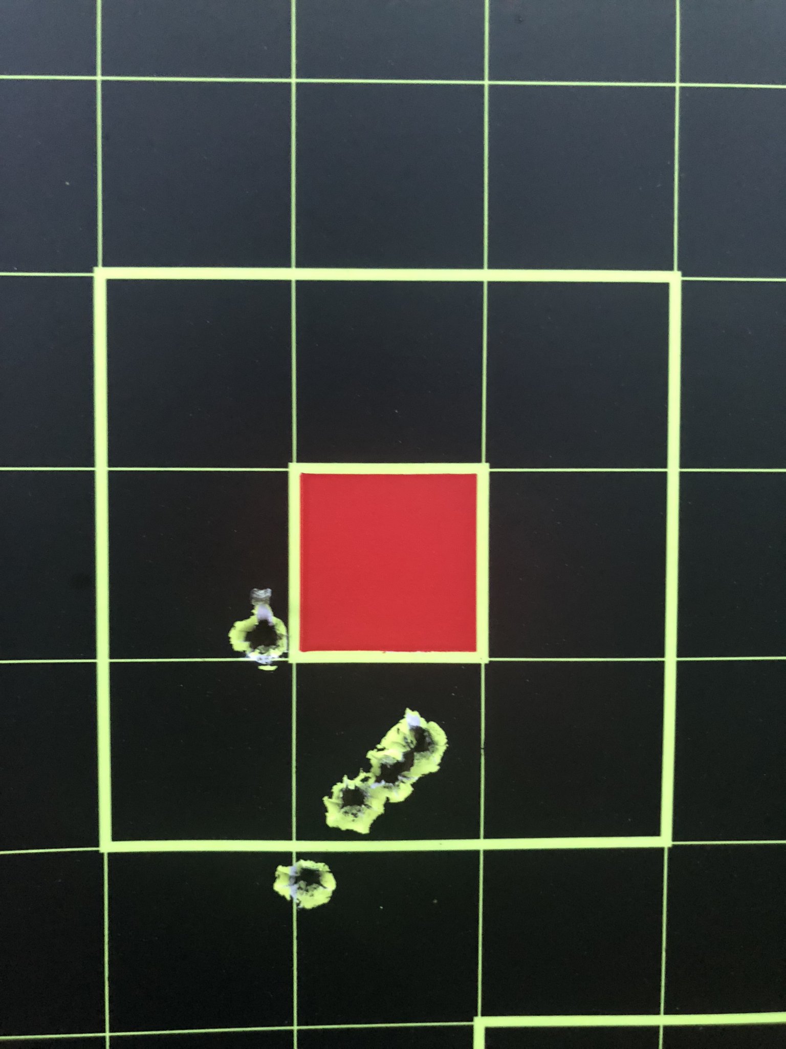

    This was 26.8 grains,100 yards, and the flyer was definitely me...

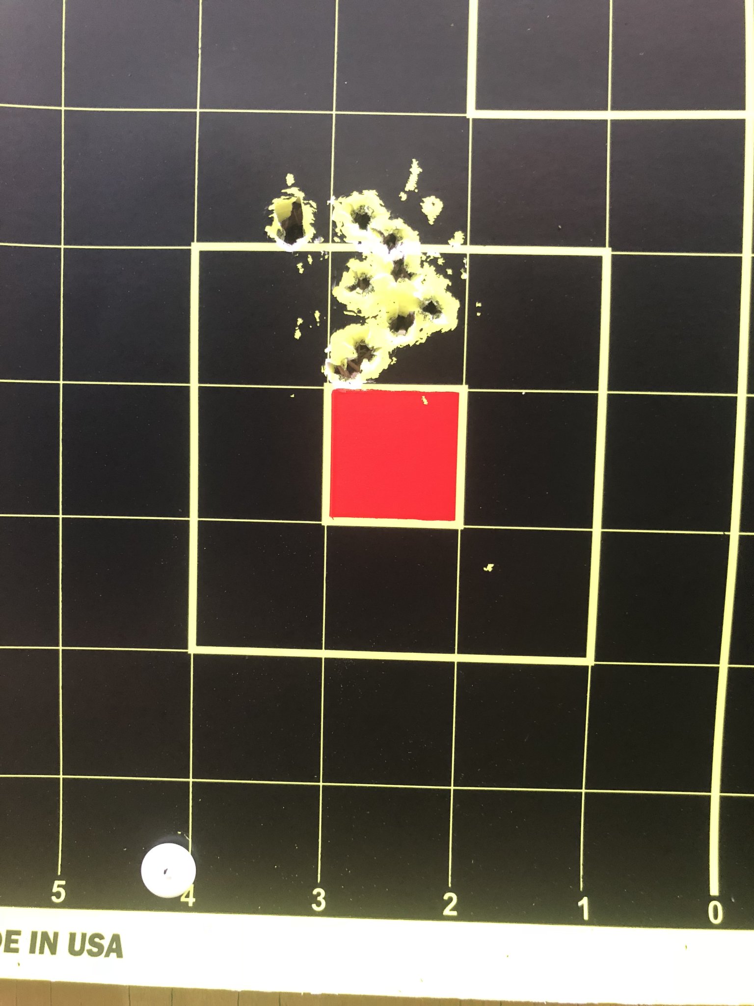

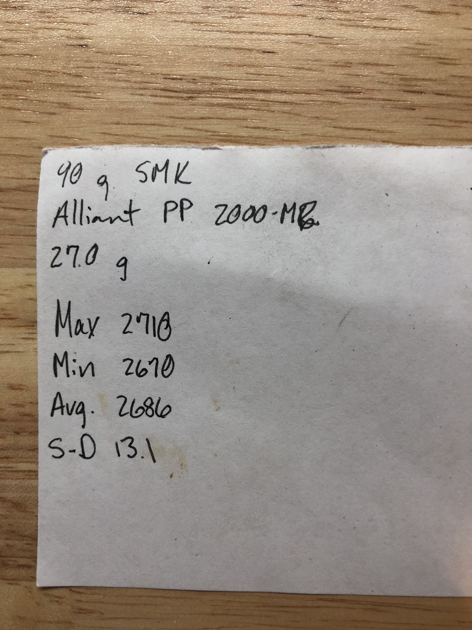

    So far so good with the 2000-MR and the 90 grain SMK’s, still having a heck of a time with some of the brass with the slight bends in rims with the factory brass, but after hours with a fine tooth comb and some file time had some better tests the yesterday and the day before....this is the best group so far @100 yards
    5 shot string
    9 shot @100 y w/27.0g of 2000-MR
    I’m planning on seeing how much room I have to play with seating depth to see if I can get rid of the slight ejector marks, how do you guys deal with slightly bent rims?
    5 shot string
    I'm an Ar10 guy and I always went with an adjustable gas block to fix it.

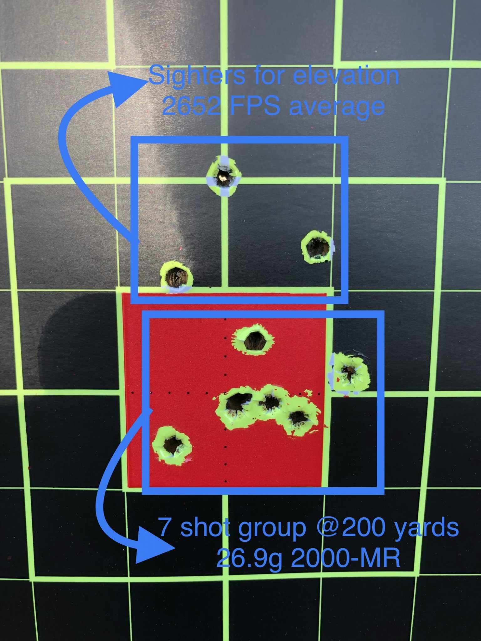

    I’m running an adjustable gas block 1/2 turn up from not locking back on the last round, also running an H2 buffer, the first case of ammo I got from Federal was overpressured and that is what I’m reloading now, just curious about what everyone does to straighten it out, or whether you toss it?

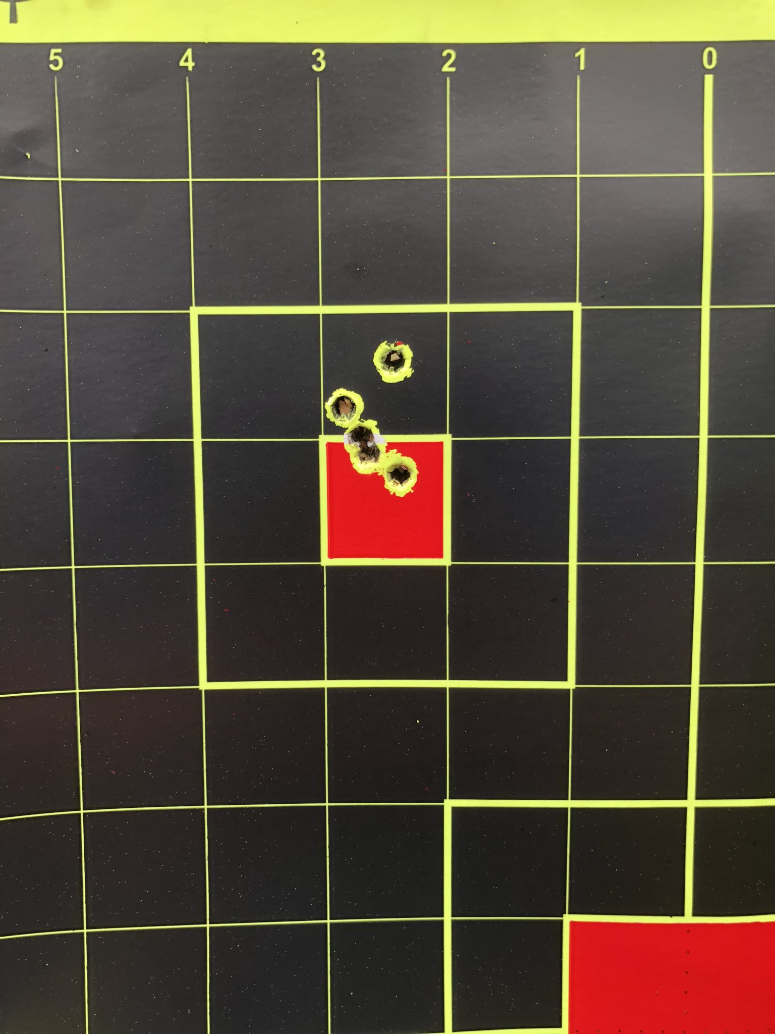

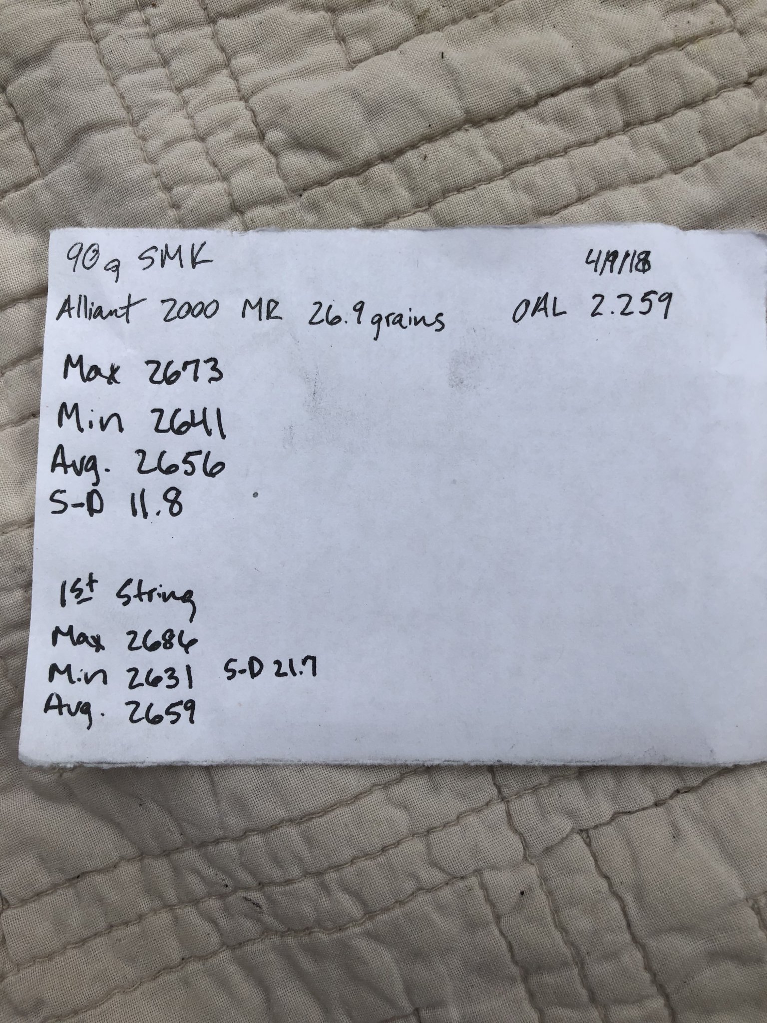

    26.9 g 2000-MR with the 90's seems to be the sweet spot for me so far
    zeroed scope for elevation with the first three shots and then a 7 shot group @200 yards, wind was gusting from 5-17 mph right to left, hold was left edge of 2"x2" bullseye
