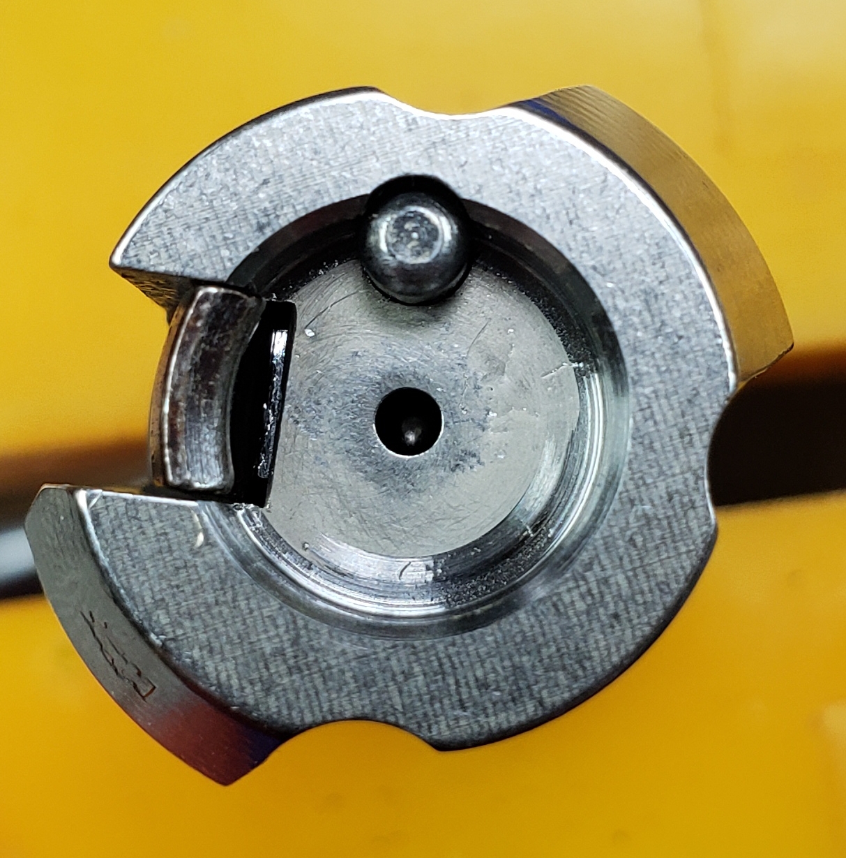

On a side note, does anyone here have a Howa 223 short action that can post closeup pictures of bolt face? Ideally, next to a Howa 308 bolt face.
I'm trying to where the extractor sits relative to bolt body. Mark from SAC is willing to try opening up a Howa 223 to 6.8SPC but im curious if it would require adding metal to build out the extractor cross pin or if they simply use a thicker extractor body (compared to 308).
This would make the switch pretty easy. Much like opening up the Tika.
