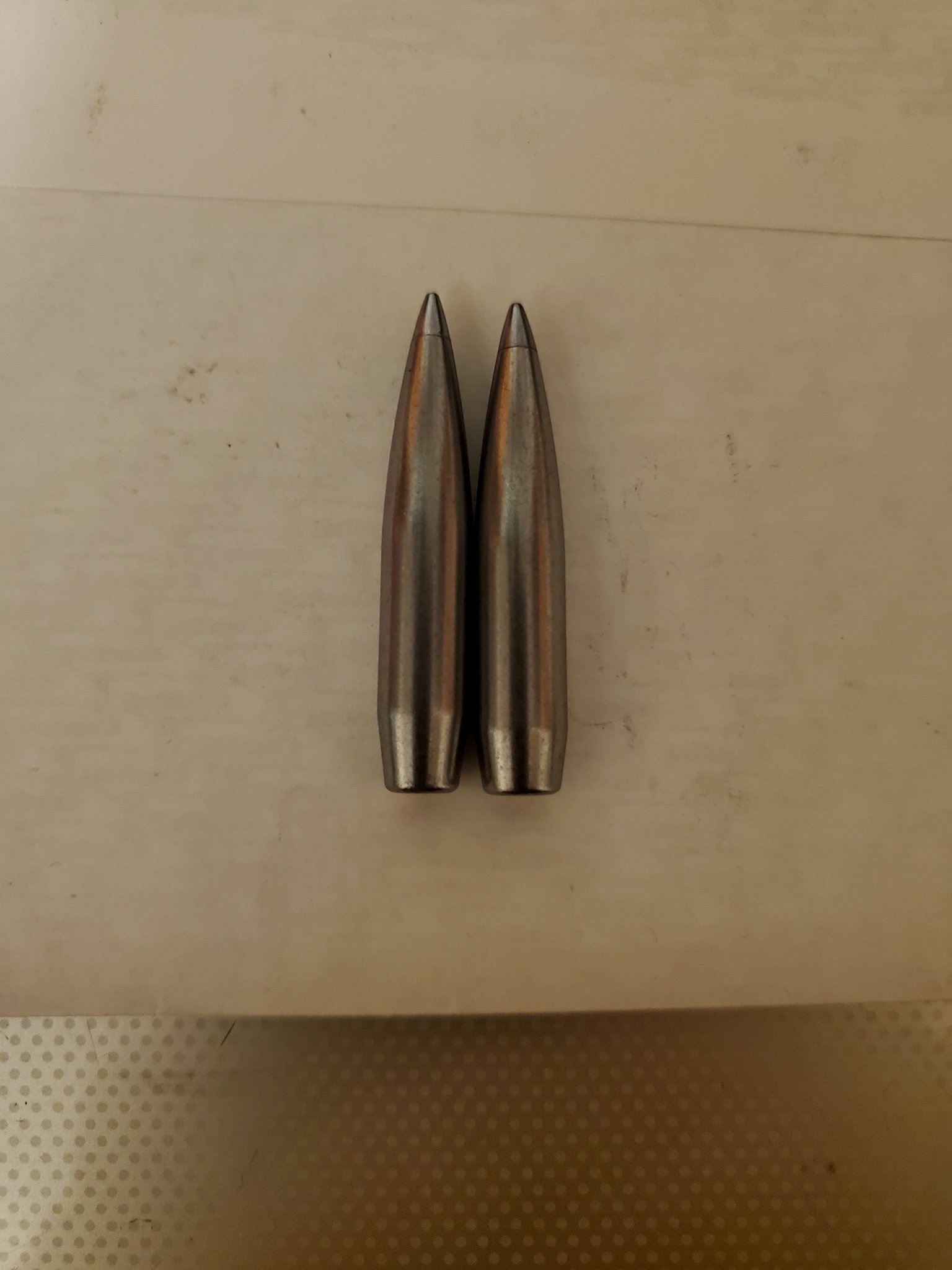

    Just opened a new lot of 225's & found that the boat tail is longer with a different angle. They're also .030" longer & average 225.5gr as weighed by my FX120i.
    Check this out.
    Did a quick test @ 1440yds & the new ones consistently hit .2-.3 mil higher all else being equal. Im going to test again & check mv too. I like better performance but wasn't expecting the change.

    What lot # had you been working off of? I have some for load development, but would rather not waste time working them up just to have to start over because they were redesigned. Thanks.
    Old lot #2170498 have almost 1600 of these & another lot down the tube. They were the same.
    New changed lot #2181102 just opened the 1st box of a 1000 pack & noticed the difference.

    Called Hornady this morning & talked to someone about it. He confirmed that they did redesign the bullet. They didn't let anyone know & the guy didn't even know until he looked at the data. So now I have to rechec all my data, & my load. Let's just say that I'm not happy about it. I also asked about a new BC but he said that it didn't change. I call BS on that.
    I shot 6/ea of each & clearly had 2 groups. It could be the longer bullet is faster so I'll have to check that next week to be sure.

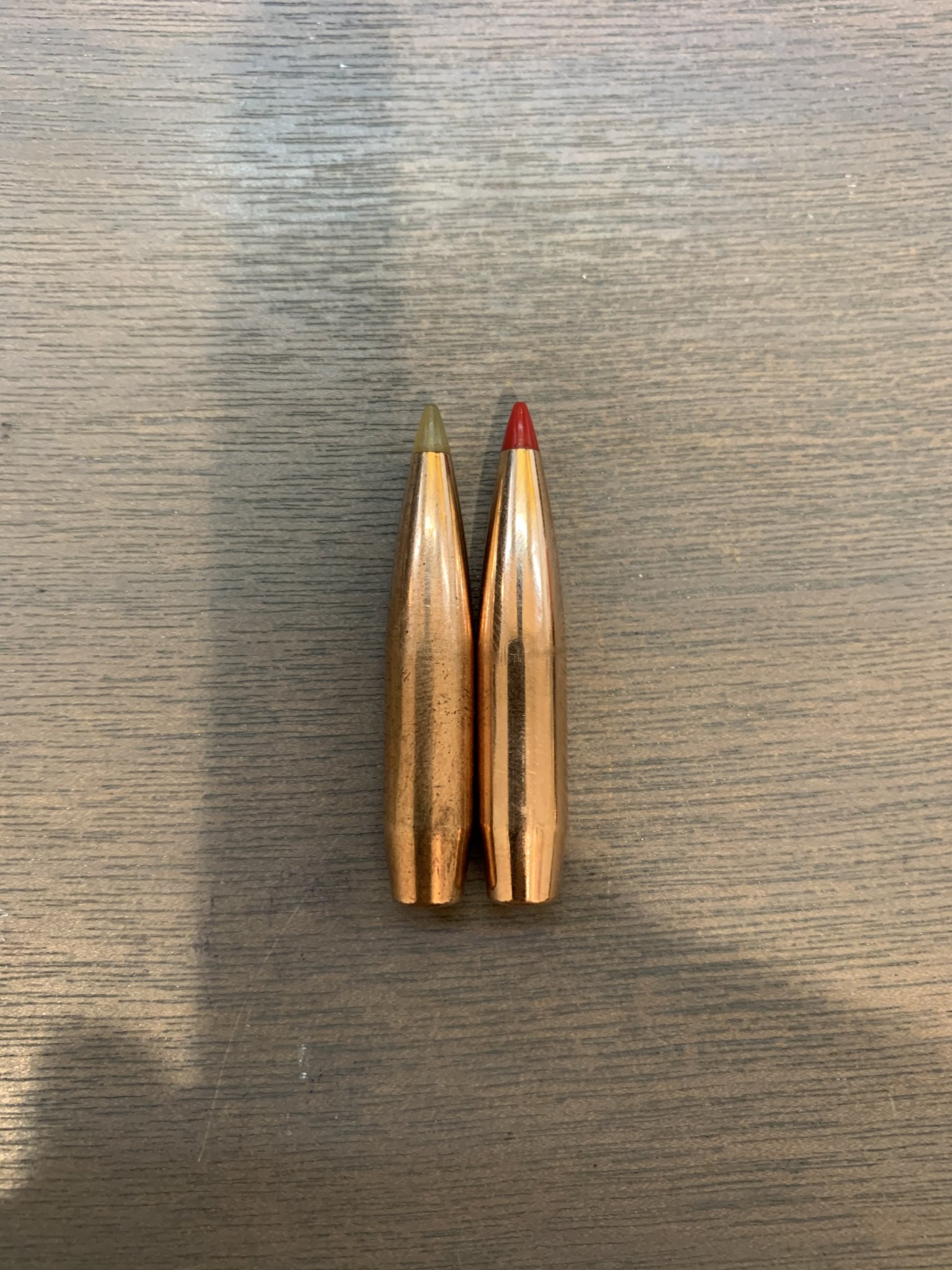

    I noticed this a year ago and asked hornady about it. They indicated the design was changed to improve transonic performance. Additionally they changed tip material for what I believe were proprietary issues with the original material. Bottom line is dont purchase any lots of these bullets that don't start with at least 218xxxx. Fortunately, I only purchased 100 bullets of the old design. They also updated the ballistic info for these projectiles in their 4DoF calculator a while back and I suspect this is due to the design change.

    About a year ago Midway had what appeared to be some pre-production 225 ELD blems on sale. The newer batches (218xxxx) appear to use this new design. I’ve had good luck with the newer 225’s out to 2200yds.

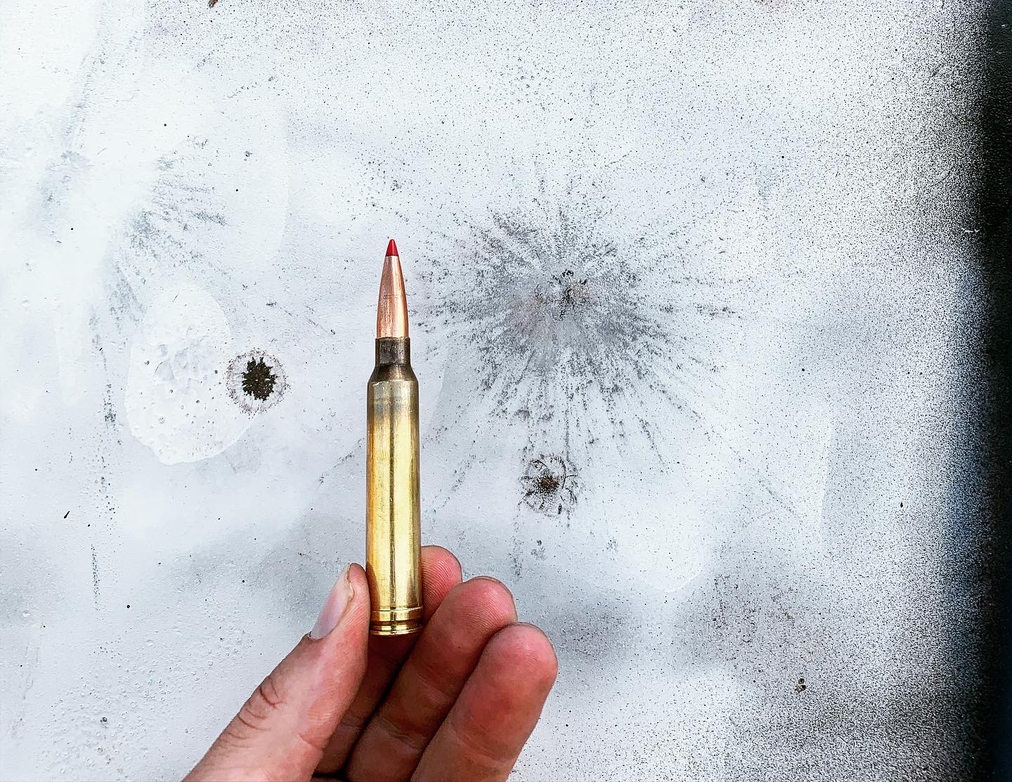

    Shot the new 225 ELD’s this weekend at Spearpoint. Connected at 2903yds. Ended up with a Hornady 4Dof of 1.9 and a banded G7 in StrelokPro of:
    .380 @ 2512fps
    .375 @ 2233fps
    .356 @ 1954fps
    Very consistent bullet in the transonic, goes right where you tell it!

    Thats good to know. I don't know why but so far I've never seen a splash from the old ones past 2000yds. Could be mountain winds but IDK. Didn't have the problem with the 230 burgers out to 2300+/- but these? Nada. Going to drop off the action for the new barrel tomorrow & will start all over again with the LHGT 9.5-8.75 in a couple weeks. :cool:
