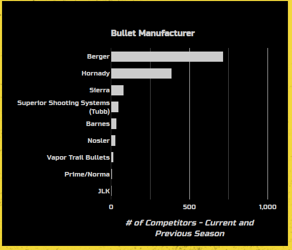

6mm Dasher, BR, BRX, Creedmoor, BRA, whatever. Cast a wide net: Bergers are what win.
Reactions: Birddog6424
The best shooters don't just consistently shoot 6mmBR-based cartridges. They consistently shoot 105 Hybrids.
When discussing the 6 Dasher vs 22 Anything, you're comparing what is probably the finest mass-produced precision bullet ever to roll off an assembly line to an average match bullet. 88s are fine, but they're not great. 90SMKs are awesome, but they're several steps behind a 105 Hybrid. Even the 85.5 leaves something on the table.

Cast the wide net and see what turns up as the consistently winningest bullet in this sport. If you haven't tried a 105 Hybrid, you should give them a try. They're outstanding.
