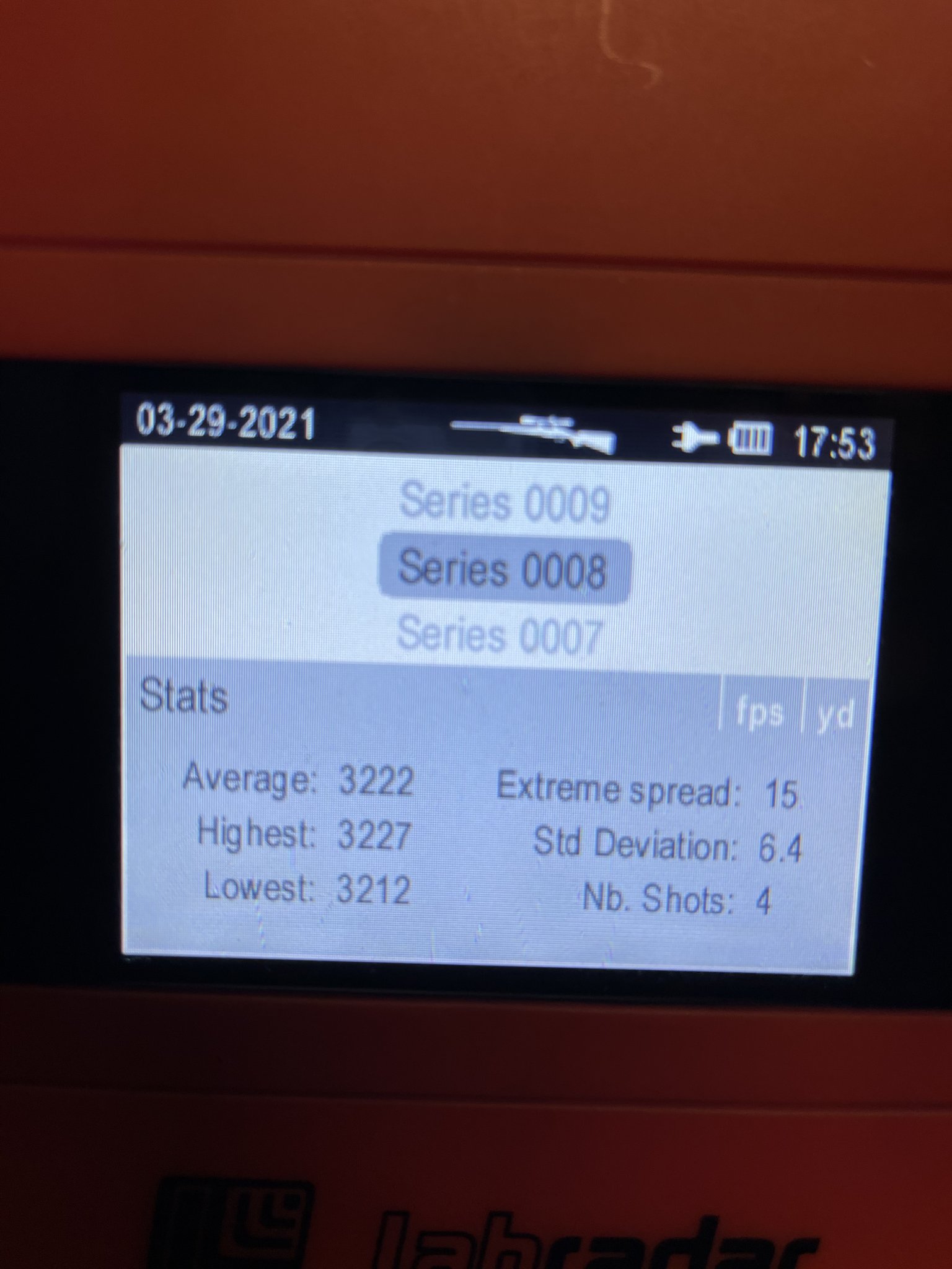

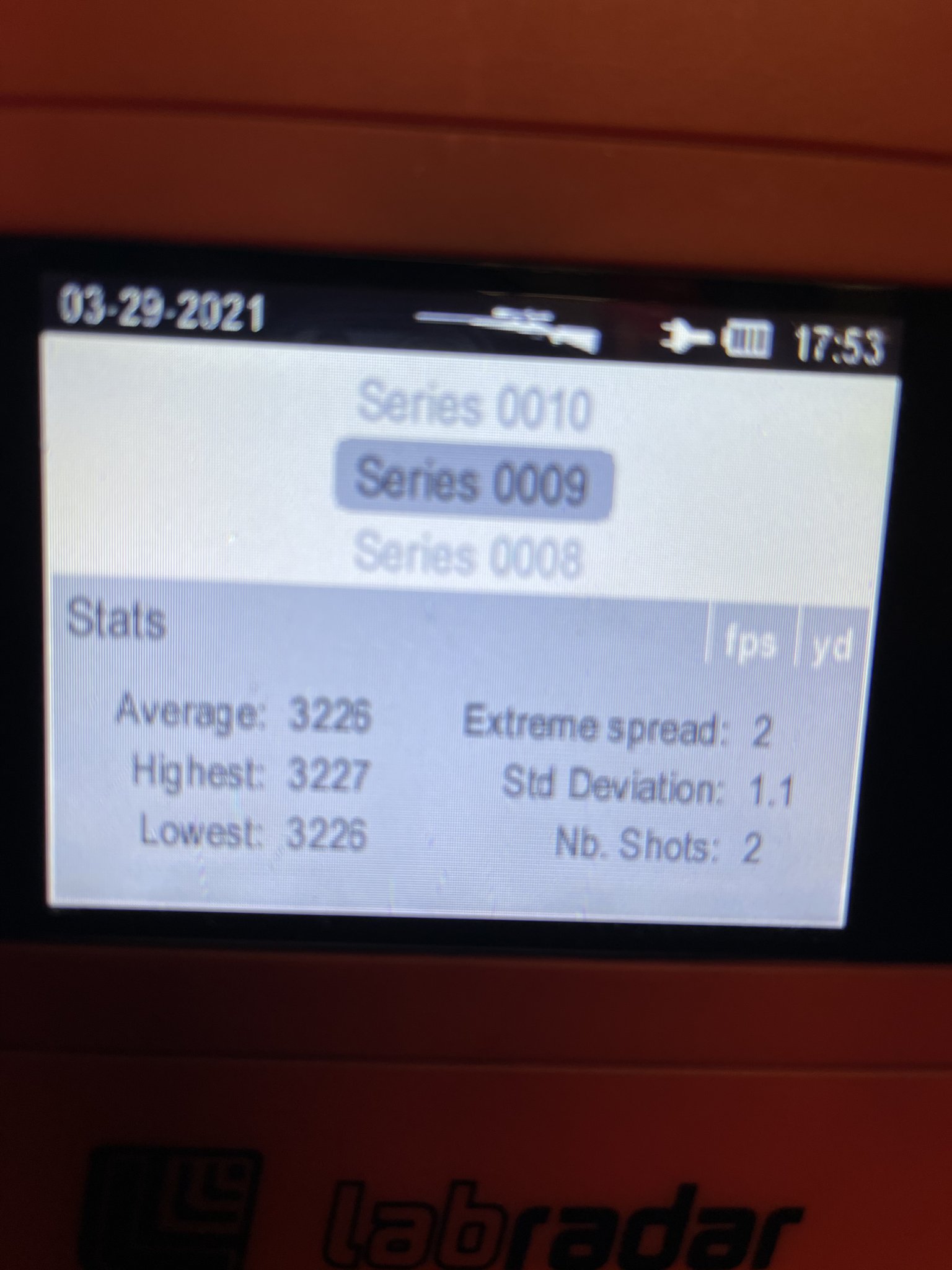

    So I have slowly worked up from 33gr of h4350 and ended up at 37.8gr of h4350. No signs of pressure. Running 3220+ with 37.5-37.8gr with the 95gr SMK’s.
    Going to play around in the 37.5-37.8gr range and see what I can find for a flat spot and hope for the best. 122 rounds down the barrel. Don’t think it’s sped up yet. Going to find out eventually though lol

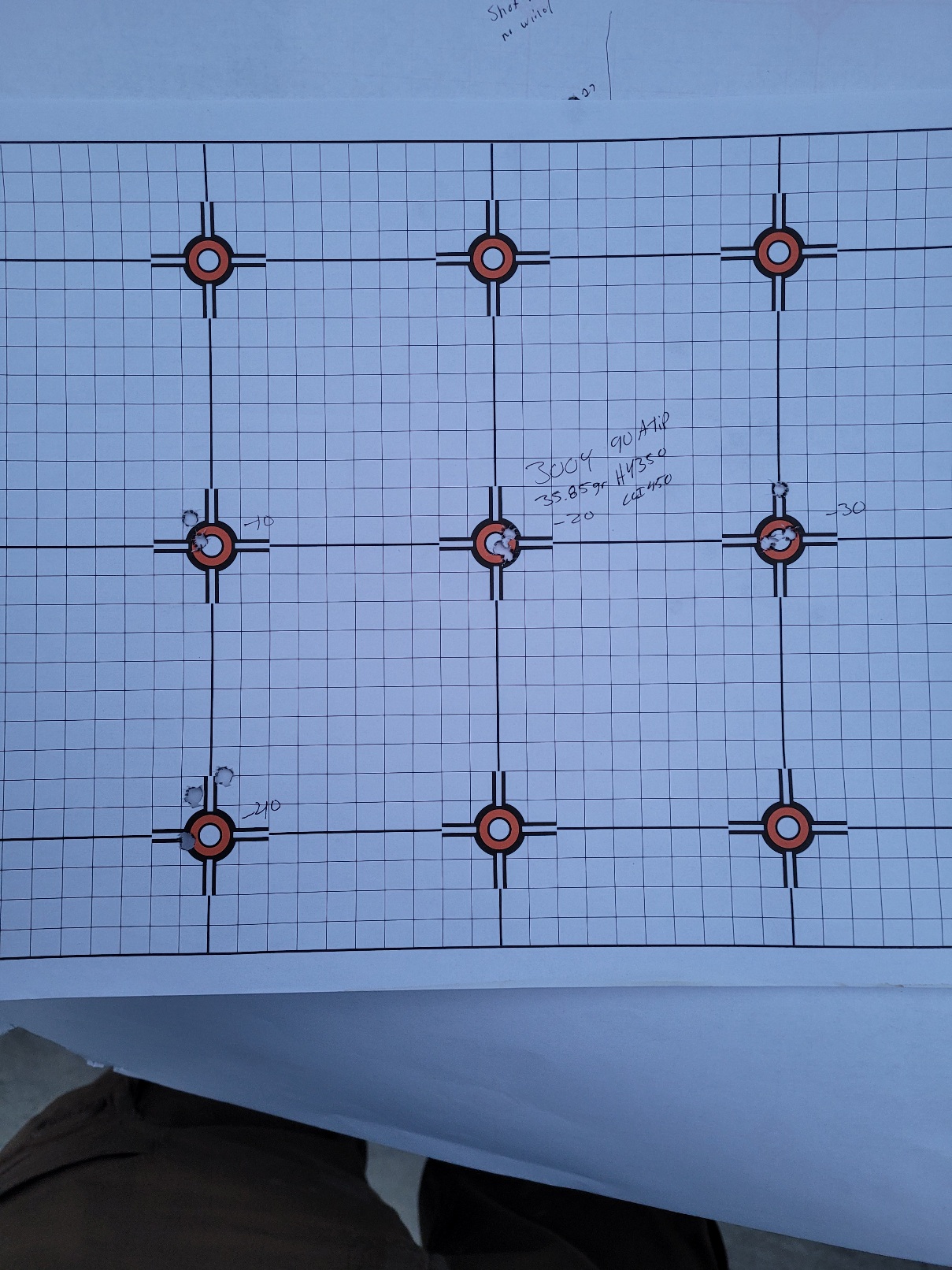

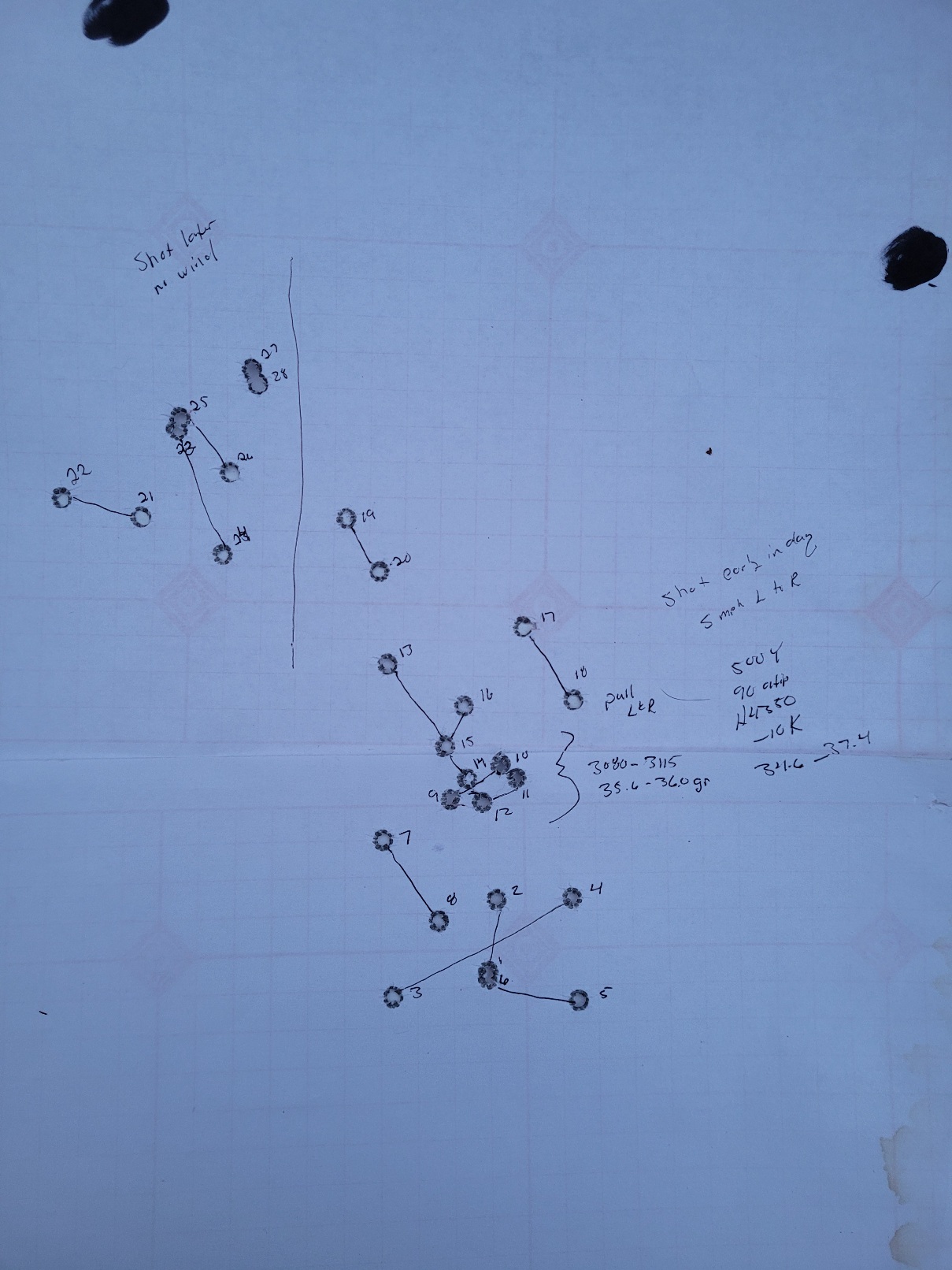

    Figired id post up a thread pertaining to my 22gt experience. Rifles an origin with a 26" 7tw 219 bore hawkhill hvy varm cut to Alpha reamer spec by Manzella Precision.
    90 atips 2.575 oal, -10k cci450 H4350
    34.6 3008,004
    1 34.8 020,022
    2 35.0 018,025
    5 35.2 046,051
    7 35.4 062,067
    9 35.6 084,082
    11 35.8 3101,098
    13 36.0 120,113
    15 36.2 117,135
    17 36.4 141,137
    19 36.6 158,164
    Shot later in day, same target no wind
    21 36.8 xxx,175
    23 37.0 196,195
    25 37.2 205,212
    27 37.4 235,236
    No bolt lift found, very light crating on primer and shadow of ejector ejector slot. This is first firing so maybe the ejector would not be there on formed brass. Growing 003-004 first firing.
    There was an obvious node from 3082-3115 so I loaded 35.8gr and shot groups at -10 -20 -30 -40, everything was well under half moa at 300y with -20 being best. Loaded 100 rounds, shot 5 rounds at 1060y and the g7 310bc at 3100fps trued up for very good waterline. Shot my match tied for 3rd place with a new barrel new scope new chassis, whole system ran flawless. I had 4 rounds left after the match and ran them on chrono ans velocity had upped to 3150s. So I'm now at 240 rounds on barrel and it should be all sped up. Pics below are laddee and seating depth test. I shot 100 rounds of 88eldm seated -25k over 34.5gr H4350, these went 2950 first, and were sped up to 3000 by last of the 100. These grouped very well, sub moa 15 shot groups! All in all this has been stupid easy to shoot well.
    Looks good man!
    Its shooting good. 1k yards in cold conditions last weekend was 5.9mil. Wind drift was minimal, most the day was a 5-10mph @ 8 o'clock. I was only leaving plate with wind holds on targets past 600y. I was very impressed. You get a hot 6cm ballistic from 6br recoil. This things like a cheater round. Gaming at its finest!
