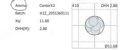

I typically go for CX, and have a case that was recently tested at the Lapua center, but I've had a few lots of CX that shot horrific in my gun as well. I will look at CX, SKLR, mostly but have also had good luck with SK Red, Eley Match Black, and Tenex. I try to go through a minimum of a single box if not more, generally 2-3 to see what the results are. I start at 50, then 100, then multi distance on the best lots. If I don't need to adjust my Kestrel at all until the 350+ yd distances, those are winners. The rest I try in different guns.

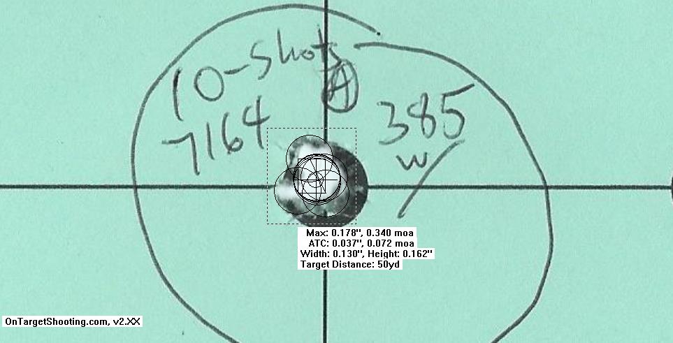

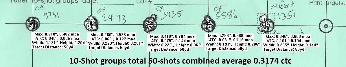

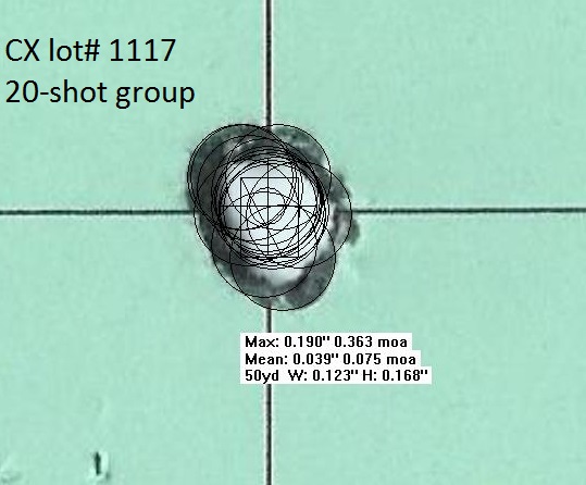

Each rifle likes different ammo. But on one day a certain rifle shoots well, then on other days, nah! I have a CZ452, two Annies and a Vudoo. They all shot well on some days and crappy on others. I think it's me. I took my Anschutz 1903 MPR (64 action) out the other day and tried some different ammo. It did not like any Eley I fed it, but then I tried some SK Rifle Match. I got a real nice group and I thought it was a fluke, so I shot two more which were the same (targets 6,7, and 8). I guess I know what ammo I'll be shooting in this gun.
Reactions: lash

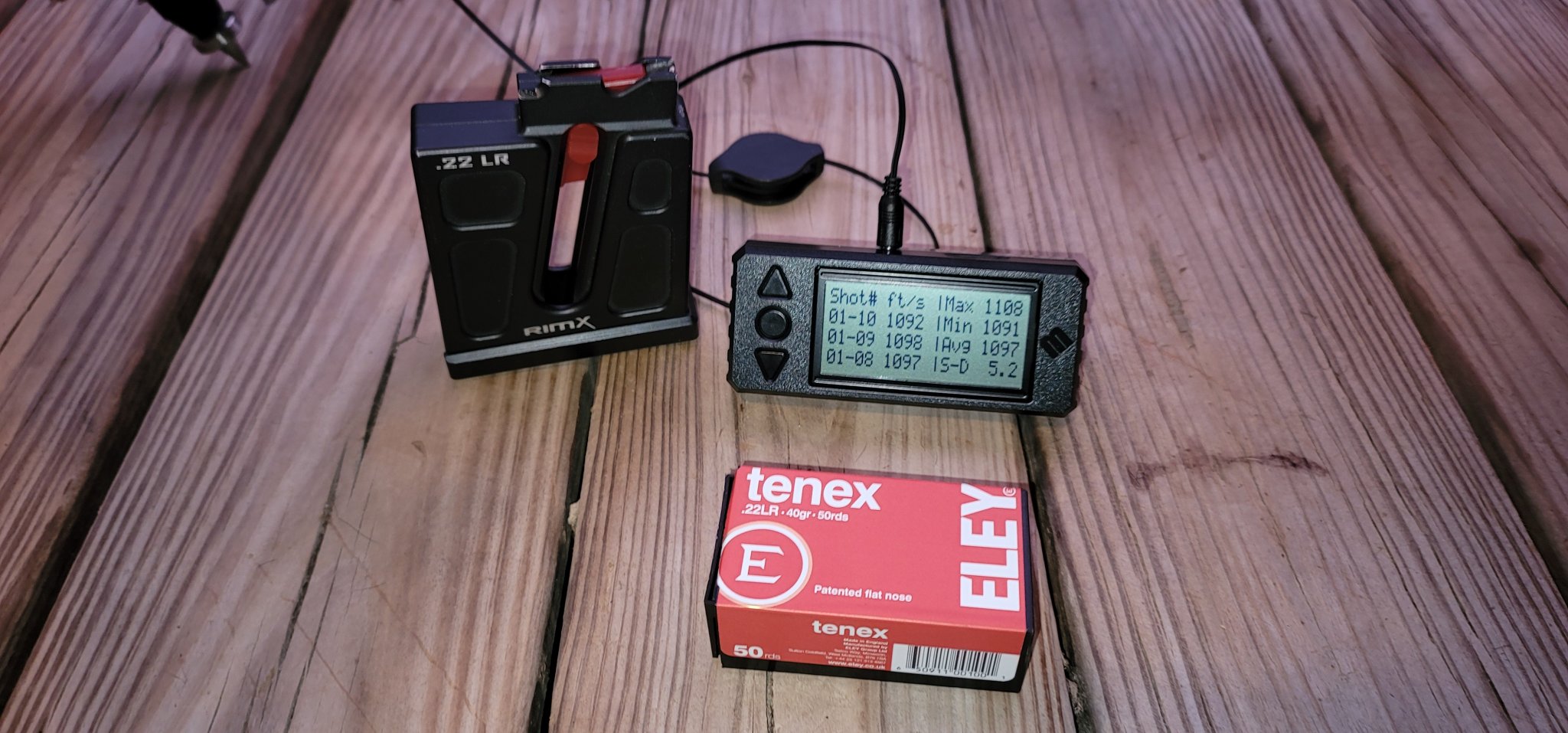

Eley TENEX and stop shopping around. I shot 20 round strings to get ES and SD. 1st steel picture is a 10 round group at 252 yards. 2nd steel picture is a 20 round group at 252 yards( had 1 fast round)
***I win for actually providing data asked for🤣...also extra credit for providing groups while collecting said data!!!***

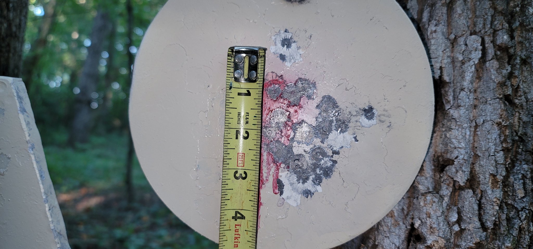

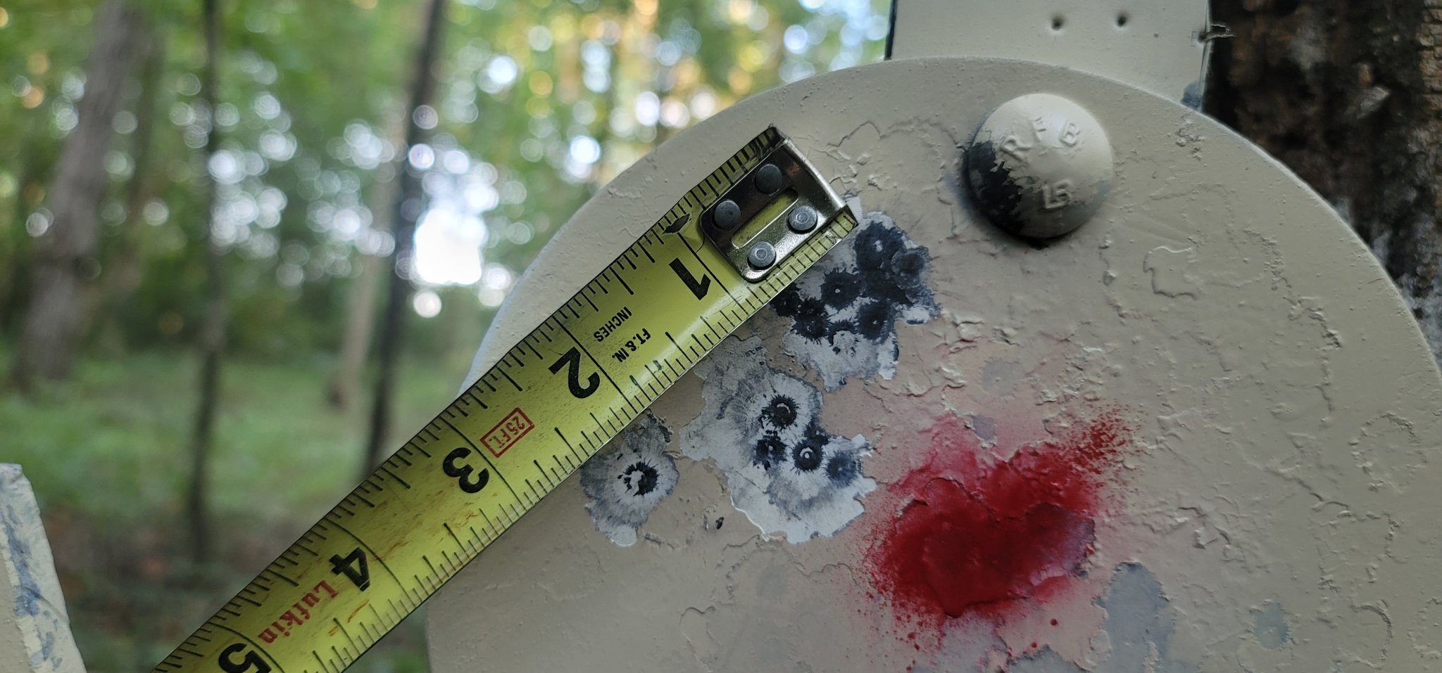

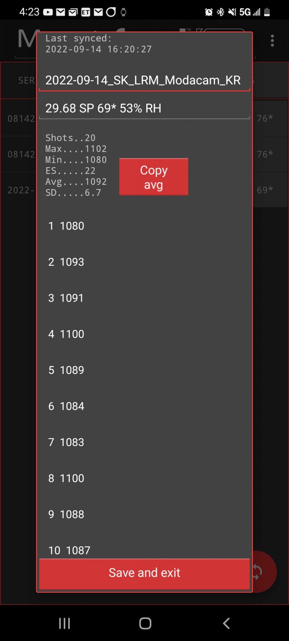

View attachment 7958078View attachment 7958081View attachment 7958083View attachment 7958085
That is awesome. Legit badass.
What is your setup?
  • Wow
Reactions: BisSilent
What is your setup?

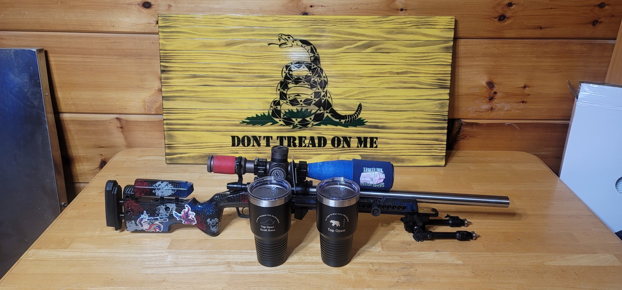

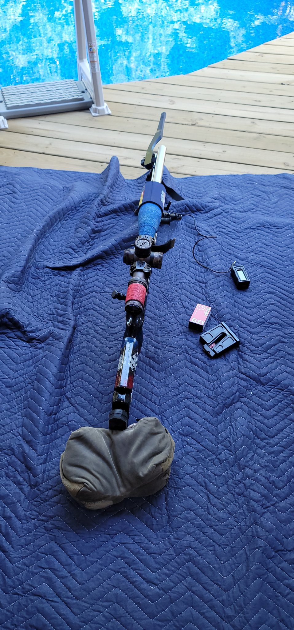

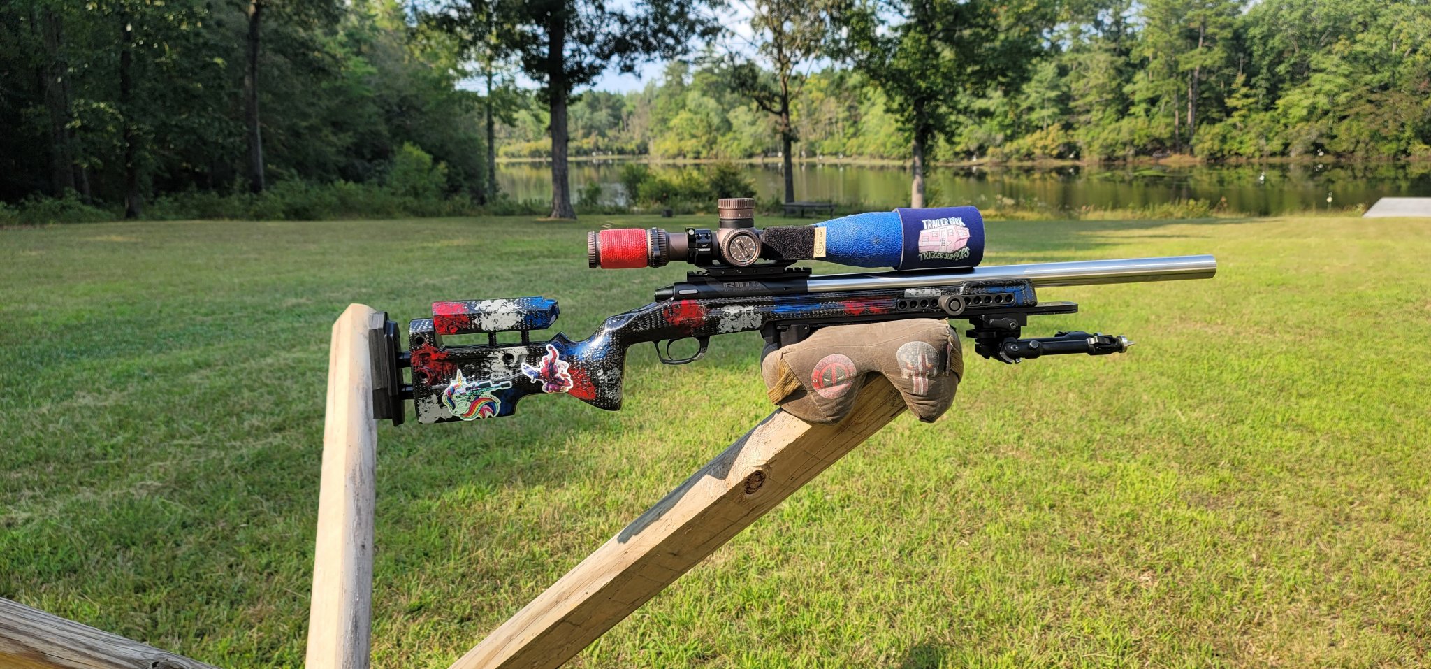

Thanks👍🏼
It is a @Zermatt Arms Rim-X with a Lothar Walther 22" Straight contour 1:12 twist (I hear they don't make these any longer🤦‍♂️) in a Manners PRS-TCS using a Vortex Razor 6-36x56 Gen III held by a Warne Skyline one piece scope mount and a Warne Skyline bipod.

It seems to me that several years ago people posting test facility results commonly showed 20 rounds being shot from multiple lots. And 30 and 40 of the final one or two lots. I don't see that being posted anymore.
Buying a lot on the basis of one 10 shot group is not buying lot tested ammo in my books.
Something to think about is how the rifle tested. if you are testing a RFBR rifle and they put it in a vise and lock it down it may not shoot the same as it would off a rest. if it has a tuner, are you 100% sure it is at the best setting? this could be why the 20-40 shot test for a lot.
6 years ago, was my first trip to Lapua prior to going there I did intensive testing to make sure the rifles were shooting its best. these 5 10 shot groups shot with lots I bought randomly to test were shot with a Falcon the far left was my best lot at the time the circle was 10mm in size, so I knew what to expect. now here where this helped, when the rifle was tested it was done with the barrel clamped in the vise as no jig was available the best lot did 12.14mm @50M and 18.58 @100m which was basically untuned because of how it was tested. so, it didn't beat my best lot, but I got to watch each shot as it formed that group, and I knew this lot would shoot. I bought all they had nearly 3 cases and wish they had 5 when I tested it in the same rifle as it should be shot it beat the tunnel test by 3.5mm I got an 8.636mm group and not in a tunnel.
IMO you really need to know the rifles being tested to be able to judge the test results. the same rifle 3 years later I did the same thing the tunnel results were 11.68mm @50m 10 shots off a rest. my own testing of this lot at home did a 9.22mm but for 20 shots.
FYI my current best lot I only did a 5 shot group and bought all I could find.
Lee
