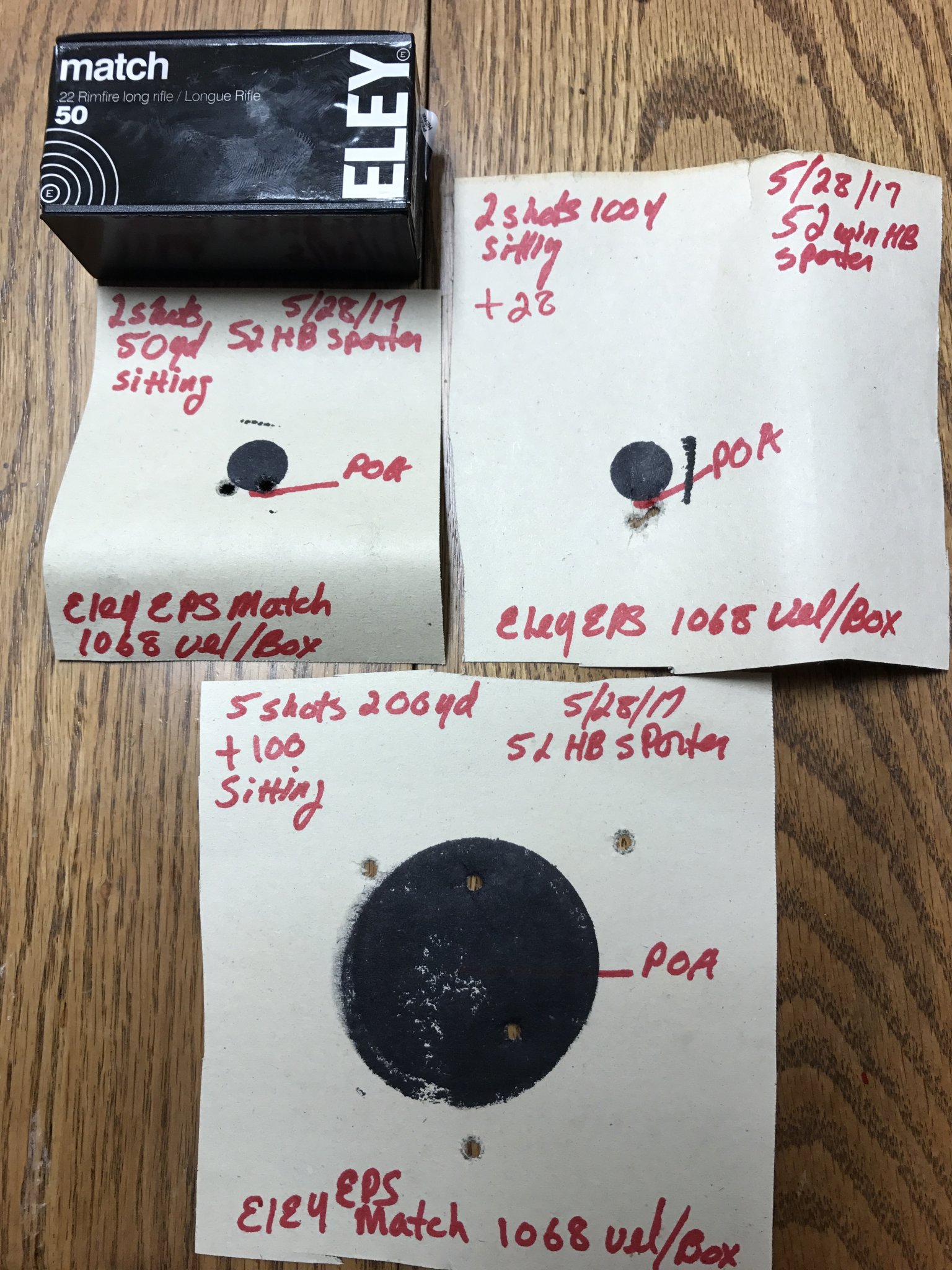

    Eley is good at 200 for me.

    I’ve found Eley Tenex to perform well out to 500 yards with my V-22’s. I have a video of hitting a 12” steel plate 10 for 10 at 400 yards, but I can’t get the video to load with my slow internet connection here.
    That's what I've been hoping to hear from someone with extended-range experience with the Eley EPS round. I'd been shooting Lapua Polar Biathlon because of its performance at 200-300, but more testing of the lot of Polar that I have has shown it's got a pretty lousy ES, while some lot samples of Eley Match EPS is showing far better ES/SD, and with slightly higher avg vel than Polar, is requiring a half mil less elevation than SK Rifle Match & Lapua Center-X at 200yds. I've got a 60 MOA rail on a V-22 Kukri, and have been wanting to test to see how far out I can get on internal elevation of the Athlon Cronus scope on that rifle - only problem is, my backstop & steel targets are still buried in snow, so I haven't been able to get out past 210yds to date.
    I'm not crazy about having to use $16+/box ammo for the few 300yd shots we have in our current 22RF precision rifle matches, and there's always the chance that our match director could put a price-per-box ammo limit in the match program, and I wouldn't bitch about it if he did. I'm still thinking that lot testing with SK Flatnose, Sport Biathlon, & probably Lapua Center-X will turn up some ammo that's plenty good enough to be competitive at 300yds & beyond.

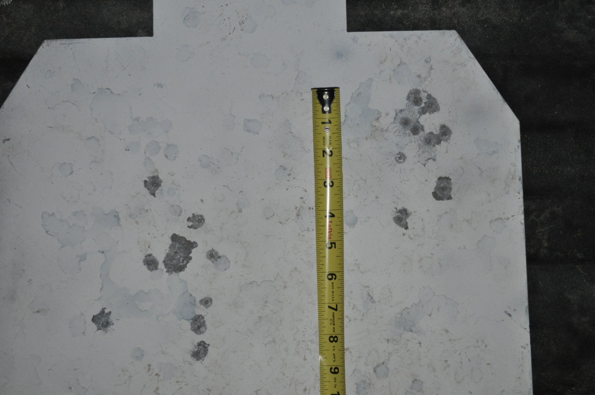

    I got my lot samples from Clint Swigert a couple of weeks ago; weather hasn't exactly been primo for testing, but I've been able to get in some shooting with the four lots I received, though limited to 210yds, and in temps no higher than 38*F. Those four lots were the only ones that Clint had in quantity, though Zanders had quite a few more lots in stock. I don't have unlimited funds or time to chase Eley lots, even though my limited experience with Match EPS is positive. Short of managing to make it out to Colorado Springs while Eley is at the Olympic Training Center, it seems my best chances of finding suitable LR ammo would be by heading for Mesa.
    Here's the results of shooting 10rd strings at 210yds out of my original V-22/Krieger 22" bbl, off portable bench with bipod & rear bag, temp 33*F, 3-5mph breeze from 9:00. SK Rifle Match left, Lapua Polar Biathlon right. This was at the end of a shooting session where I'd shot 10 shots each of Rifle Match, Polar Biathlon, and Eley Match out of V-22 Kukri, jelrod-converted 40XB, & the original V-22/Krieger. All strings were fired over a CM M1 chronograph, and I'd been down to repaint the full scale IPSC target after the first 6 strings. It'd cooled from 38* down to 33*, and the ammo had all been sitting out on the bench for the whole 45-50 minutes it took to finish up. It'd gotten cold enough so that I didn't feel like taking the time to shoot the Eley Match through the V-22's Krieger, which is why there are only two strings on the target. I've seen SK Rifle Match shoot considerably better than that at this distance, but always in warmer temps - the ES of this cold-soaked ammo was 44fps, with SD of 13, avg vel was 1045. Polar's ES was 30fps, Sd of 10, avg vel - 1074. Three lowest recorded shots were 1062, 1064, 1066fps, while the highest was 1092. I'd come down .4 mil from shooting Rifle Match before shooting the Polar. If I could find a lot of Polar with an ES comparable to Eley Match's 15-20fps, I'd expect it to be good enough to buy in quantity, especially since the Krieger on the original V-22 seems to like Polar more than the other two bbls do.
