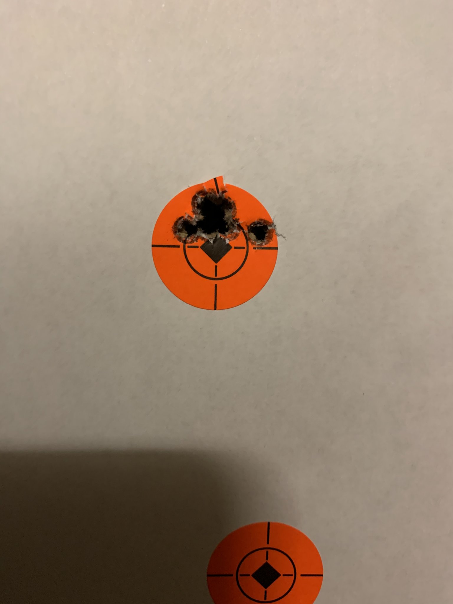

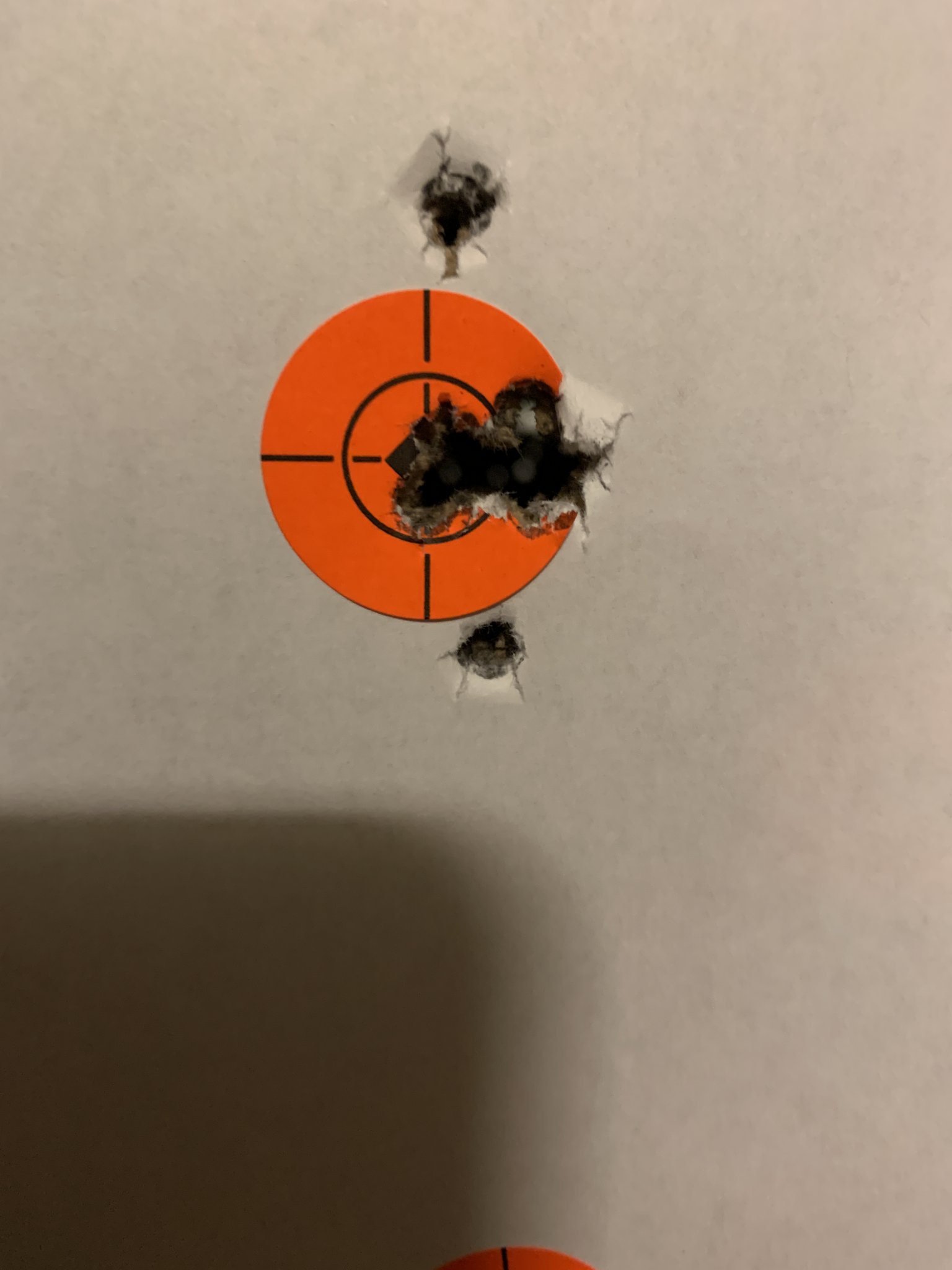

I had a SWFA SS 10X on my JP barreled AR. It worked pretty well at 50 yards. I’ve replaced it with a USO LR-17 but have yet to sight it in and try it out. Since trying SK S+ in my Vudoo, and getting amazing results, I haven’t shot it since lol. For what it’s worth, the JP barrel is a good shooter. Here are some 50 yard 10 shot groups with CCI SV and the SWFA SS scope. I’d bet money it will do better with better ammo.
