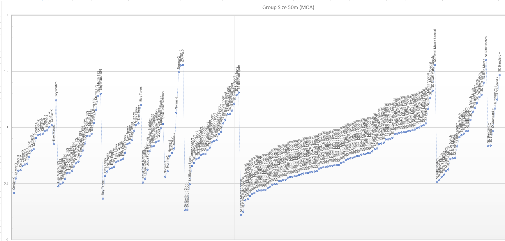

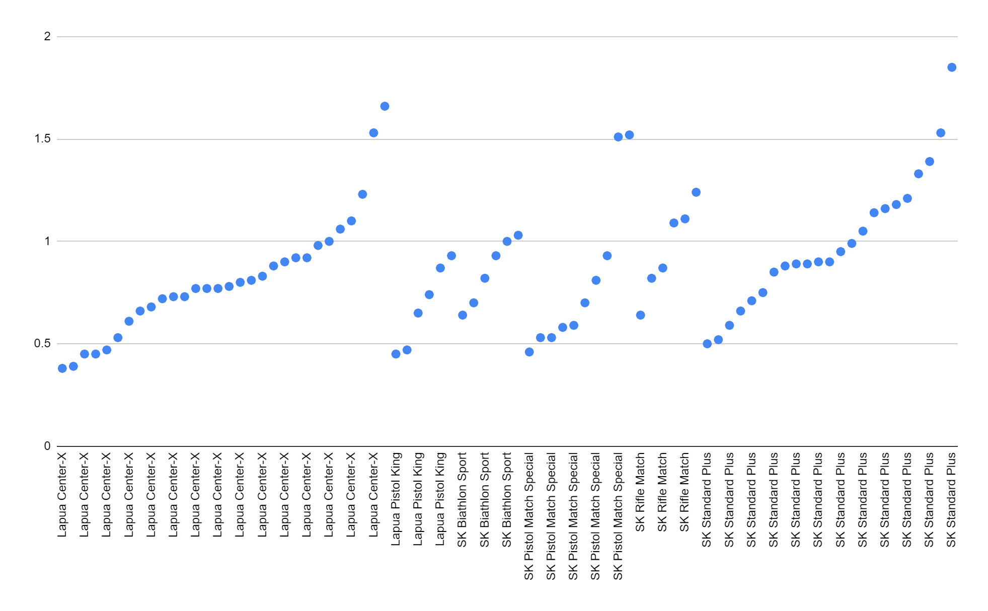

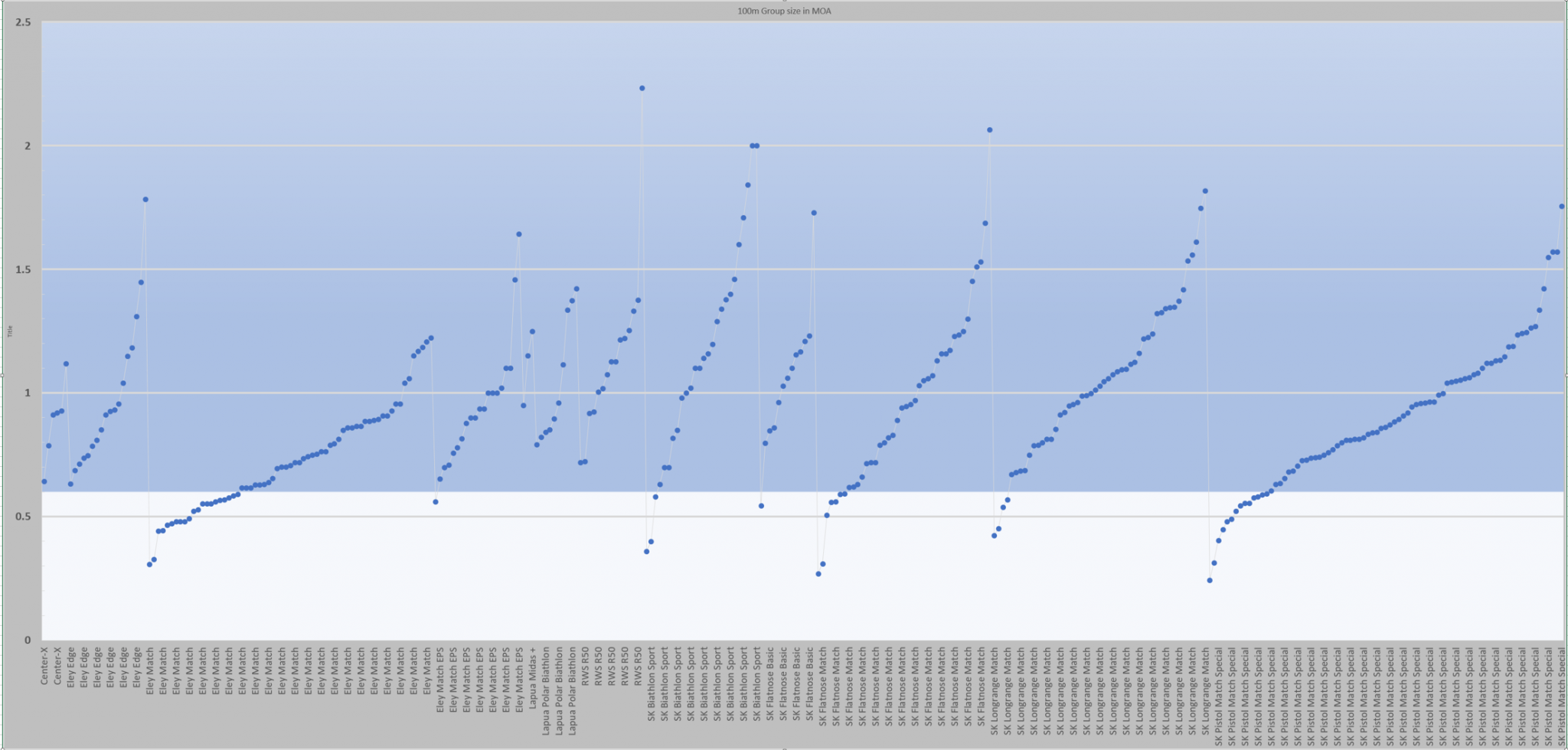

the graph below shows my 5 shot group MOA results for PMS and other ammo (the good the bad and the ugly - no cherry picking.) You ca see that PMS is definitely one of the most consistent for me/my guns. You can see that at 100m Eley Match is better for me.
50m
100m

I LIKE those graphs and will have start doing that myself. I assume you're sorting from smallest to largest MOA to get that progression???
@straightshooter1 Thanks :) yes, sort by ammo type then group size. I find the graph really helps to see which ammo types are consistent and which have, to borrow a phrase, 'random acts of accuracy'.
The only thing I think I'd like to see on these graphs is the environmental conditions, like for wind, which could be done by color coding the data points. This way, i'd also be able to see the performance as it relates to the conditions (like the wind).

Such an awesome graph. I wish I did something like this... I do have most of my 6x5's saved in Range Buddy, I should take a look and see what I've done. I kind of gave up on doing groups now that I started doing competitions, bot 3000 rounds of PMS, 7000 rounds of SK+ (training ammo), and 2000 rounds of C-X. What's interesting is my SK+ and C-X have the exact same dope. Chrono within 5-10fps of each other, and same POI. So I can go immediately from training to matches without changing anything.
I've been mainly shooting PMS though since it's only $7.50 a box vs $11 for C-X. NRL22 within 100yards, is always going to be PMS for me. I'll shoot C-X as I'm shooting out to 250-300 just for a slightly tighter consistency.
PMS being almost half the cost of Eley Match makes it probably one of the best performing rounds for the price.

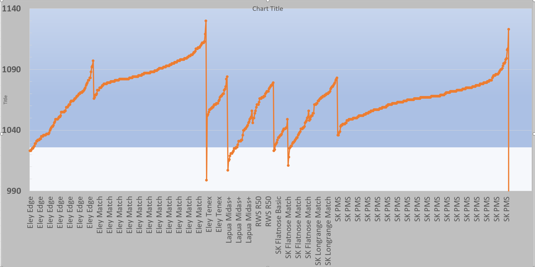

not surprisingly the plots look the same if you plot velocity instead of MOA.
That is just trying to show the avg velocity per grup? So the bigger the vertical spread the worse the overall groups? Midas+ seems to go from 1010 to like 1080?
PMS goes from 1035 to 1120?
Actually it shows the velocity of each shot. the very high velocities are, in general, cold-bore shots. But it shows the variability of the velocities for each ammo type. And yes, in my 200 STR, Midas+ isnt very consistent.
