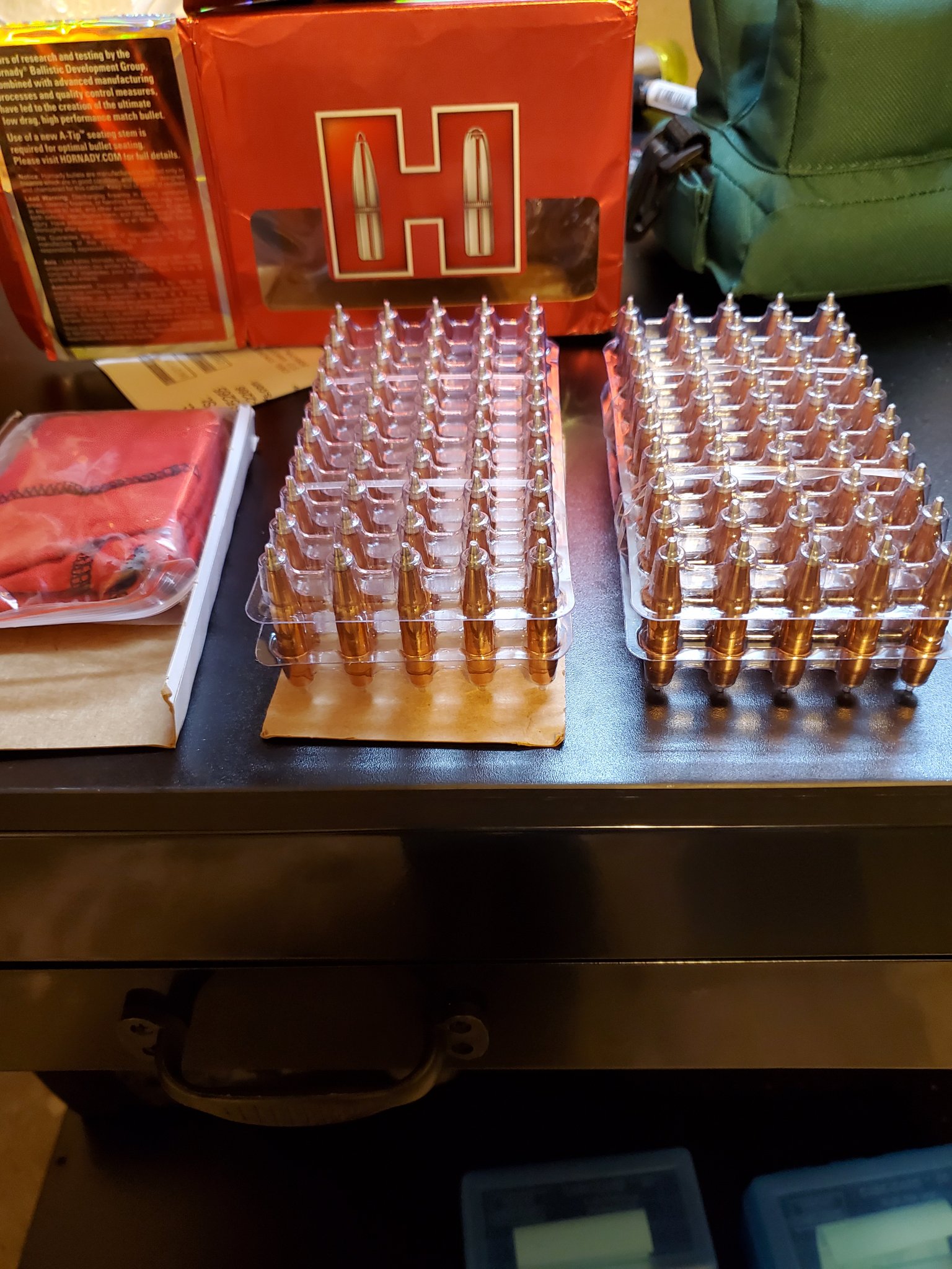

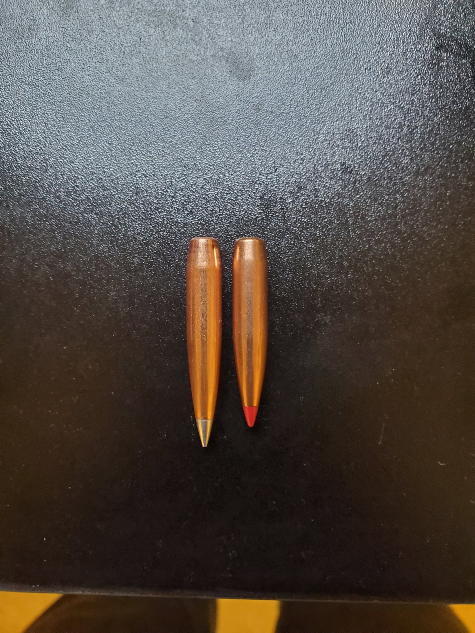

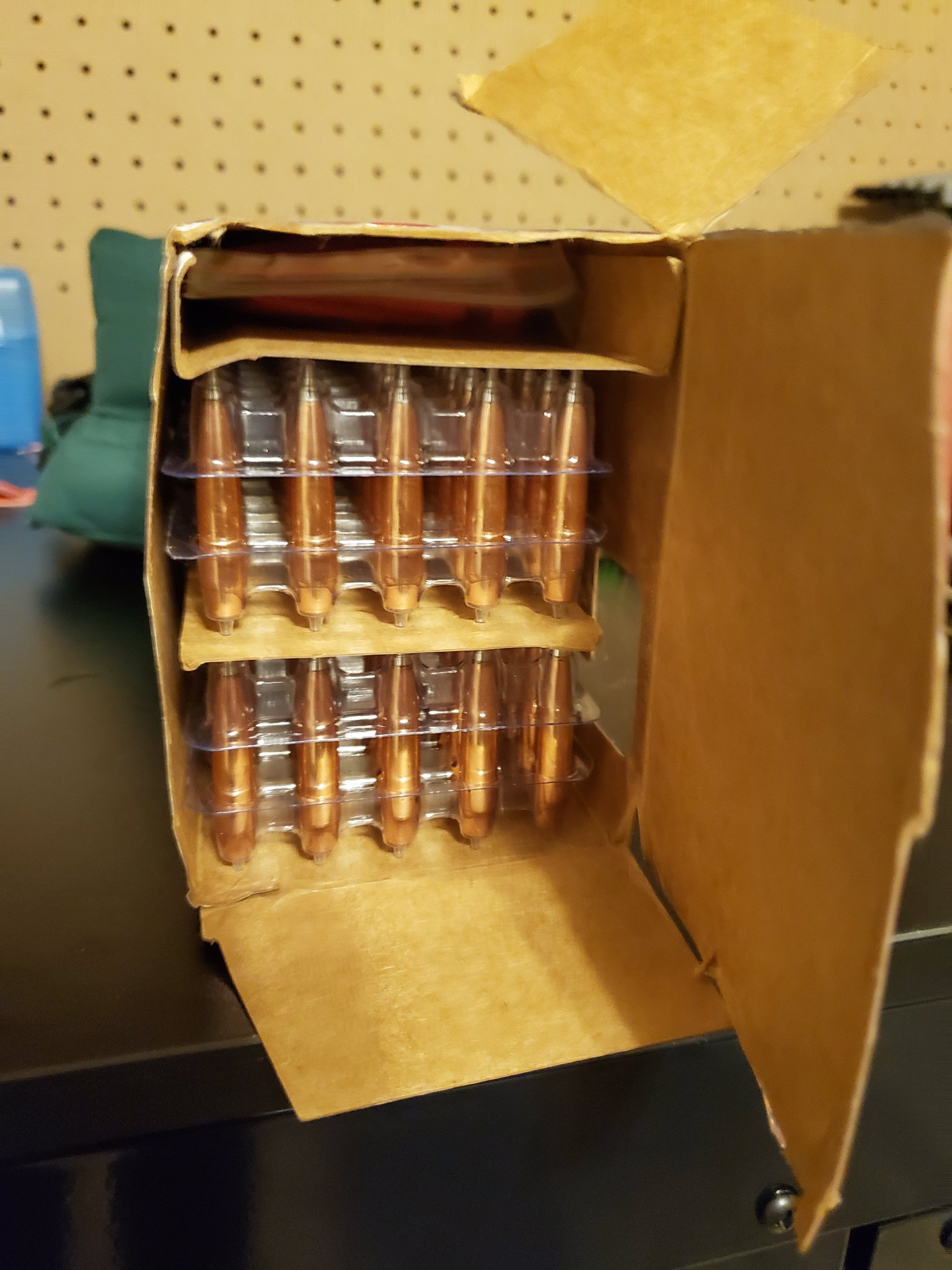

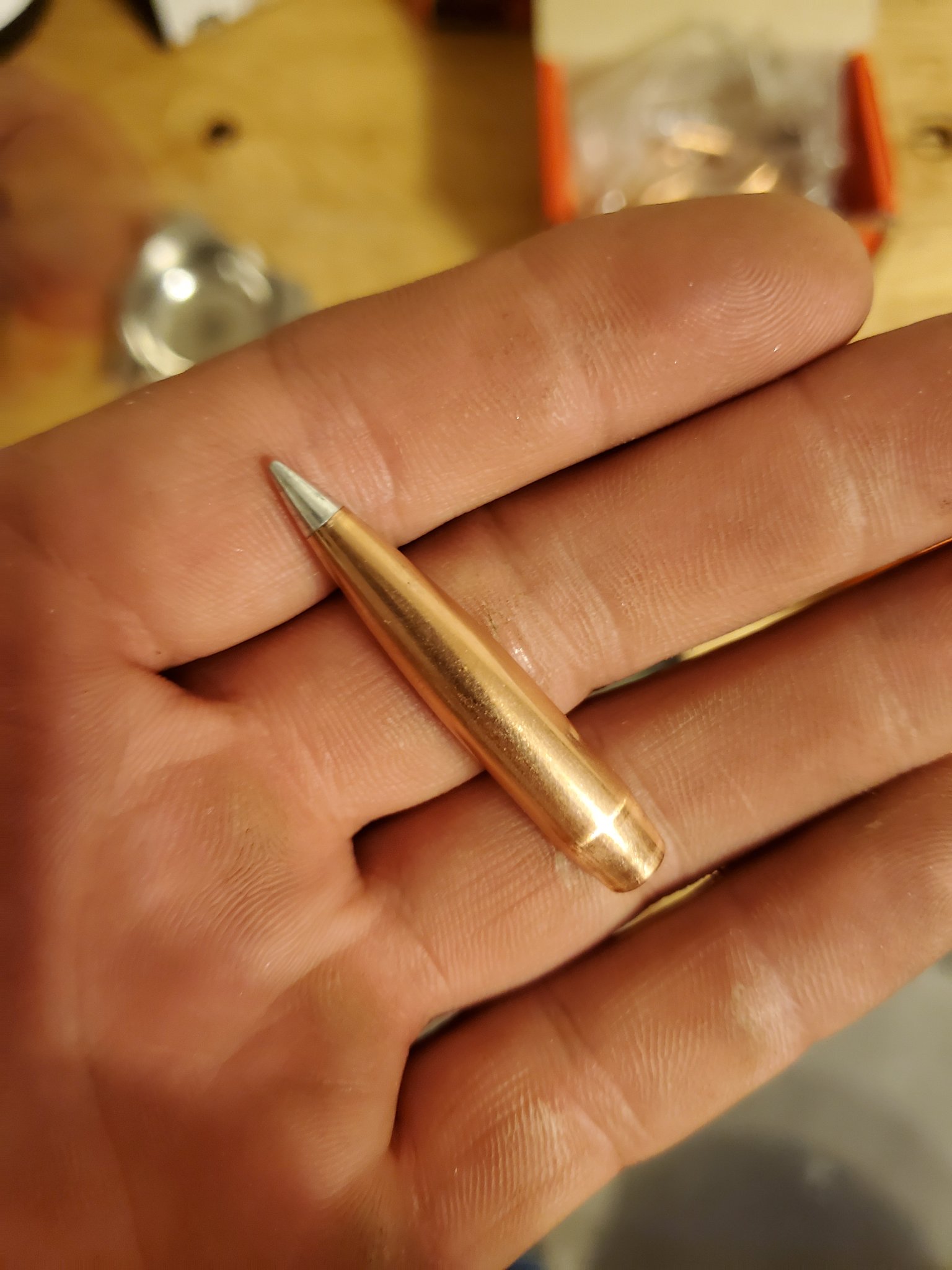

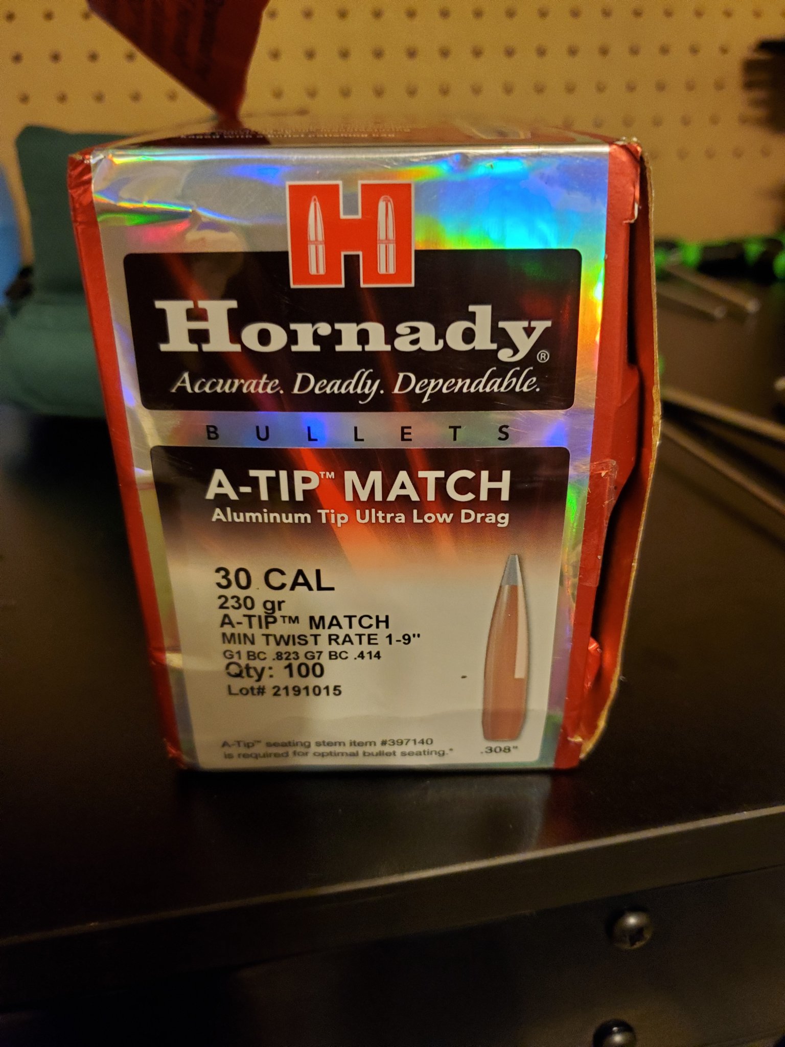

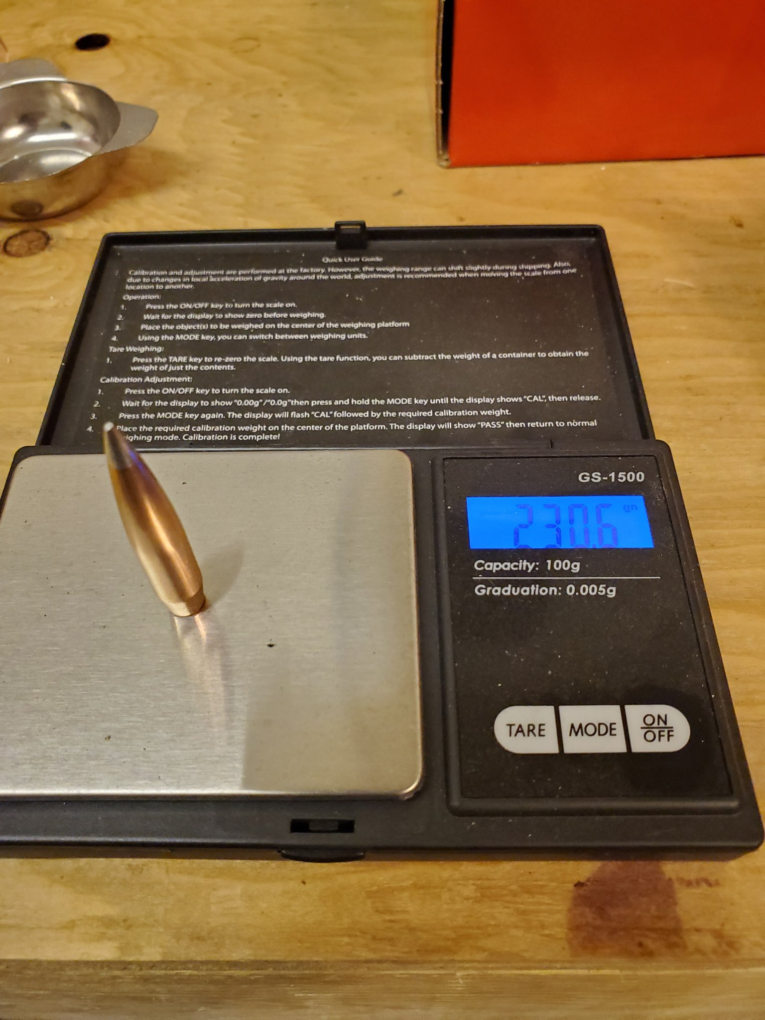

230 A Tips arrived. Not impressed so far. Flimsy packaging and weights are off. Last pic is comparison between it and 212 eldx.

I checked 25 out of 100 and got 230.3 to 230.9.
Did you check the weights in order?...I'm not trying to be funny...just thinking that is how I will weigh mine tomorrow when I get them. Did you take any measurements of the ogive? meplat diameters? Boattail measurements? I was going to get all nerdy on mine.

Well I'm not sure the order that they were placed into the packages. But yes I started at the front and went left to right. As far as overall length they only deviate. 0005 from 1.769. .905 to ogive. Boat tail is .228.

Got mine in today... everything measured great....my weights were a tiny bit off...
I had :
229.9 qty 4
230.0 qty 16
230.1 qty 12
230.2 qty 24
230.3 qty 32
230.4 qty 8
230.5 qty 4
Guess I could cull the 229.9, 230.4 and the 230.5 and call it good with only losing 16 out of 100...but I'll actually test and see if....with my skill set...if I can notice a difference between the weights...or if my own error factor as a shooter is greater than what the weights show.
First off, I don't know if I would trust that scale... I have the same and it drifts like no other when weighing anything. But definitely looking forward to these bullets and their performance.
My scale i had like that drifted a substantial amount as well. The day i threw it away and bought a chargemaster was when it was calibrated, I continued to weigh less than 10 powder charges and noticed a swing of .7 grains on the scale.. i recalibrated it, weighed the same charges and there was a swing of only .3 grains.. That was with a fresh battery. I took the battery out and trashed it.
