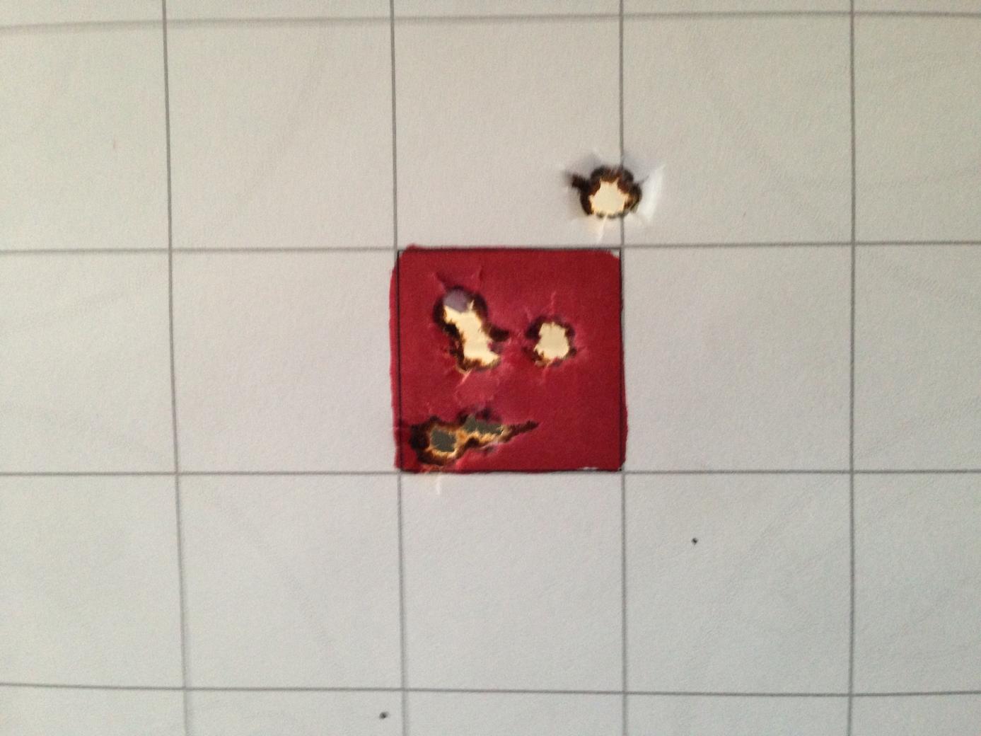

This powder doesn't meter well but IMR4064 36.5 grs worked very well in my 26" Remington 700 varmint rifle I posted a 10 shot 600 yard group here somewhere. A bit over 3,000 fps 6 shots covered by a dime is what my notes say @ 100 yrds. Its been a couple years but its still a Hell of a good load.
Winchester primers winchester brass mag length.
Here it is yes it was windy & my for Shit NIKON wouldnt track so I shot for a group, that's why its not centered
600 yrds

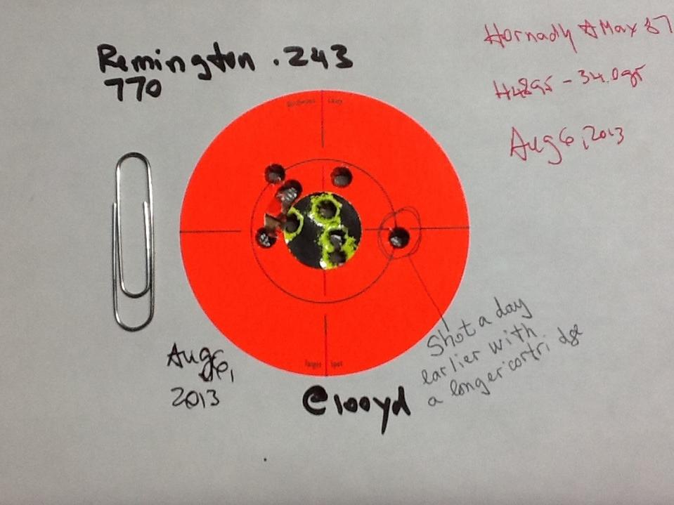

image.jpgimage.jpg have tried with excellent results v-max 87 gr with winchester cases, H4895 powder @ 34.0 gr , WLR primers. I seated the bullet @ 3.16 in ( measured to the ogive) and crimped very lightly.. See attached
