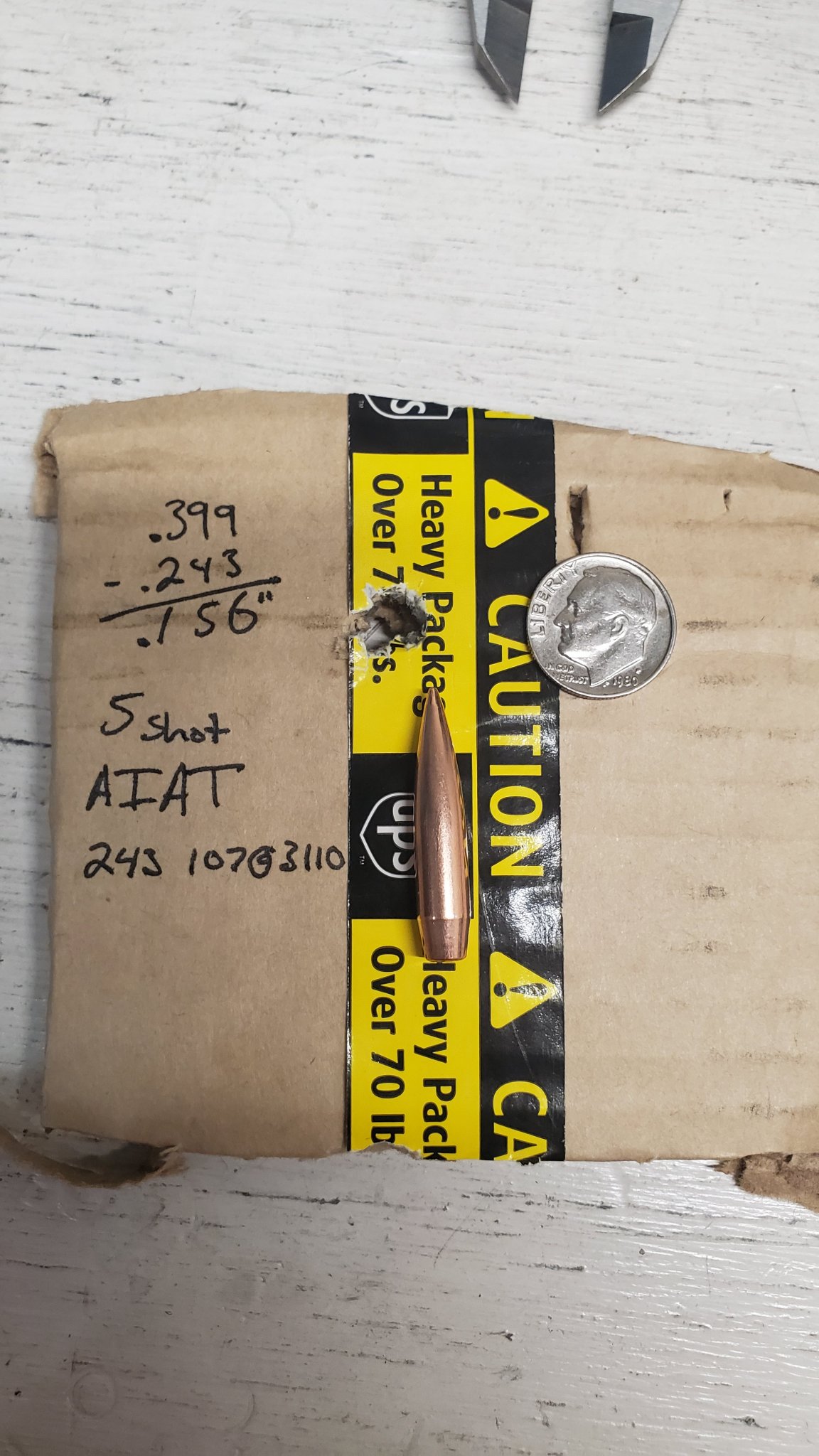

I spun a 26" AINA Bartlein 1/8 .243 barrel on my AX 6 years ago and made up a load with 105 Hybrids jumping .030" over H4831. During workup I saw speeds over 3200fps and physically couldn't get enough powder into the case to show pressure signs. I was deforming the bullet trying to seat it into 47.5+ grains of powder. I backed off the charge and found an extremely consistent load at 46.8 grains running 3130fps.
That was 1200 rounds ago. I have never touched the load. I have seen ES's starting to pick up lately but I am attributing that to the doughnut forming in the necks of the 4x fired Lapua brass. I can feel it there when I seat the bullets. The brass hasn't grown at all since the second firing so I figured that brass flow had to be going somewhere.
Curiosity got the best of me and this week I finally broke down and measured the throat to see just how much I was jumping after 1200 rounds. I was expecting .150+ of erosion from some of the PRS style matches I had shot with this barrel. In disbelief I measured 3 more times to be sure I wasn't screwing it up. .040" is how far the lands had grown.
I've been told that this is not the norm. That others aren't getting the speeds, accuracy, life, ease of loading, the complete lack of tuning throughout the barrels life, etc... Despite all that, I'm pleased that this barrel will be making its way onto my new AX. It's shooting the best it ever has right now. I finished 3rd in a local LR match with it a few weeks ago against some stiff competition. How much life she has left is hard to say... But until then, she's getting sent.
