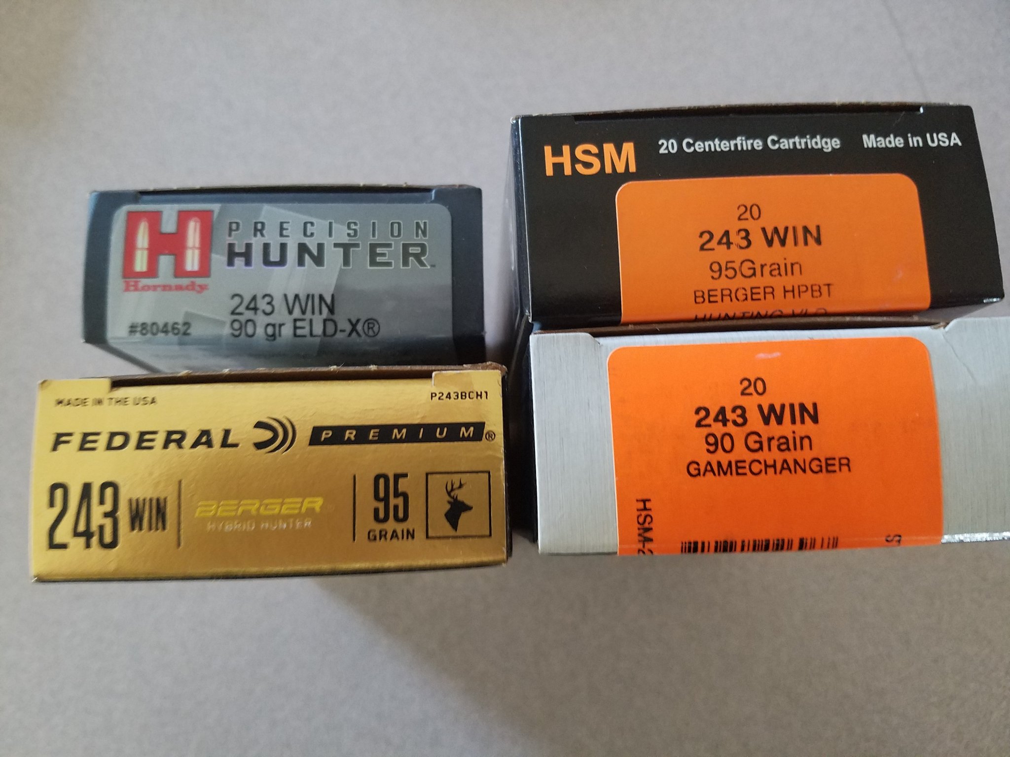

Hornady has their ELD-X ammo, its a 90 grain bullet though. That's probably the closest factory match option

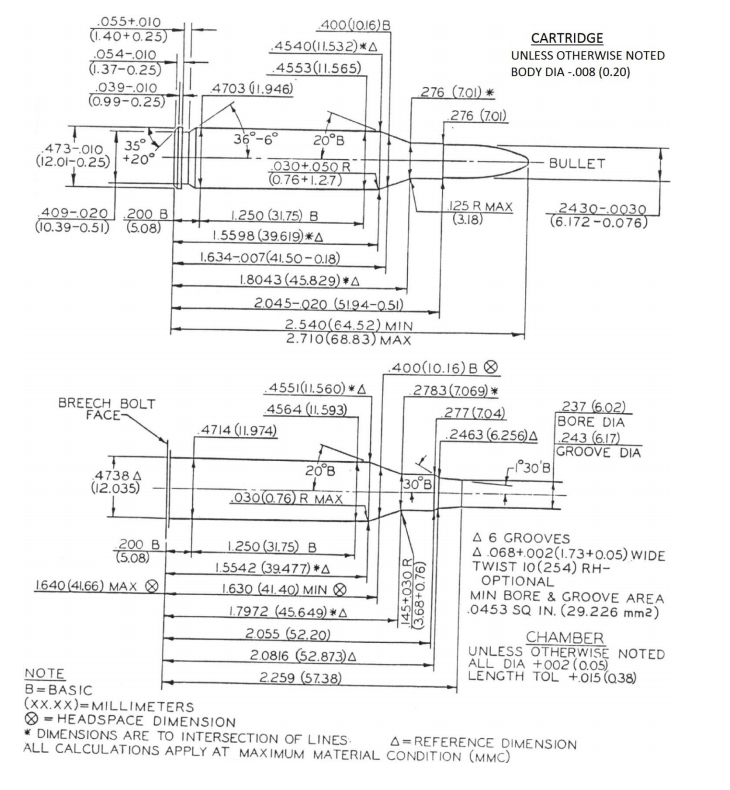

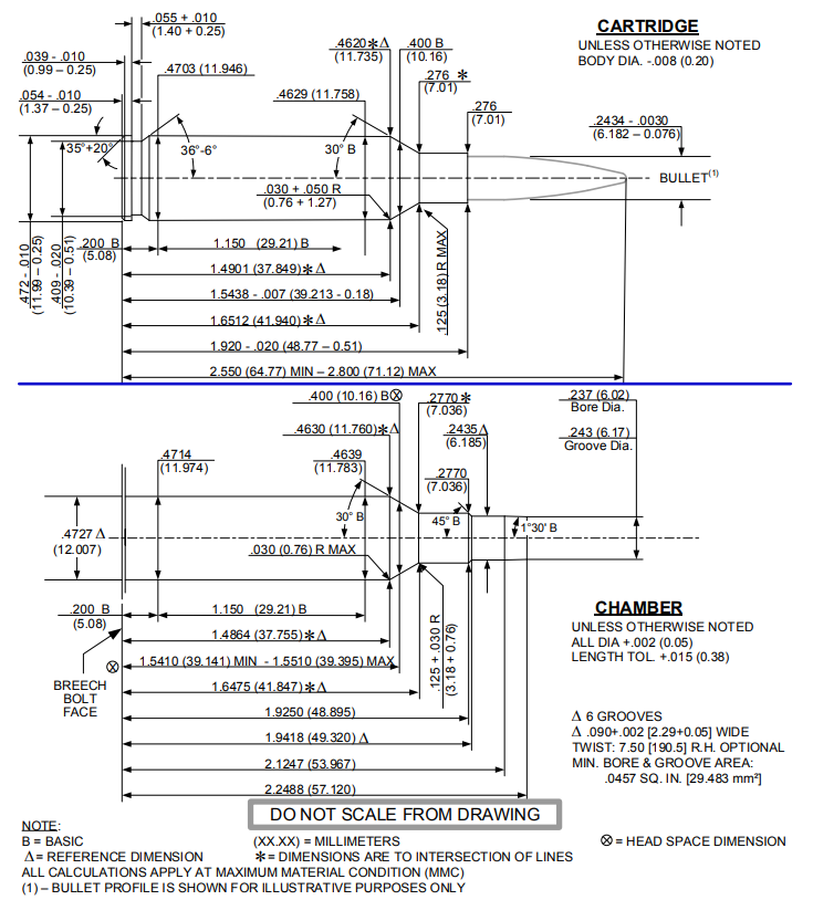

Yep. Pretty much all of the popular medium sized rounds use the same bolt face. 6/BR/6Gay Tiger/243/260/308/22=250/6/6.5 creed 30/06 all same bolt face.
Have her choose between these two diagrams
If she cant justify one over the other to you then she cant justify her choice of a 243 either meaning she should just go creed for the ammo availability.

Here are a couple of links to cheap loads that would cross for LR and hunting. The second link is for GECO/RUAG which is a proven manufacturer.

Spark Munitions has 243 match using 95 and 107 match kings. Not sure on price, but I'm thinking the 95gr was around $30+ a box when I looked. I've been wanting to try a box but haven't had a chance.
There's quite a variety of factory ammo listed here with 90 grain bullets or heavier. You just have to do a search so you can see for yourself. Spark Munitions would be the other place I'd look too since they usually have quality loads.
