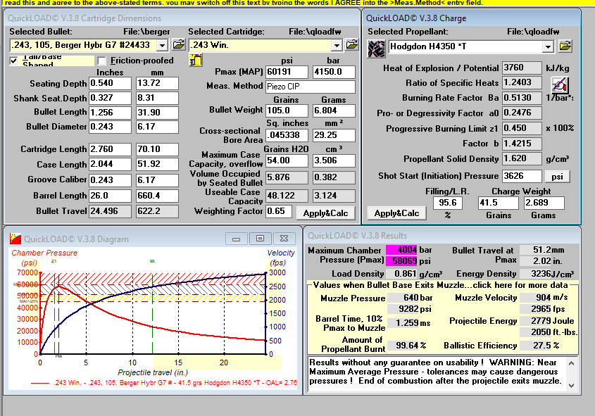

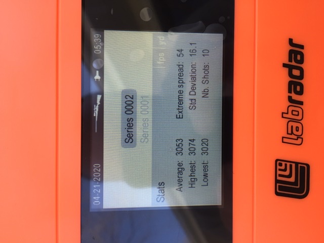

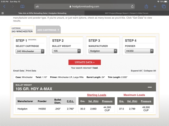

I recently purchased a 243 and started load development based off some things that I read on here started at 41.5grs of h4350 come to find out it’s way over book Max hodgdon online manual says 37.5 is max It shoots really well primers look good don’t know what to do would you use this

Saw that...
They list max charge pressure well below the 243smax at 60000 also.
CUP is listed, not PSI
52,000 CUP is max SAAMI for 243 Win

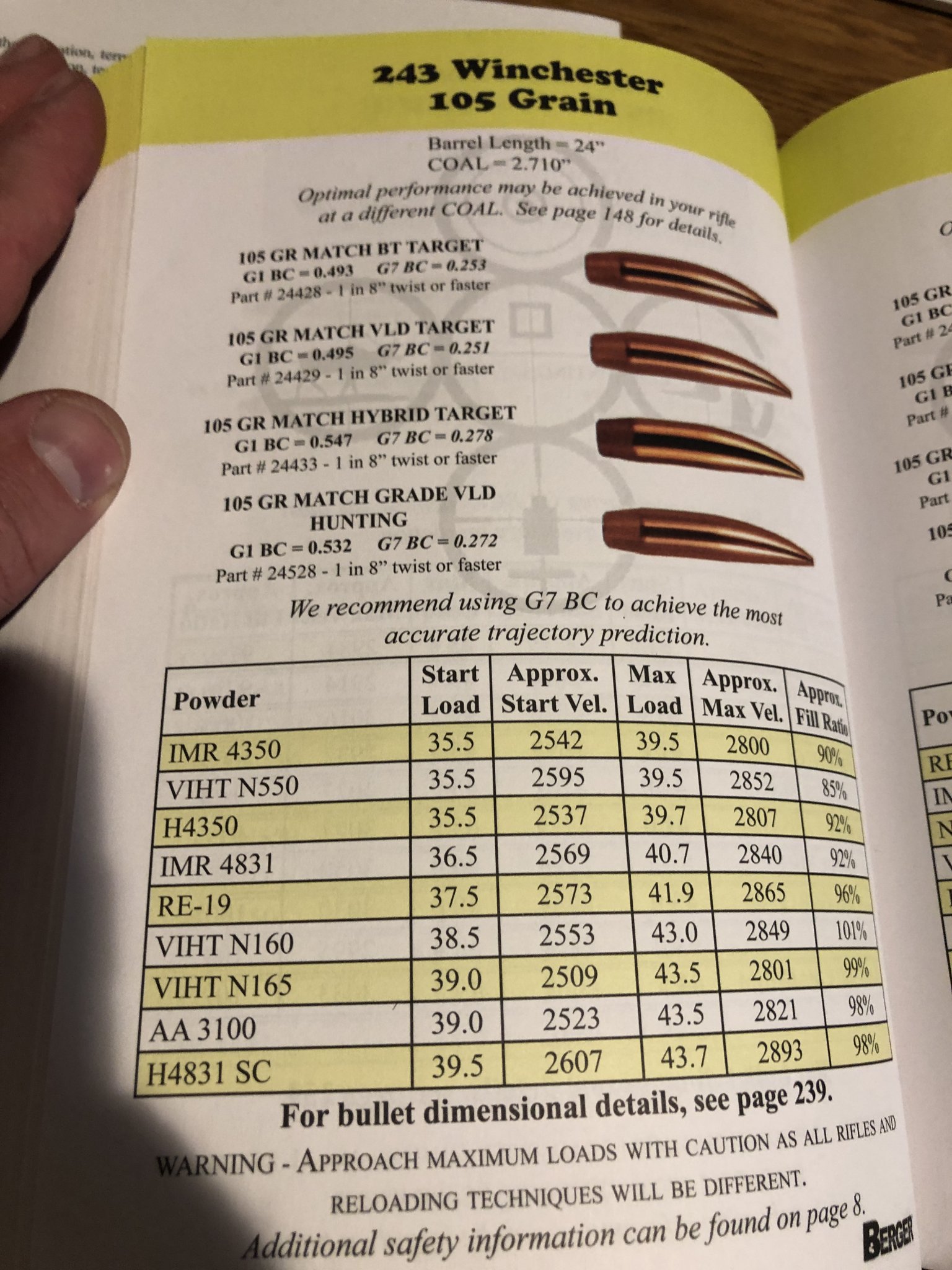

I would back off. Here is the page from the Berger manual.
The Berger manual one of the most conservative out there, they will tell you themselves, all data QL generated, and they stopped short.

I just looked at hodgdons website, and it seems very conservative for the 243. If you look at past threads on 243 loads, there are plenty of people that are running 42+ gr of h4350 with 105's and heavier bullets.

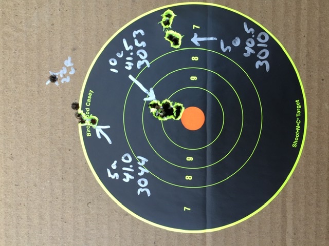

40.5 gr in lapua brass with a 105 hybrid Gets me 3010 26” 8 twist new ai ax barrel 30 rounds on it. But it doesn’t shoot quite as well as the 41.5
