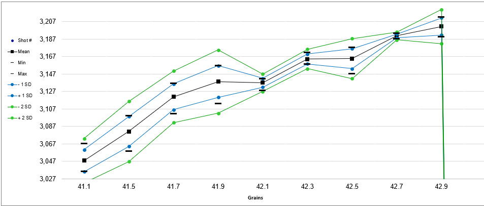

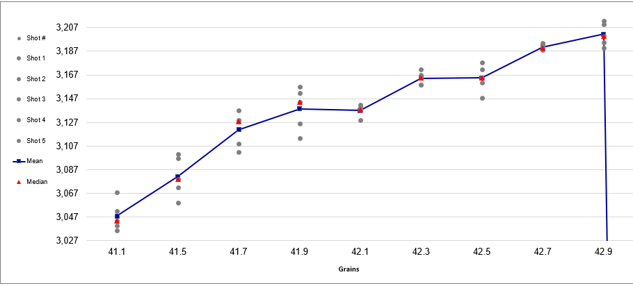

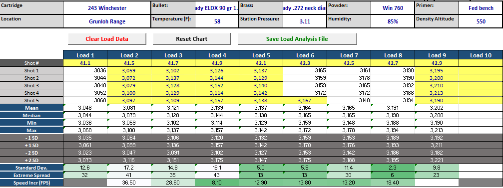

Would you guys concentrate on Load 5, Load 6, or Load 8
I couldn't believe the how low the SD was on Load 8, but the"node" around Load 5 and 6 look pretty sweet also.
It was pretty windy out, so my targets didn't look fantastic on any of the loads, but 5,6, and 8 definitely stood out as the tightest groupings
