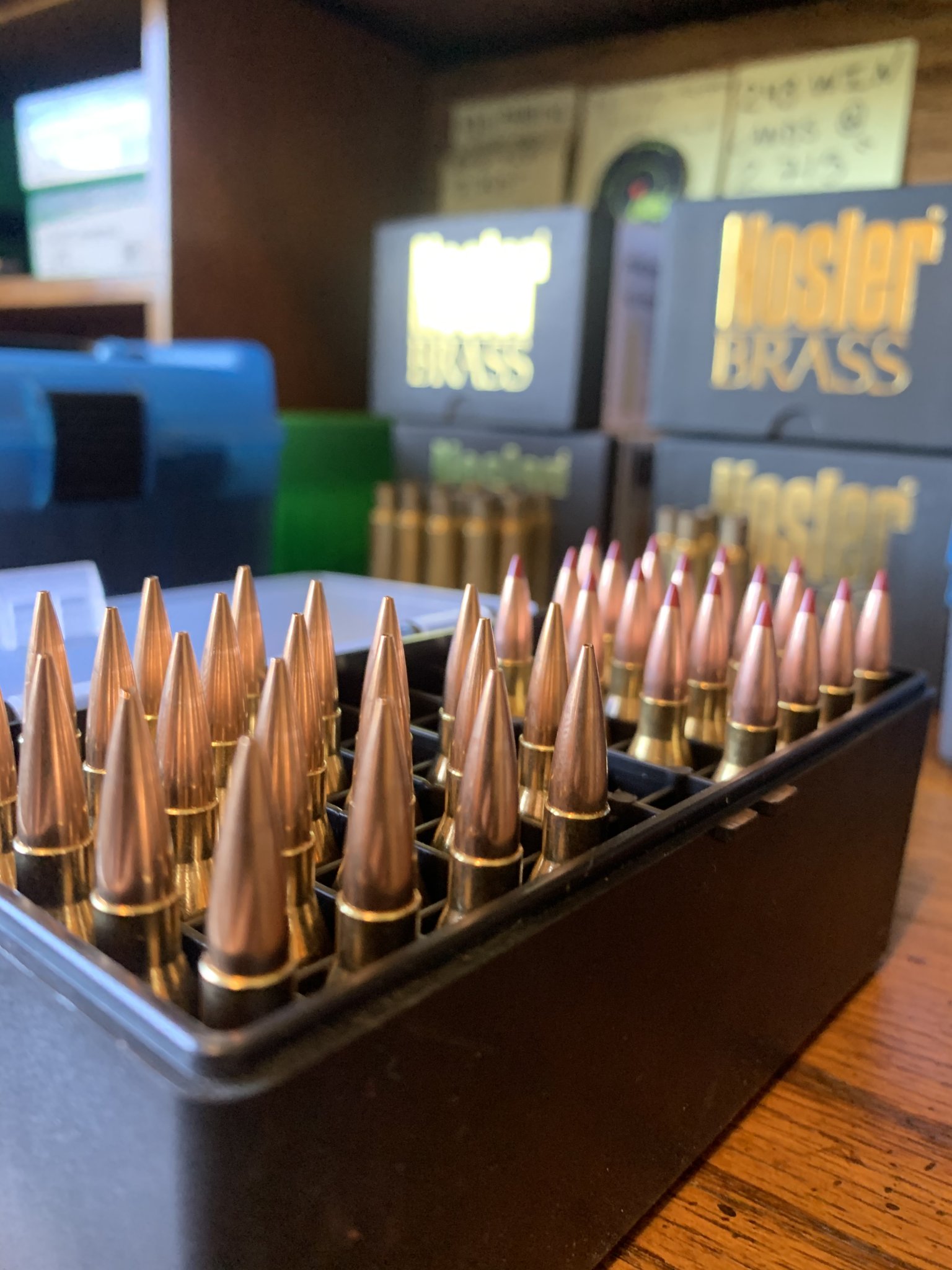

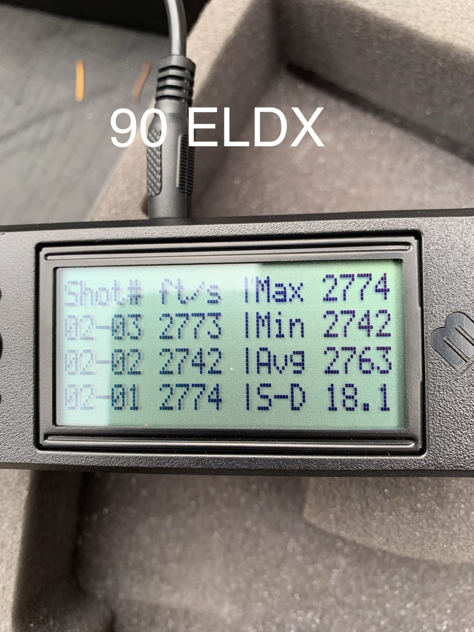

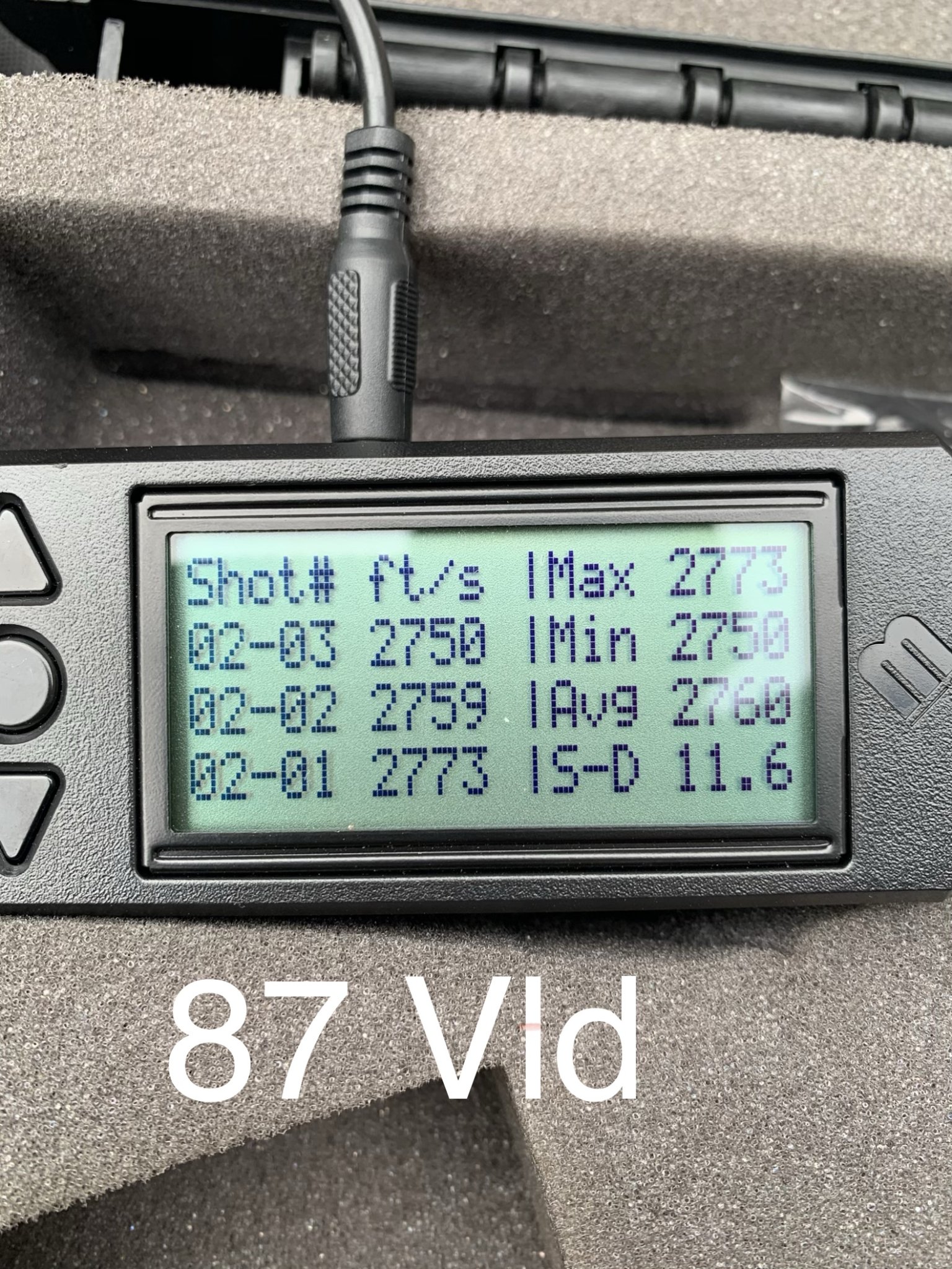

    I have 2 loads worked up for my Rem 700 youth model with an 18” barrel.
    First is 87g VLD seated at 10 thou off lands. 43g H4831SC. CCI 200. Nosler Brass.
    Second load is 90g ELD-X seated 30 thou off lands. 38g H4350. FED 210match. Nosler brass.
    Both shoot extremely well and close in speed. I’ll add pictures of group and chrono.
