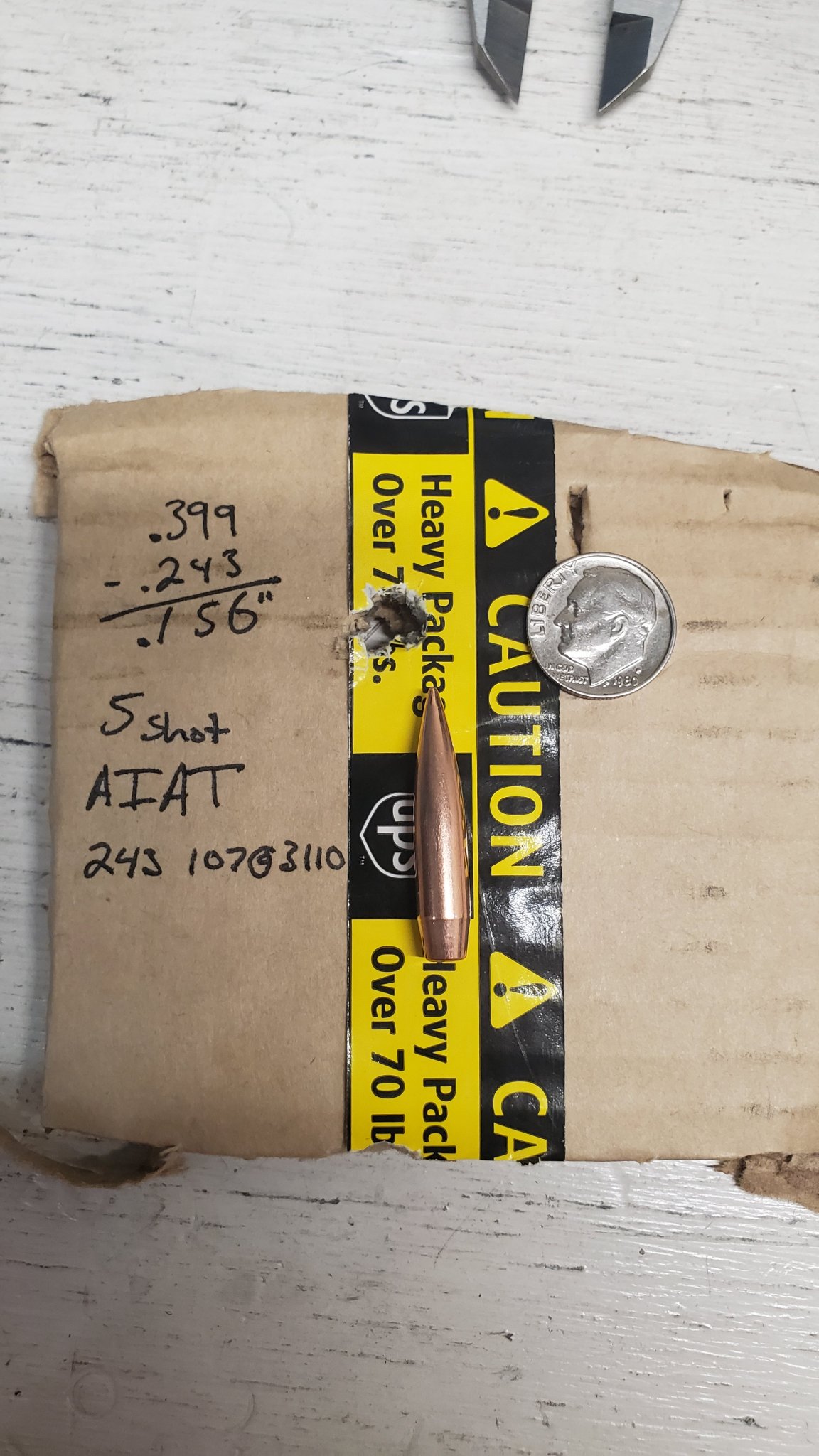

243 is fine, mine go about 1800-2500rds. Alot of guys shooting 6creed are frying the barrels at 1200-1400rds, trying to run 3100fps. The 6 creed doesnt gave the case capacity to run that hard. Well it does, but at the cost of 65000+psi, which kills barrels. 243 can live a long life at 3100 with 52000psi chamber pressure.

243 is fine, mine go about 1800-2500rds. Alot of guys shooting 6creed are frying the barrels at 1200-1400rds, trying to run 3100fps. The 6 creed doesnt gave the case capacity to run that hard. Well it does, but at the cost of 65000+psi, which kills barrels. 243 can live a long life at 3100 with 52000psi chamber pressure. View attachment 7055201
wow. If your 243 groups look like that...what the heck do your 6BR groups look Like? (assuming by your name)

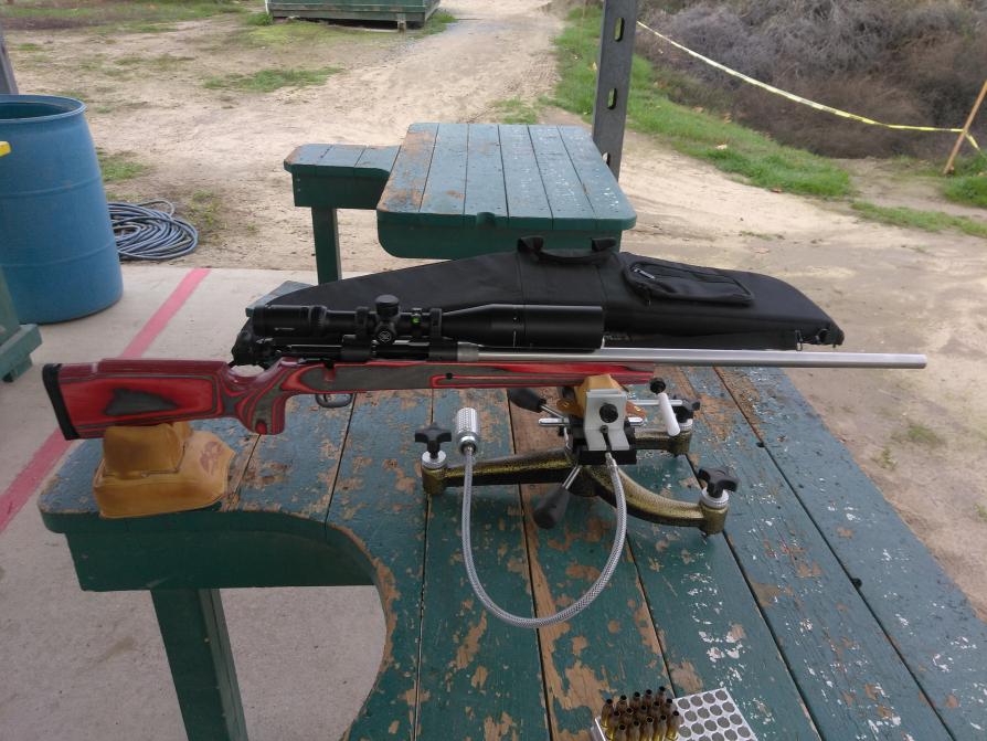

That was a great group, normally that rifle is in lo .2s off a bipod. My 6br shoots like this, better when it's on a pedestal rest.
