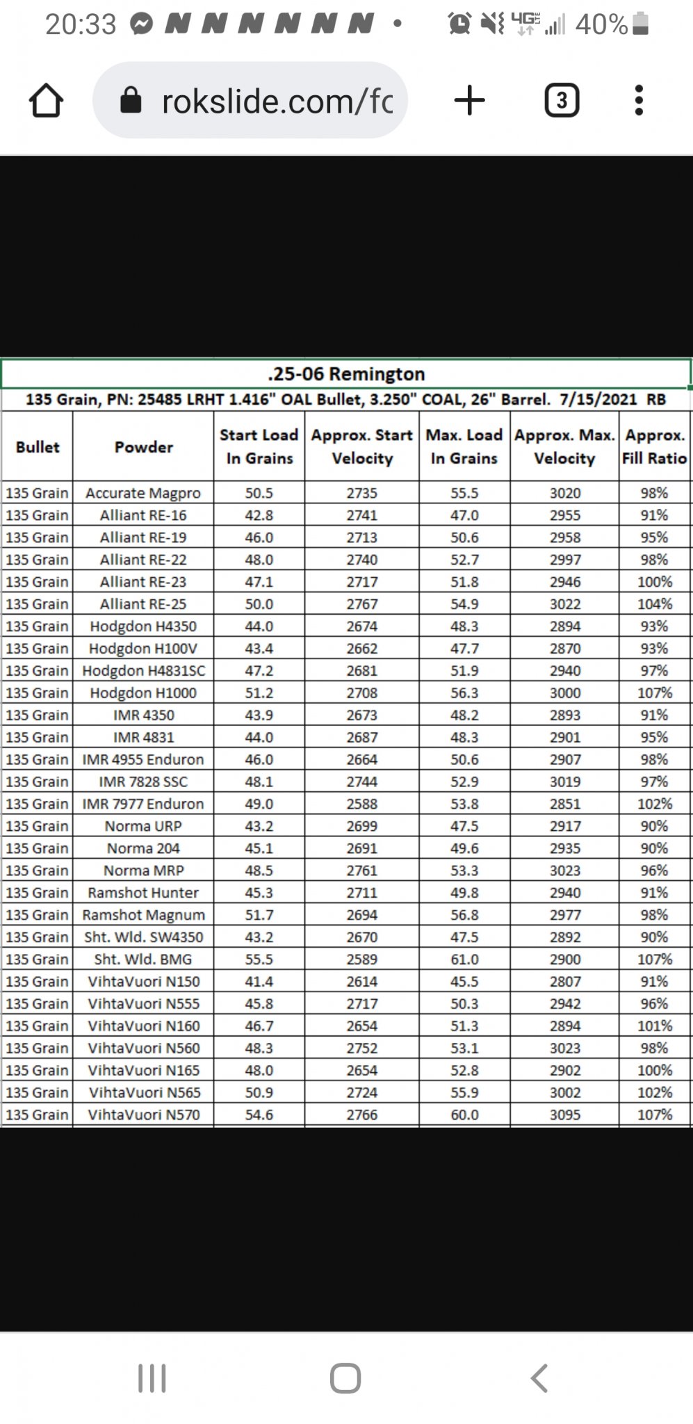

Here is some data I got from Berger bullets support team.

25-06 should get the 135 Bergers moving at a good speed, what is the length of the throat?
A 140 at 2800 is very reasonable with a 6.5 creed, so if I'm reading the chart correctly, it looks like you're trying to get a 135gr to the same speed.

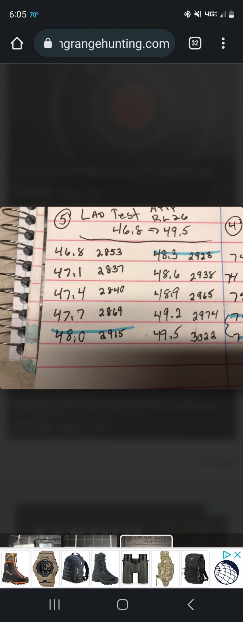

This is some data I found on LRH where a guy was testing 135 atips in a creedmoor. This is also in a 24" barrel I believe.
I'm not trying to be a dick here, I have wanted a 25-06 for a decade or more, and never really looked into it that hard, but that data chart above seriously disappoints me. I figured a 25-06 would push that 135gr to 3200+. It's seriously not even capable of creedmoor performance. That's a 26" barrel and a ton more powder. Am I missing something? This is disappointing.

Rl26 is the powder, and you can get it to well beyond 2800. 3,000+ if you can believe the folks who have tested it.

No, you can't get well beyond 2800 in safe pressure. If you go to alliant's sight their loads for the 264 win mag for 140s are 3000fps or less. Any over pressure you can push with small case you can push with a big case.
