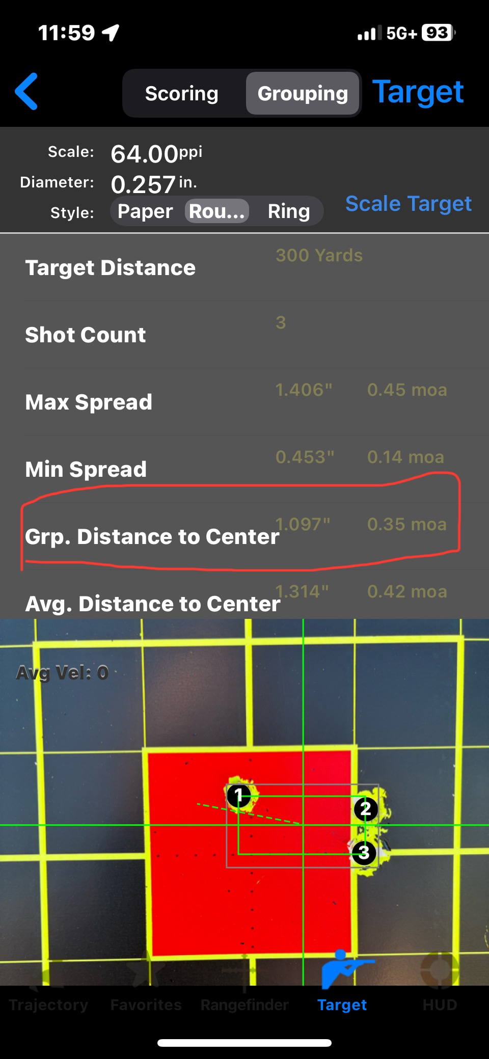

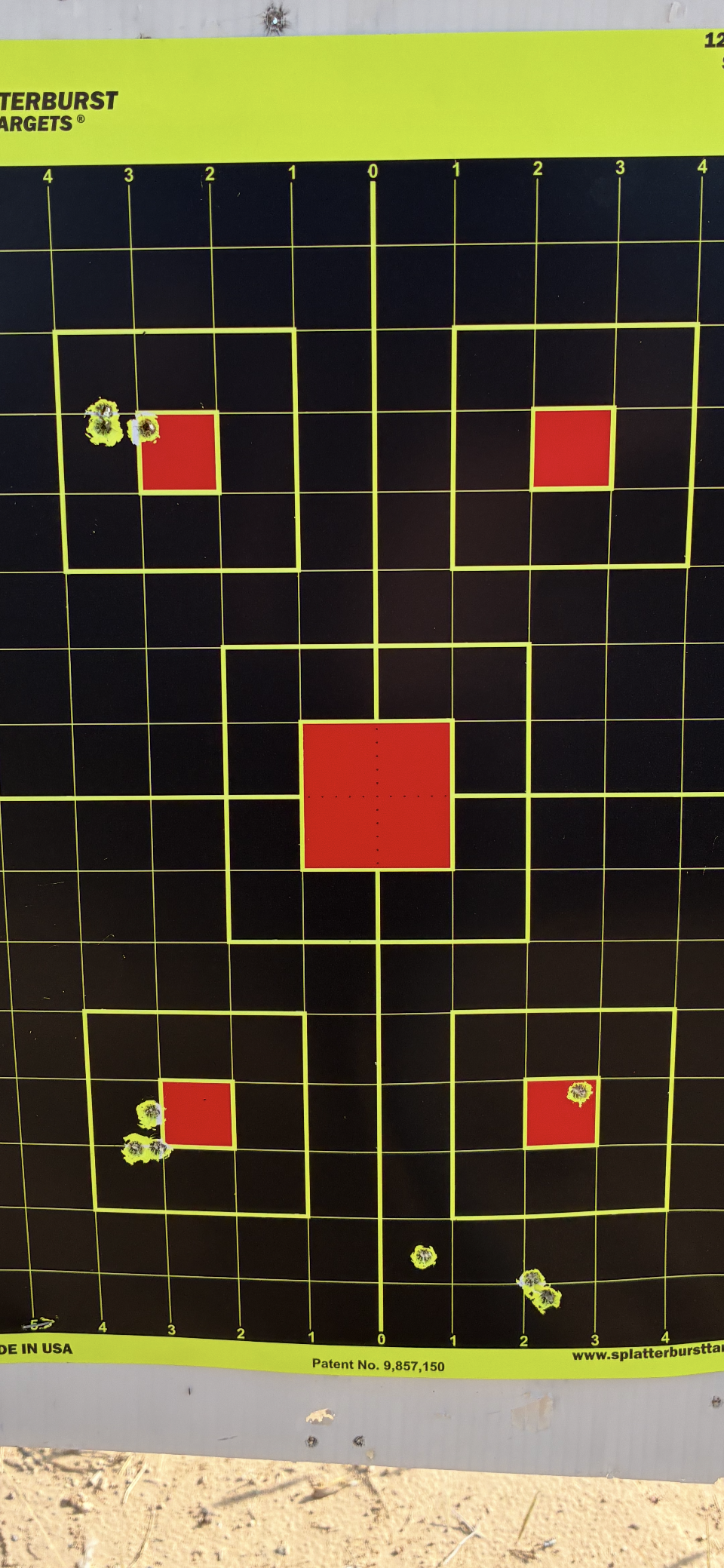

41.0 gr of H4350 and some Berger 133s at 200 yards just now. Bottom right was with a magneto speed bayonet on the end of the barrel. Obviously the Gun didn’t like that at all! I took it off and then shot the next two groups over on the left side.
