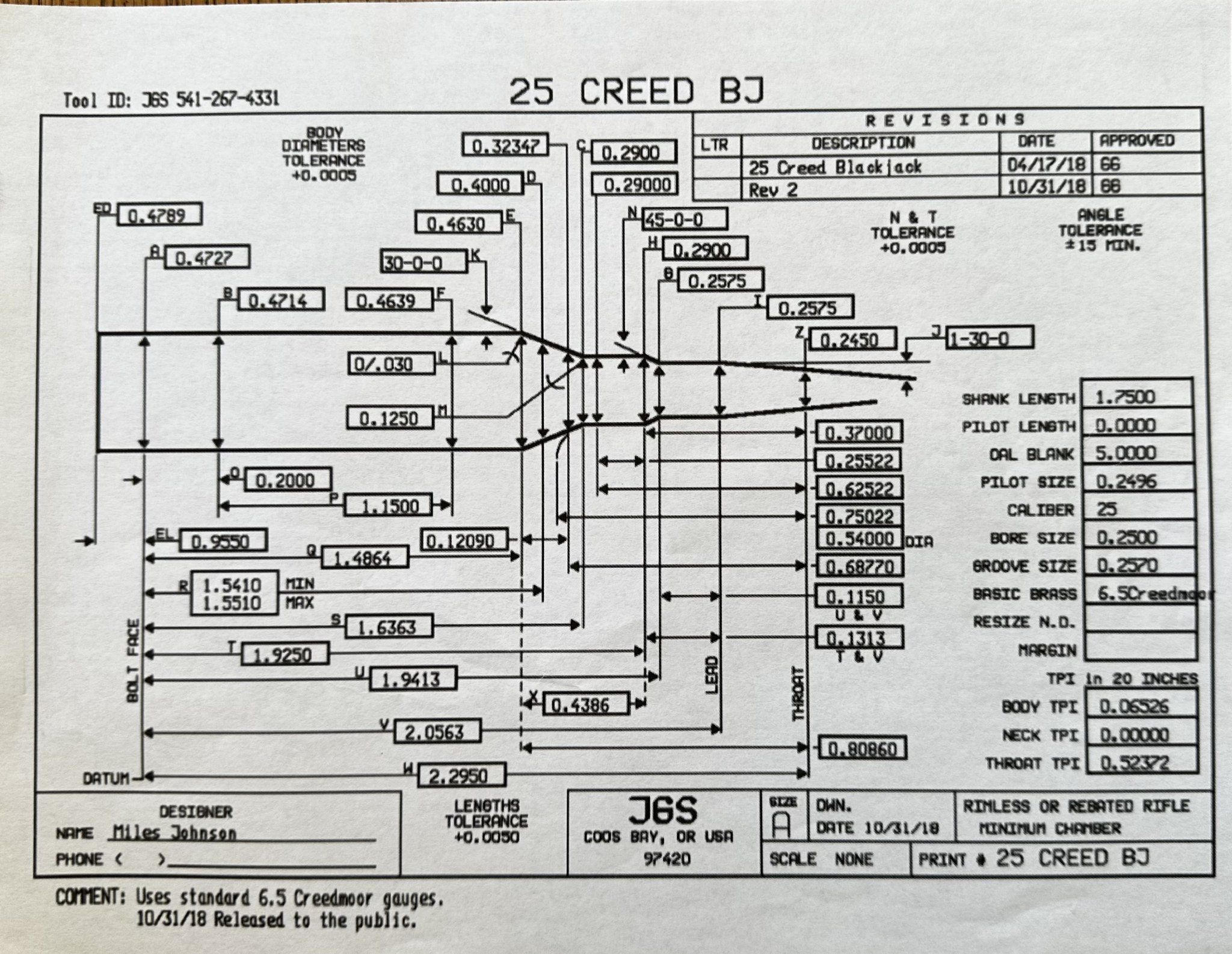

    I’m helping a friend of mine that wants to build a 25cm and am trying to find the neck measurement of Alpha 25creed brass loaded with Berger 135s. If anyone has or can get those numbers it would be appreciated.
    I am also trying to track down reamer prints of what I believe is the 3rd and final reamer print that blackjack put out before they went under. If I’m wrong on that please correct me. I have read where there is a .115 freebore and a .130 freebore. I’ve only been able to locate the .115 freebore prints.

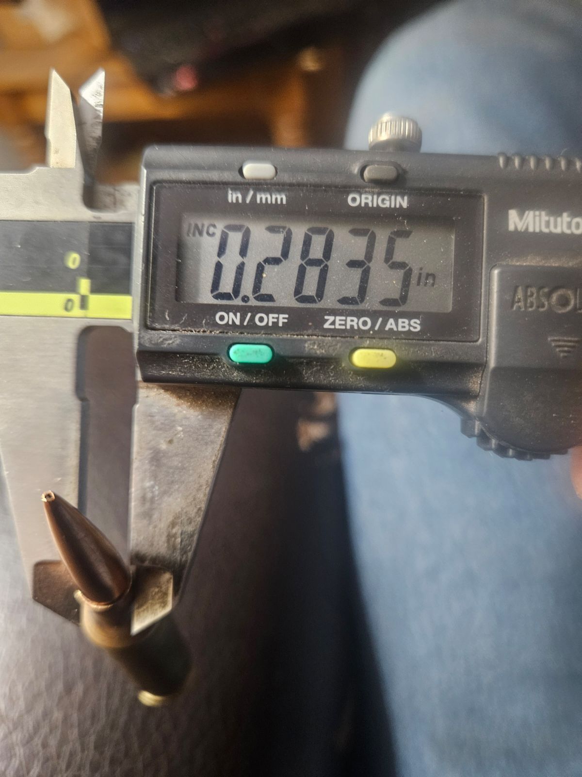

    I don't use alpha cases but this one was mixed in with mine from a match. I resized it and stuck a bullet in it.

    I’ll get back to you but mine is .115 freebore and I think .288 neck, which will take any brass more than likely. I think its BJ’s version 2 reamer.

    Not sure what my freebore is but .115 seems short, I run the Hornady 134's at 2.913 COAL so my freebore must be way longer than
    .115. TScustoms spun the barrel for the Berger bullets but the Hornady bullets shoot excellent and are cheaper.

    I get the same measurements as jpcowboy above, and I run 41.9grs H4350 with a 135 Berger to get 2890 FPS from a 25" barrel. I also always shoot suppressed. It's a fun cartridge for sure, and it does have a slight advantage over the 6.5mm offerings. But mostly I shoot one because I can and why not?!

    I get .283+- .0005 in Alpha 25 with the Berger 135s. I get the same in necked down Lapua 6.5 Creed with the Bergers as well. SAC die. ELDMs are just a bit more..

    Just looked at my notes from the day I chambered my barrel. The 131’s touched at an OAL of 2.867. With 380 rounds on the barrel, the 135’s touched at 2.857.
    @sierracharlie338
    I was wrong, .290 neck.

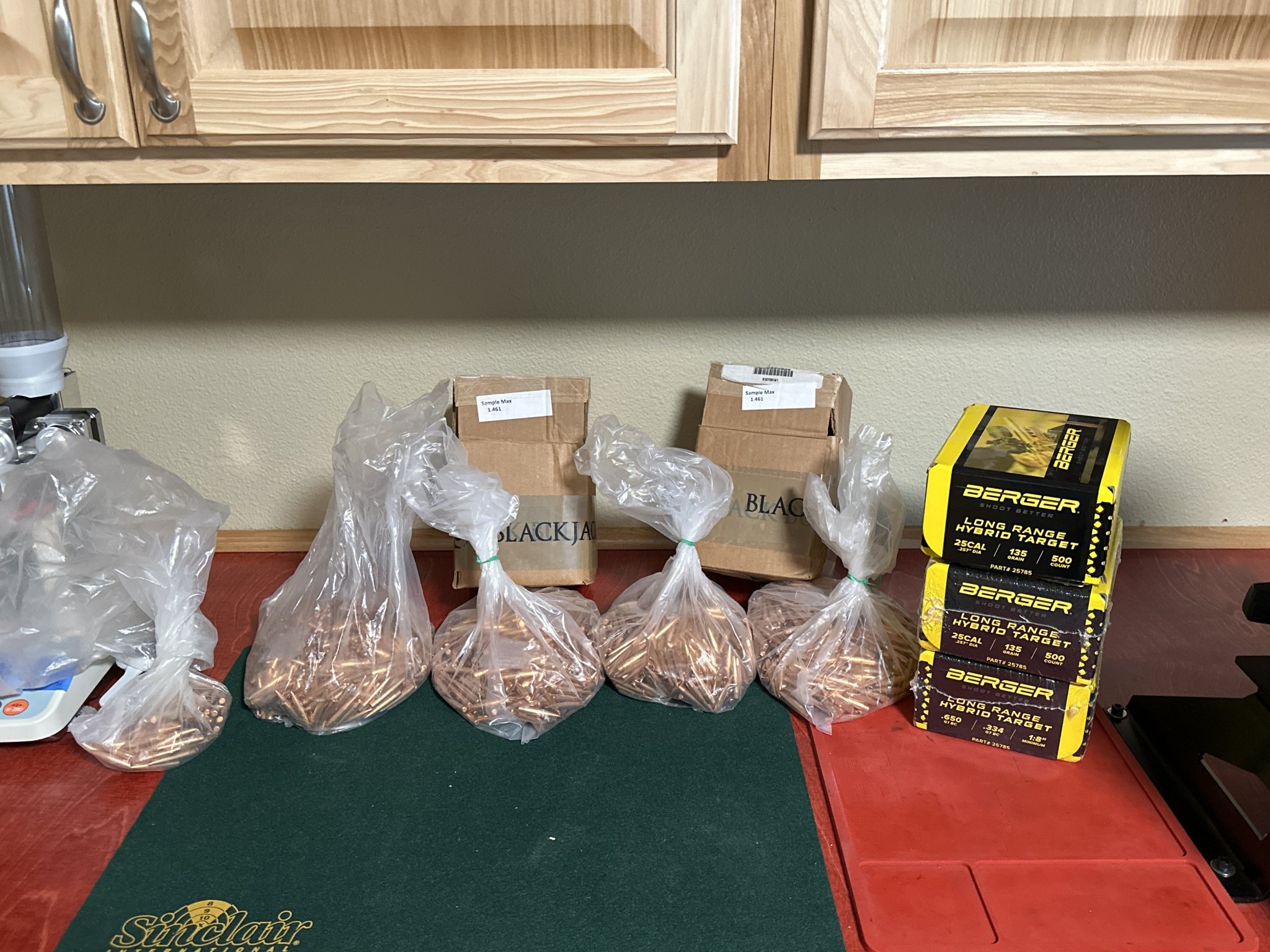

    Those four larger bags are actually the “XL” version they sold while that last sierra order was allegedly delayed. Theyre .020 longer in the bearing surface. Blems essentially. Shoot fine, bc seems to be there though. That nearly empty bag are the good ones. Maybe 100 left.
    He’s comparing to 6.5.

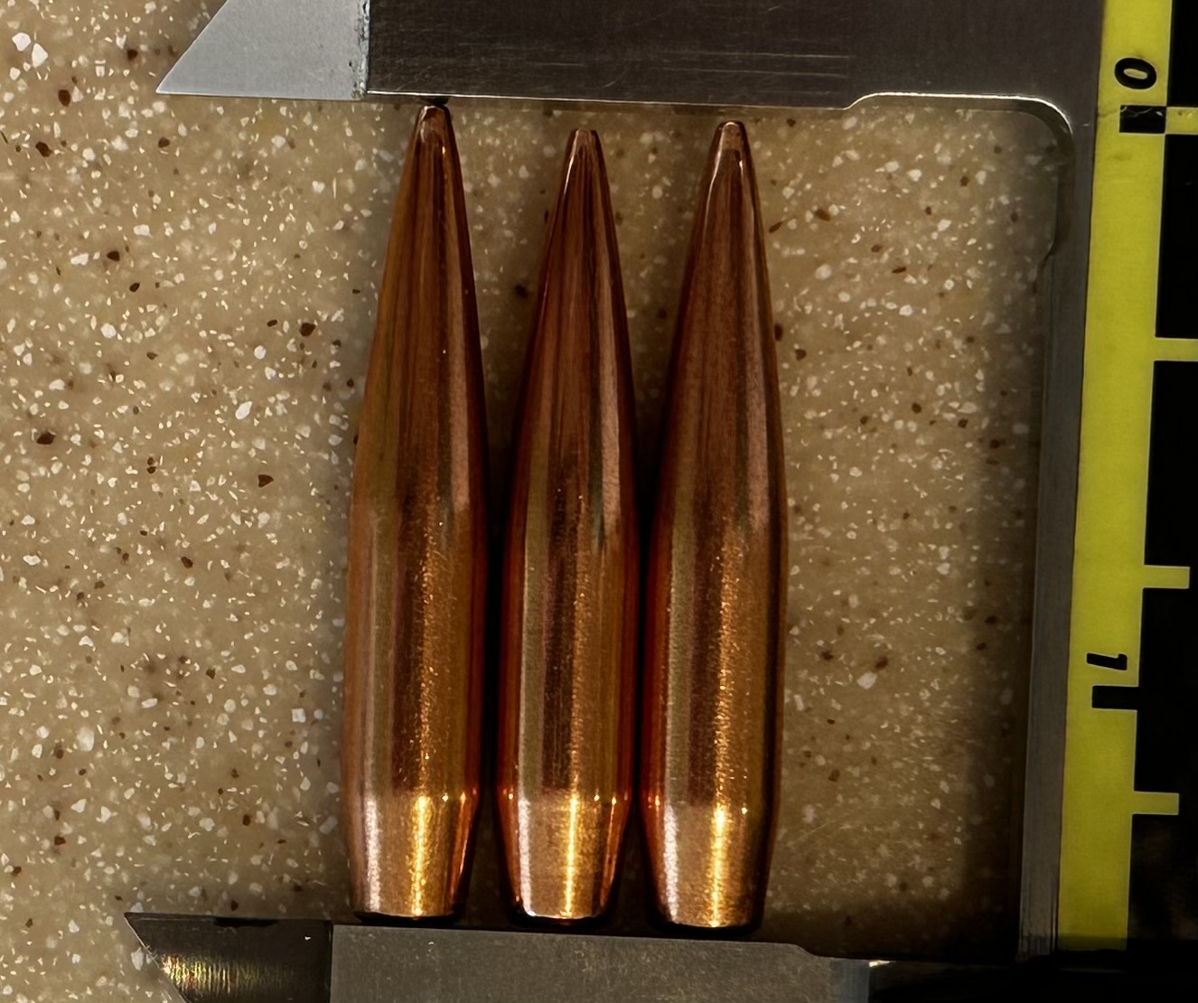

    What is the length of the blackjacks? My Bergers are 1.414 and ELDMs are 1.452.
    The base to ogive was taken with a 6mm comparator, so this dimension is long. Comparative measurement only.
    OAL BTO
    Berger 135 1.411 .782
    BJ 131 1.436 .778
    BJ 131 XL 1.451 .797

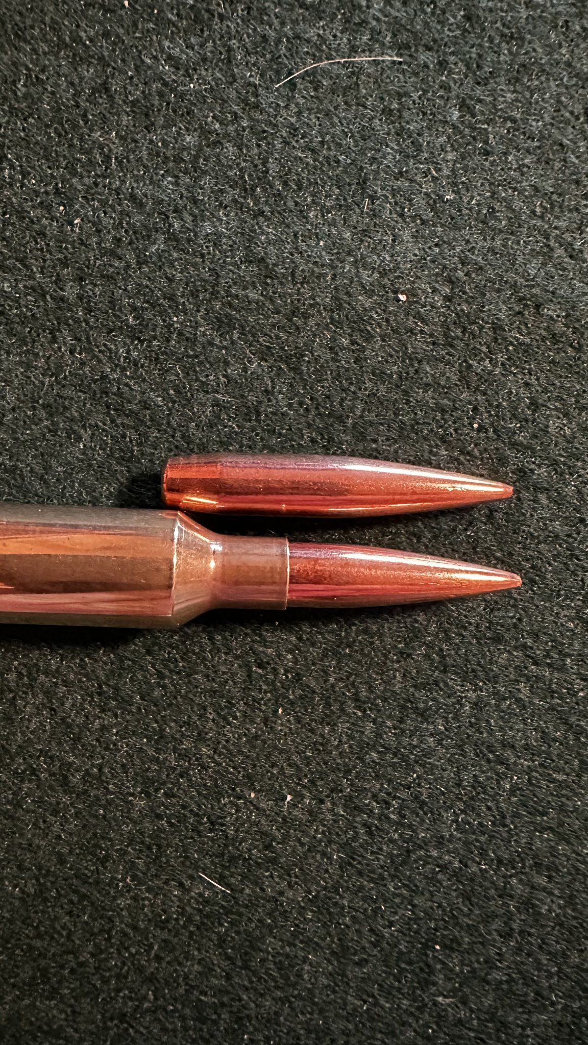

    Its kinda weird. I initially thought the berger would just be a fatter bullet. So I used a blade mic to measure the bearing surface diameters carefully. My bergers are more slender than the 131 throughout their entire bearing surface length. Both bullets taper up from the ogive to just above the boat tail. Both have a pressure ring at the boat tail, the 131 is larger there.
    It should be the 131 that pressures more. 🤷‍♂️
    @sierracharlie338 i forgot to add a pic to the above post. Its there now.

    It’s weird how only 4 grains one direction or the other is making that much of a difference.
    Berger 135 in the middle, flanked by the 131 XL on the left and regular 131 on the right.
    Hard to see in the pics but the BJ meplats are very pointed. Much more so than the berger.View attachment 8250319

    You likely don't have the xl’s. They came way way into the dry spell. Like a year in.
    OAL BTO
    BJ 131 1.436 .778
