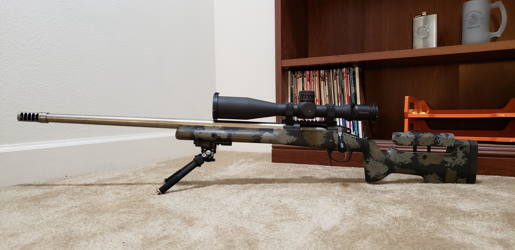

This thread is to discuss the 25 Creedmoor wildcat utilizing the 131gr Blackjack bullets and my observations during initial load development. I know there are many out there who have seen the Blackjack bullets and are considering getting a barrel chambered in 25 cal to utilize them. All items/parts/components purchased by myself for my own use, no endorsement implied. Load data for my rifle and my rifle alone, use with caution
My rifle:
Action: Bighorn TL3 Left Handed
Barrel: Krieger 25 Cal 1:7.25" Twist Blank - #17 Krieger Heavy Varmint Contour, finished at 26"
Chambering: TS Customs
Trigger: Bix'n Andy Tacsport
Stock: Manners T4A with mini-chassis
Optic: Premier 5-25x56, Gen2XR Reticle
Assembly: Myself utilizing the Short Action Customs modular barrel vice
Brass: Alpha Munitions, 6.5 Creedmoor SRP brass necked down to 25 Cal (0.283 bushing)
Dies: Redding Type S
Scale: FX-120i w/ autotrickler and Area 419 upgrades
Press: Forster Co-Ax
Chronograph: LabRadar

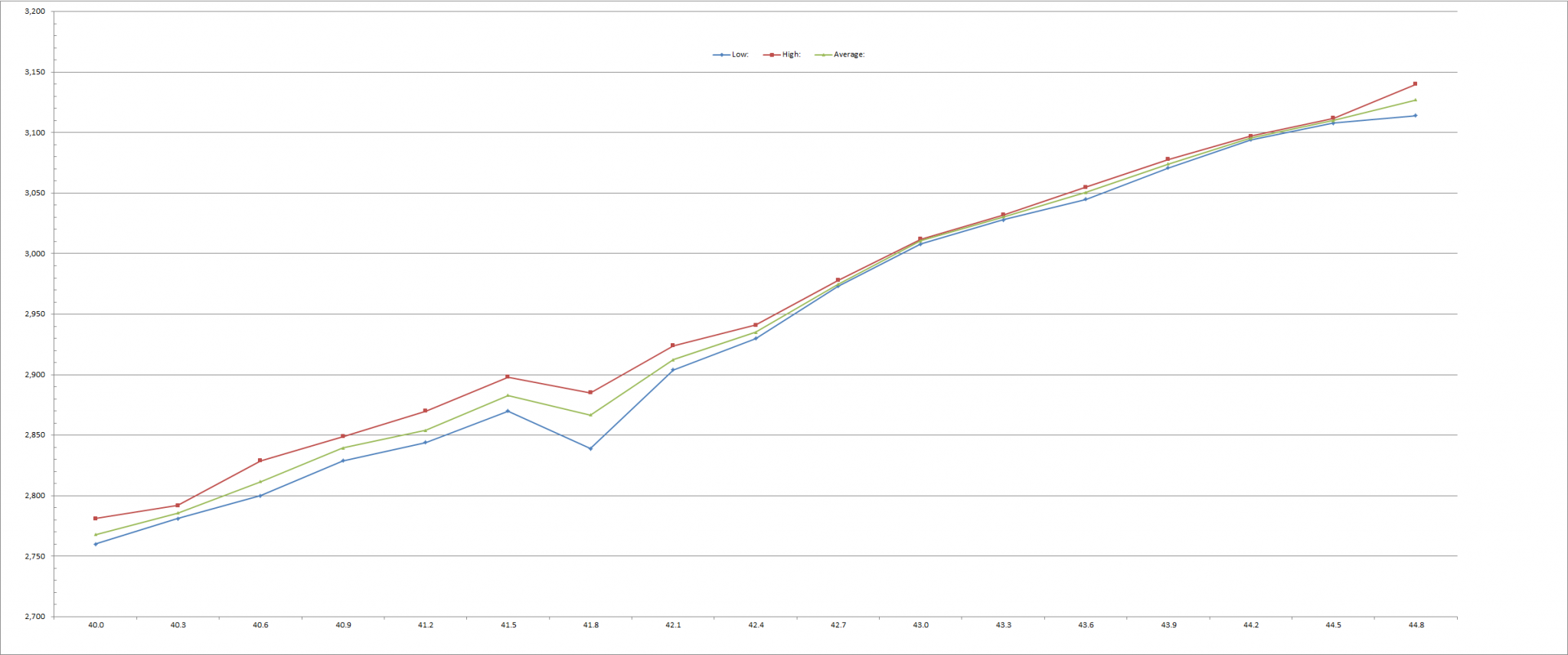

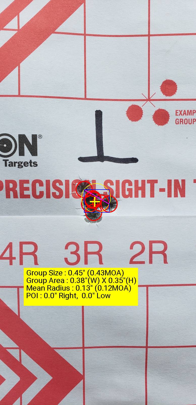

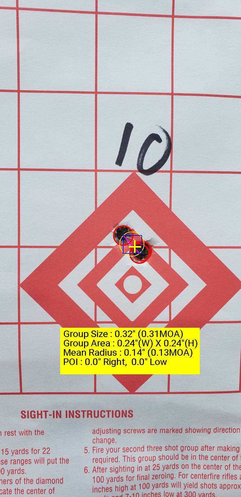

Major observations:
-This bullet is very easy to tune. Loaded up to 0.020" off the lands and had excellent results. Group 1 in the pictures is shots 2 through 7 down the new barrel. I cleaned the rifle after string 6 in the chart, which is what I believe led to the drop in velocity in the barrel.
-This cartridge prefers to have a full case capacity. Once I hit 42.2 grains of H4350, my extreme spread began to decrease considerably.
-Nearly zero felt recoil below 3000 FPS (it felt like i was shooting a 22LR). Granted, my rifle is 16 pounds, but for competitions I'd probably run the rifle at ~41.0gr for an easy 2850 FPS with zero recoil and nearly infinite brass life. (this velocity puts the round going subsonic at ~1375 yards)
-MAX LOAD: 44.8gr (Had to mortar tube open my bolt, however primers were not flattened)

Great write up! You added several more data points to my own research. I have simply noticed over the years that cartridges seem to be the most tunable right around 2% off the point where pressure appears. 2% off seems to always be in the immediate area of the sweet spot.
You started hitting pressure at about 44 grains, and 2% off would be 43.1 grains.
At 42.7 grains your SD dropped to 2.89 and your fps per 0.1 grain was 13 fps.
At 43 grains your SD was 2.31 and your fps per 0.1 grains was 12 fps.
At 43.3 grains your SD was 2.08, but your fps per 0.1 grains dropped to 7 fps and stayed low on out.
So, at this seating depth, your load hit maximum efficiency of the burn rate at 43.3 grains. The group opened up just slightly, but could probably be tweaked just a couple of thousandths to tighten it back up. So my prediction would have been 43.1 grains and actual was 43.3 grains.

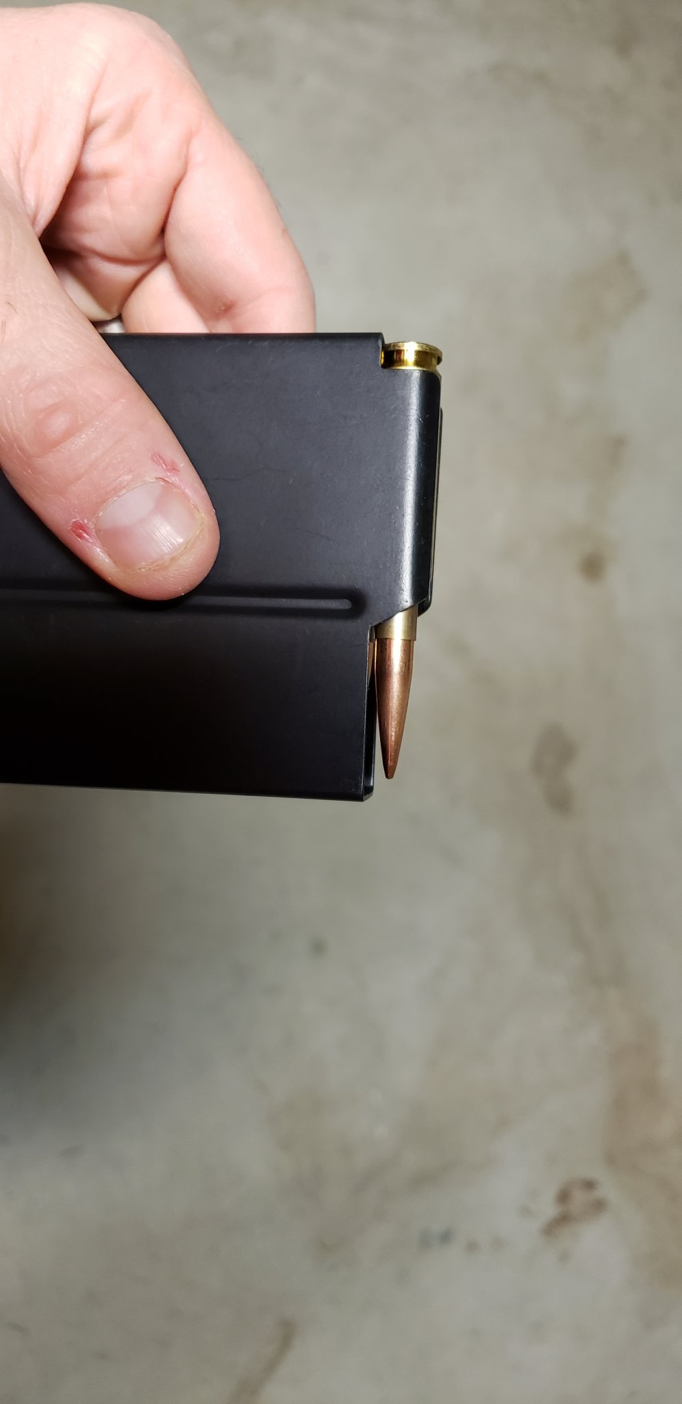

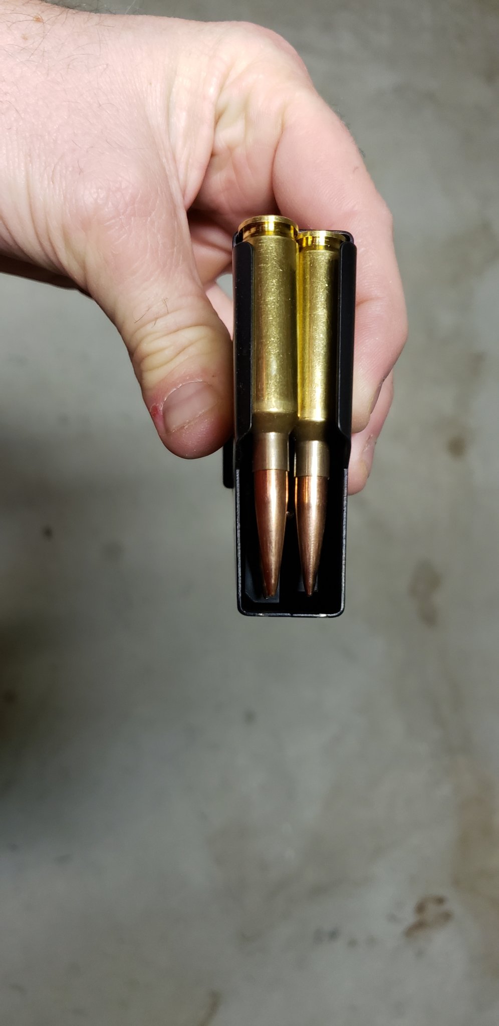

Thank you. Just wondering if it will work in an AI mag or if it requires a something similar to an accurate mag that allows up to a 2.94 coal.
I was running these in an AI AX doublestack mag.
Just curious, but is there enough room to seat the bullets out a little further in your AX mag if you have to chase the lands? At your current seating depth, does that put the bullet above the neck/shoulder junction? I'm having a 25 Creedmoor barrel chambered for my Desert Tech and I have some room in the DT mags, to seat the bullets a little long, but I figured I'd ask before jumping into a prefit for my Bighorn as well.
I've got quite a bit of space to run longer in my AX mag. Max internal close to 2.980, my rounds at 2.841.

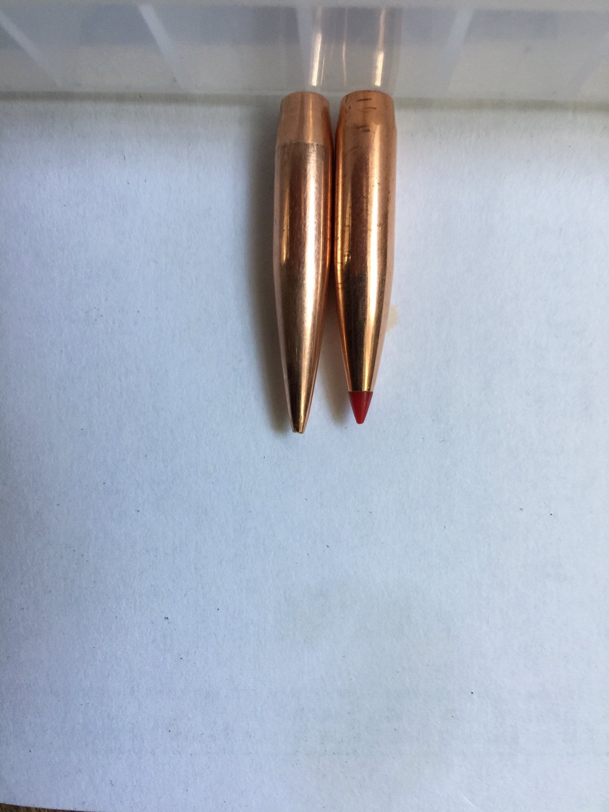

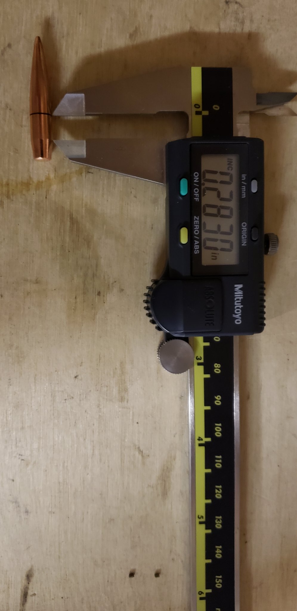

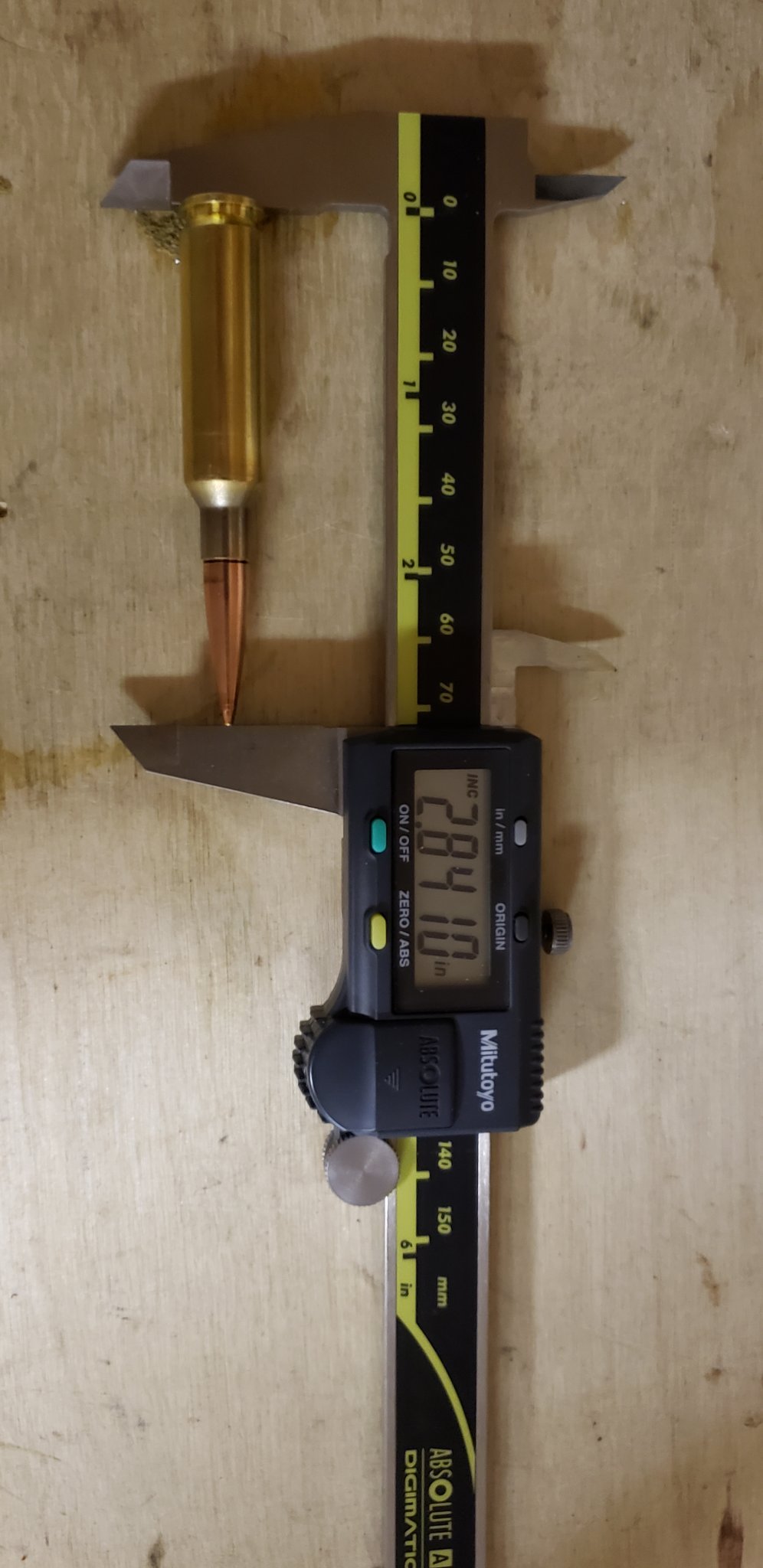

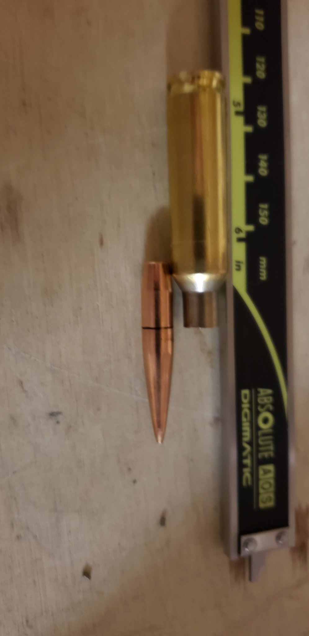

Not to threadjack, but I received my order of the 131s. They are extremely long. 131 on the left next to a 140 ELDM. I weighed a random handful on my FX120i and the twenty or so were fairly consistent at 130.98 grains. A few at 131 even, a few at 130.96. My 25 cal comparator insert hadn't arrived in the mail yet, so I couldn't measure base to ogive, but lengths were very consistent at 1.415".
I forgot to ask in my previous post. At a coal or 2.841, where is the bullets bearing/boat tail junction in relation to the neck/shoulder of the case? Is it still above or below the case neck/shoulder?
I'll get some more data/pics when I get home.
I've got what you're looking for.
COAL: 2.841
Alpha 6.5 Creed Brass neck length after sizing: ~0.2745
Bullet bearing/boat tail length seated: 0.2830
Attached pics so you can see what I'm talking about. I've got a little wiggle room to load longer if needed. I've always been told that you want the bearing surface to be as long as the caliber is in diameter.

In virgin Peterson brass sized with a .281 bushing and a 28” Bartlein I was not getting any gains with R26 compared to H4350. I will have slightly more case capacity in fire formed brass but it doesn’t appear to be as advantageous as in a 6.5CM
Reactions: BLKWLFK9
I see you're using Redding type S die with a .283 bushing. What seating die are you using? Can you just use a 6 or 6.5 seating die for these? Pardon the noob question
Yes, the seating die is just the 6 or 6.5 seater on these. You can get a 25 cal seating stem sometimes for your die, but from BlackJack's recommendation, it's not necessary.
