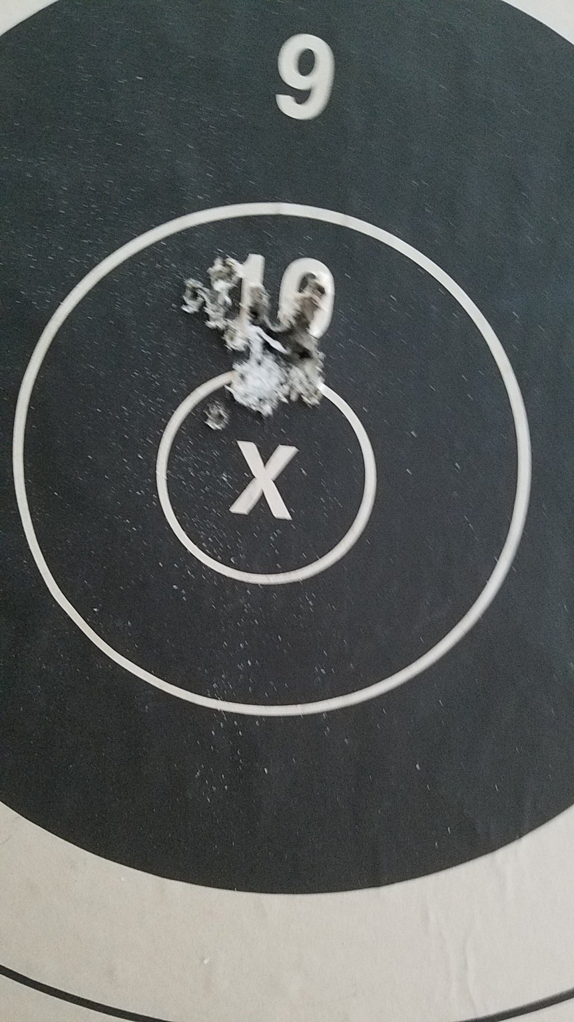

    For reference. This is 20 shots. 10 different charge weights. 200y. Not much spread

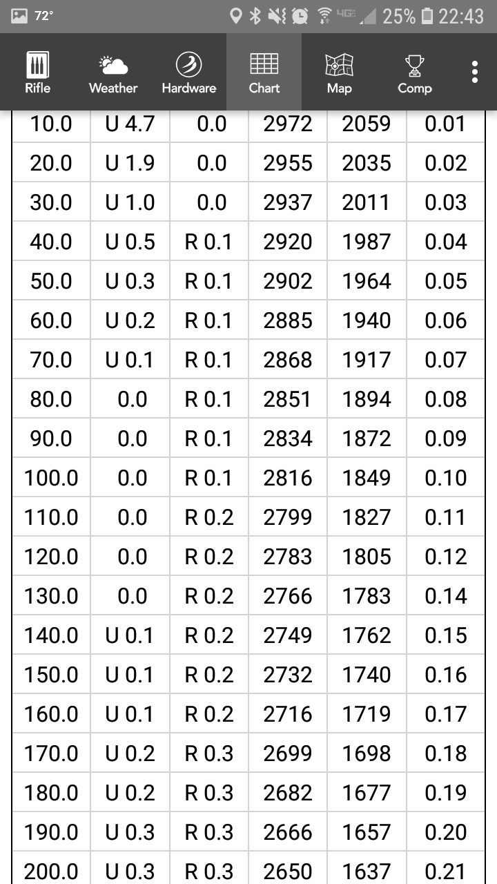

    I would never try and move a 25y zero to 100y zero based on ballistics calc. There's some funky stuff going on inside 100y
    200y
    I would true the zero once there but I see what you mean.
