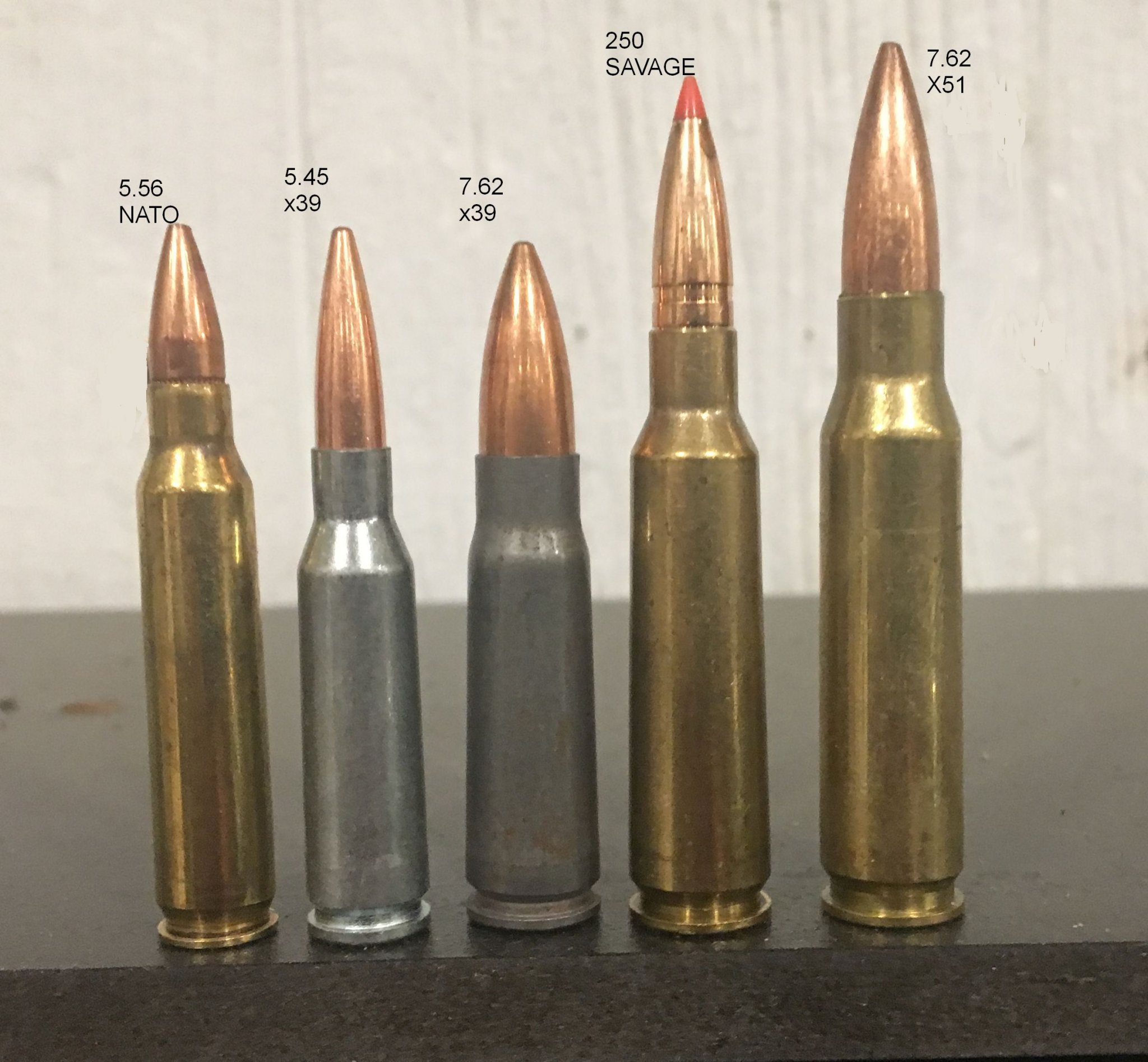

I figured with its case dimensions it could be very efficient case. So far looking at my data it really is.
Now with some serious long bullets coming out it's really getting interesting.

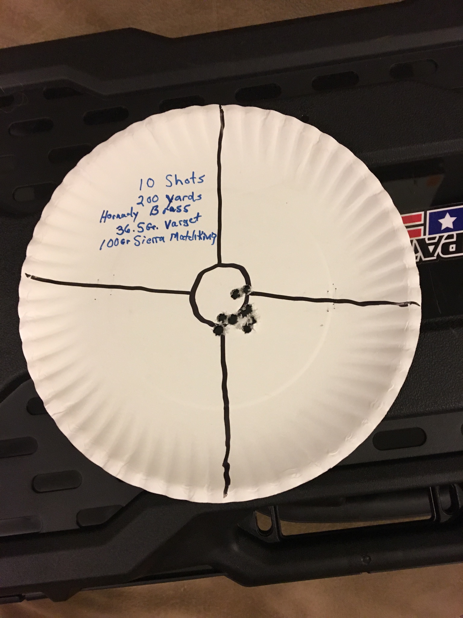

Action savage 10 stagger feed, barrel is a E.R. Shaw 1:10 twist. It shoots 100gr MK's into 1/2" all day long
Oh that load is 36.5grs of varget and it avg's 3050 FPS!!!!!
This is my 3rd barrel from them and all have been damn accurate.

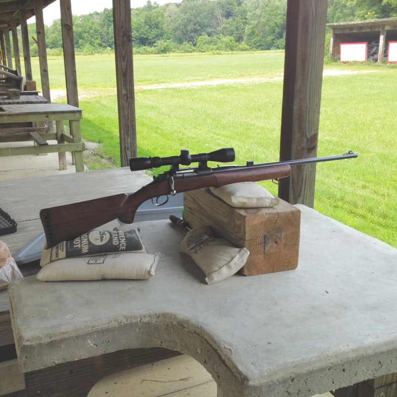

also as i stated above my 250 savage hunting rifle is a savage 1920 bolt action which is based on the 1903 springfield and the mauser 98, its also the first short action bolt action i might add. looking back thru savage history youll find many firsts. oh sierra has a 90gr BTHP that is very accurate with the 1:14 twist thats hell on whitetails, and i just got some 90gr hornady GMX's to try also.
Ha! I never knew the Savage 1920 had a short action version. Another interesting tidbit about that action is it's all round, like the Rem 700. I should say vice-versa as the Remmy is like the Savage.
