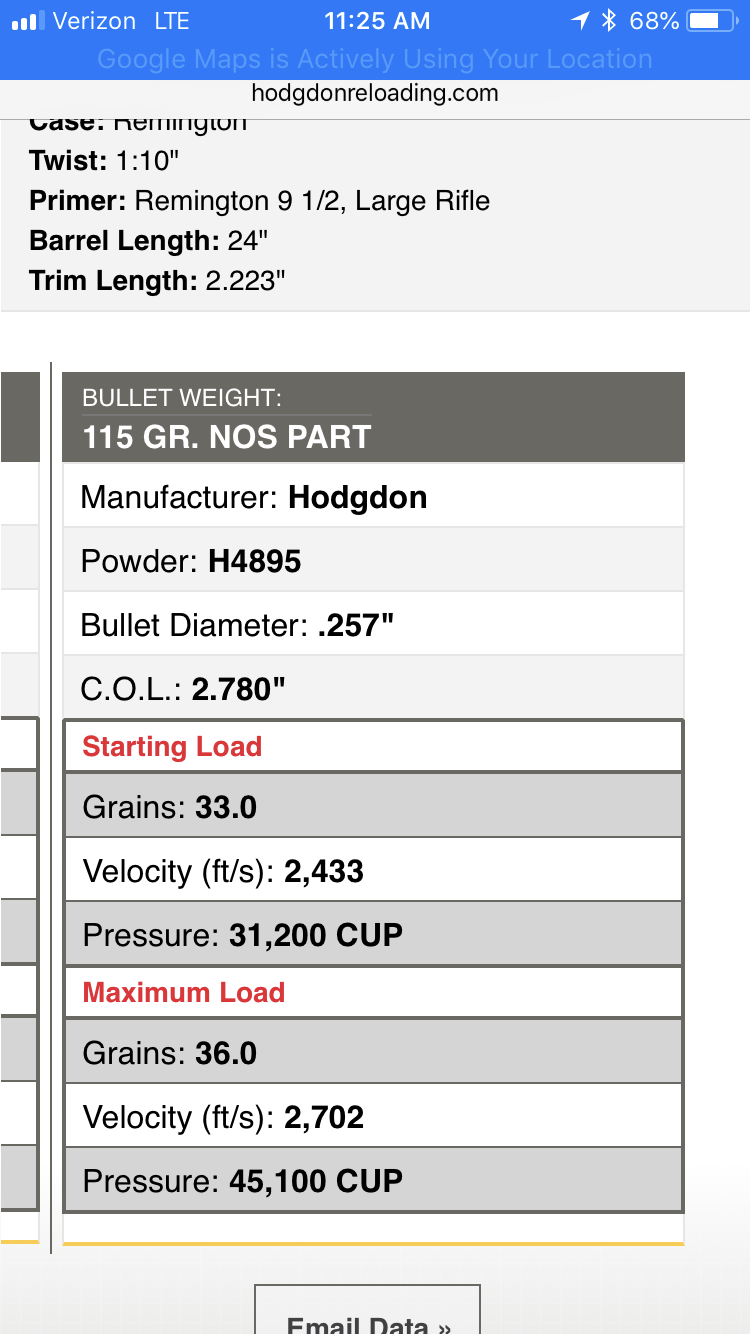

    I’ve always been a little curious why people choose a slower vs a faster burning powder. I have lots of 4895 and 4350 on my shelf, so I am hoping someone can look at the two examples below from Hodgdons website and tell me what powder you would choose and why. Good to do OCW with one of them.

    In your example with a 115 the 4895 is 36 grains leads to 45k cup, drop that down to 33gr and its only 31k cup. Thats a big up swing in pressure. With the 4350 youre using 7gr more powder and only getting 44k cup at max, less pressure, and the low charge is 2 gr less but only 4k less pressure. That tells me that its not spiking up as much, a more even curve.
