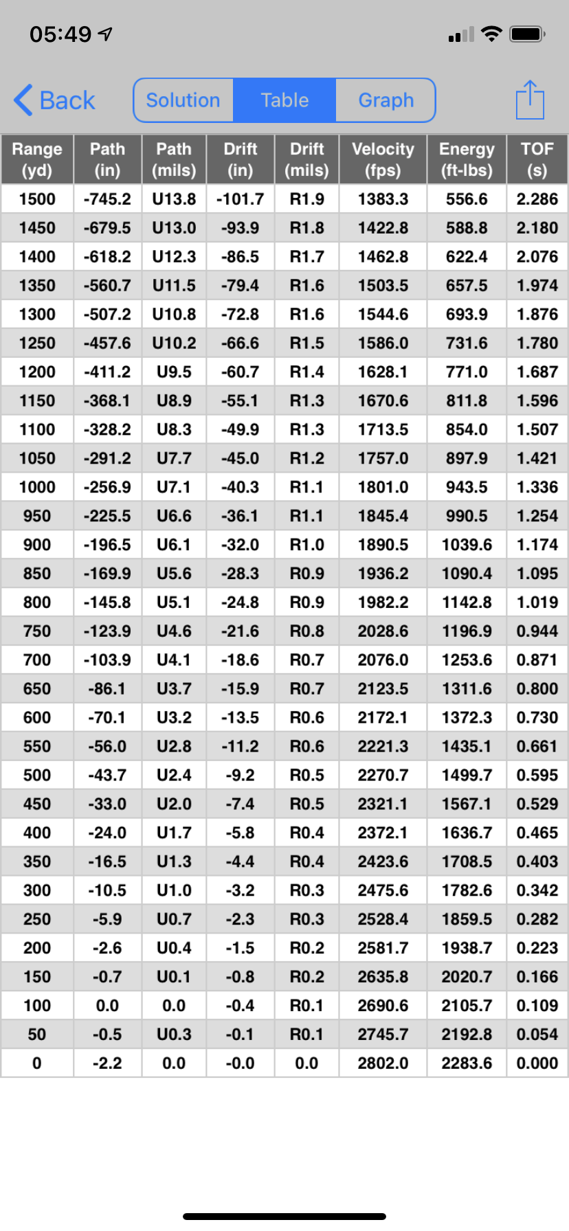

Drop table from the match yesterday.

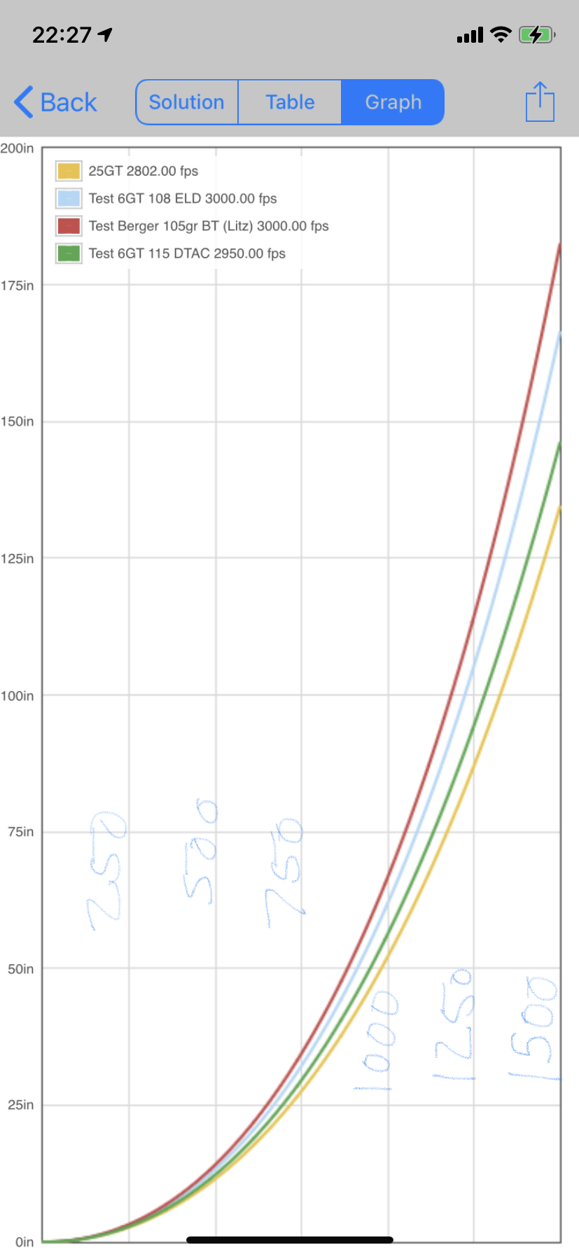

After running some numbers it turned out the 2800 mark actually matches the 6GT DTAC (for wind) pretty close and beats the Berger 105/and 108 ELD-M at 1000 and beyond for drift. (Using generic 6 data vs. actual 131 data .335 G7) I agree not a lot of benefit inside of 700. Shooting in the match this weekend it was definitely an asset in the wind as the only other round besides the 25GT to hit 1200 was a 6BR. As noted increased splash is definitely a perk at 1000 and beyond in damp dirt. I’d love to shoot it against a well developed 6GT to compare actual performance but haven’t had the chance yet. I’ve included a shooter drift comparison out to 1500 with a 270 wind at 10mph. The 6 info is generic. DA 7500. Don’t have any 109 data

Took the 25 GT out yesterday to stretch it out. Shot at 1500 and 1940. It was amazing at 1500 yards, missed with first round and then 6 in a row. Almost like cheating.
we then moved back to 1940 yards. Here it was kinda rough. Group opened up to 2+ mils. This range was about 100 yards past transonic. I ended up reco the jacket from that one. (It was in between the strap and the steel. I’m not sure but it didn’t look like it went through strait but hard to tell with the fire hose.
Watching the trace at 1500 (couldn’t see it at 1940) was hilarious. It would disappear out of the field of view and then drop back in just prior to impact.
muzzle velocity 2803 FPS
SD 8.2
ES 15
Station pressure 23.87
Temp 41
Winds 11-1 o’clock at 6-9 mph
1940 yards
1602 inch drop
23.4 mils
Time of flight 3.188
Impact velocity 1047
Energy 319 ft/lbs
Transonic between 1800-1850
1500 yards
761 inch drop
14.2 mils
Time of flight 2.318
Impact Velocity 1346
Energy 527 ft/lbs

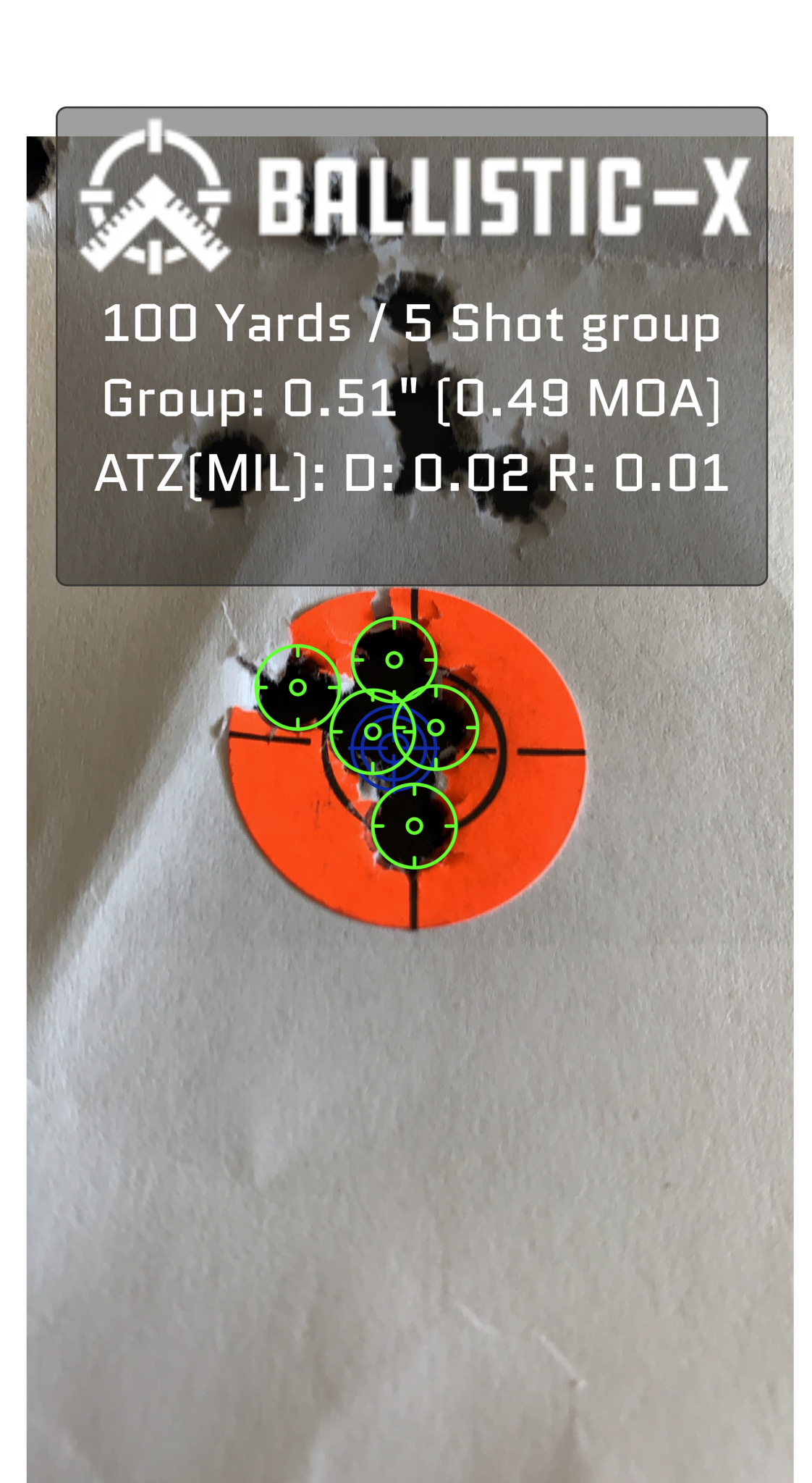

My buddy put a group down for me during a chrono session on my first batch of once fired brass. ES of 5 and SD of 2.2. Avg of 2798.

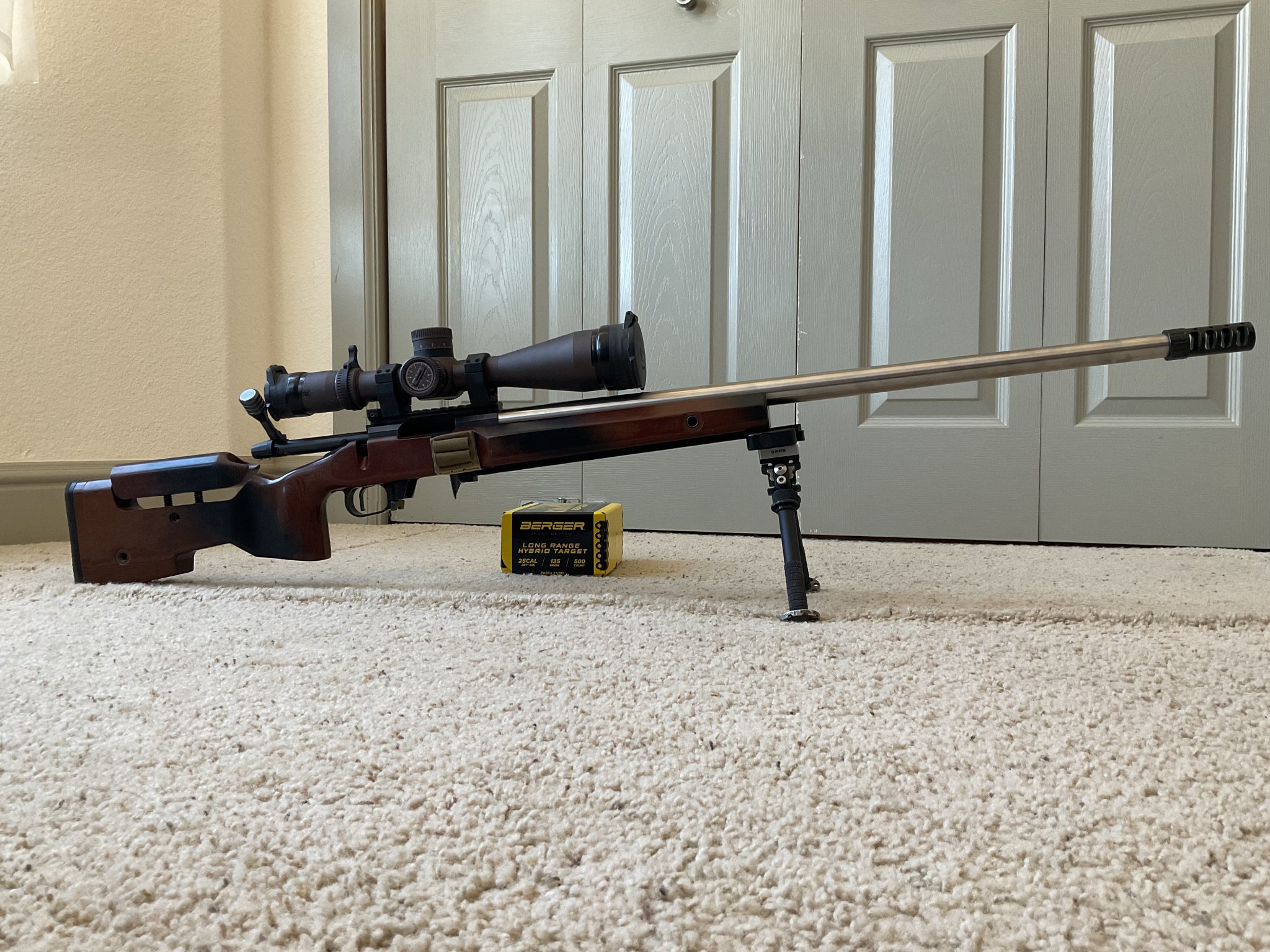

this is how it is sitting now.
24 pounds empty
Impact action
28” bartlien 5r
vortex gen III 6-36
vortex Precision Machined Rings
foundation centurion
trigger tech diamond
hawkins M5 bottom metal
ACE muzzle brake

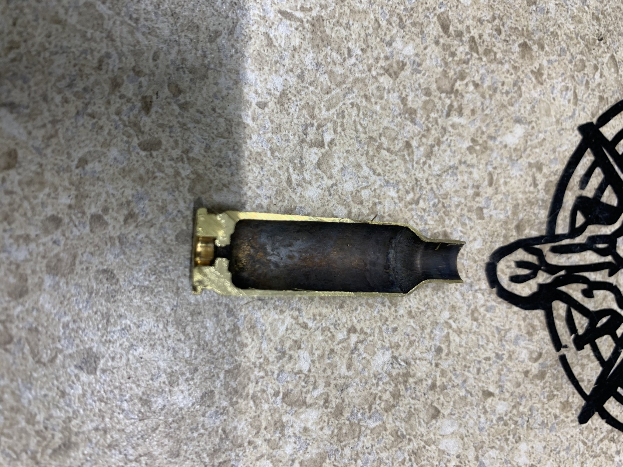

So bad news on the 25 GT front. Me and the cartridge are on the outs. Ever since I have switched to the Berger 135s I have been fighting pressure signs. Stiff bolt lift, ejector swipe, the works. I have downloaded it to 2750 fps, the bc has dropped to .320 G7. So the advantage of the slow high bc bullet over the 6mm’s is gone. There is a chance i have developed a carbon ring, and am planning on checking the throat soon. The barrrel is currently sitting at 2,073 rounds. Of which about are 800 have been working the bedgers.
my current load: 36.8 H4350, Berger 135, gap brass (5x fired annealed after 4), cci 450, .007 off the lands. impact Action, BartLein barrel.
