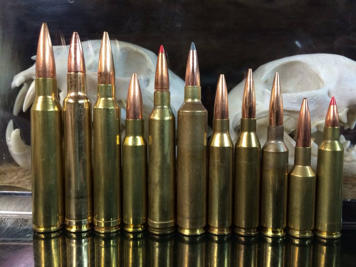

Nice size cartridge. I used QuickDesign to make variants from .243 to .458. Very cool ballistics on every caliber.
243 is a little ridiculous.
257 is just weird
264 is a 26 Nosler
277 would be very cool if that is your favorite. Faster then a Wby270
284 would scream with any bullet
308 while there are plenty, is faster than a WM but slower than a RUM nice size/speed
323/8mm IMHO really nice
338 seems to be right in there with a Lapua Magnum for Hdy 250 SP
358 now we are getting in to real whollop land
375 Faster than a Ruger slower than a RUM but pretty cool
416 Seems to beat most established offerings
458 Totally ridiculous and very practical
257 is just weird
264 is a 26 Nosler
70 degree shoulder, first ive ever heard of one that steep. the 338 one sounds like it could be wicked.
I have a reamer, rcbs dies, go and no go, and a box of factory loaded ammo pictured......
May or may not be new pills for this medicine in the making.....

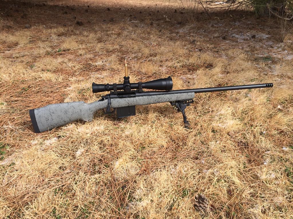

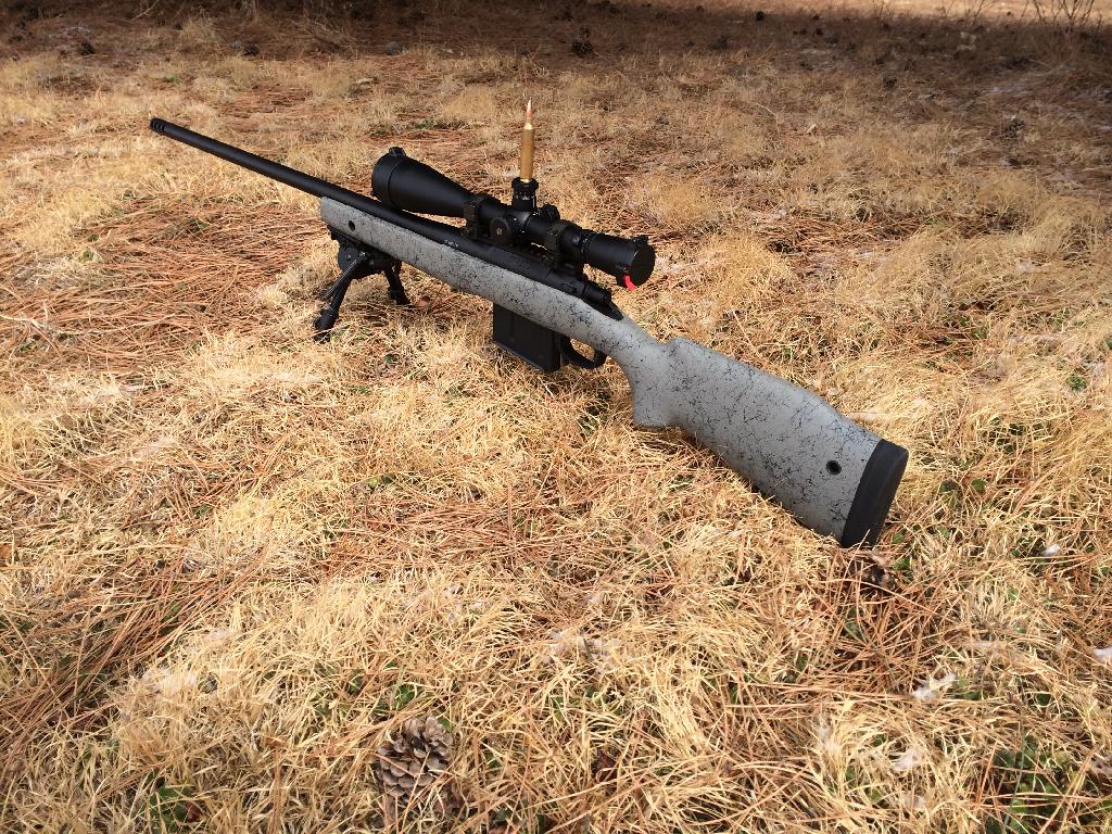

I have a 6.5 Bartlien 8.5 twist heavy palma I am considering installing on a Remington 700P in 300WM that doesn't get shot much..........Not really wanting to use that barrel so I have been looking for a couple others.
1491520_10152147583469099_851263846_o.jpgphoto-1.jpgScreen Shot 2014-02-06 at 7.06.31 PM.jpg
8 or 8.5 twist. 8 is what is suggested if I recall. I think 1,500 is fair with custom barrel and that may be lucky for some, but well doable with others.

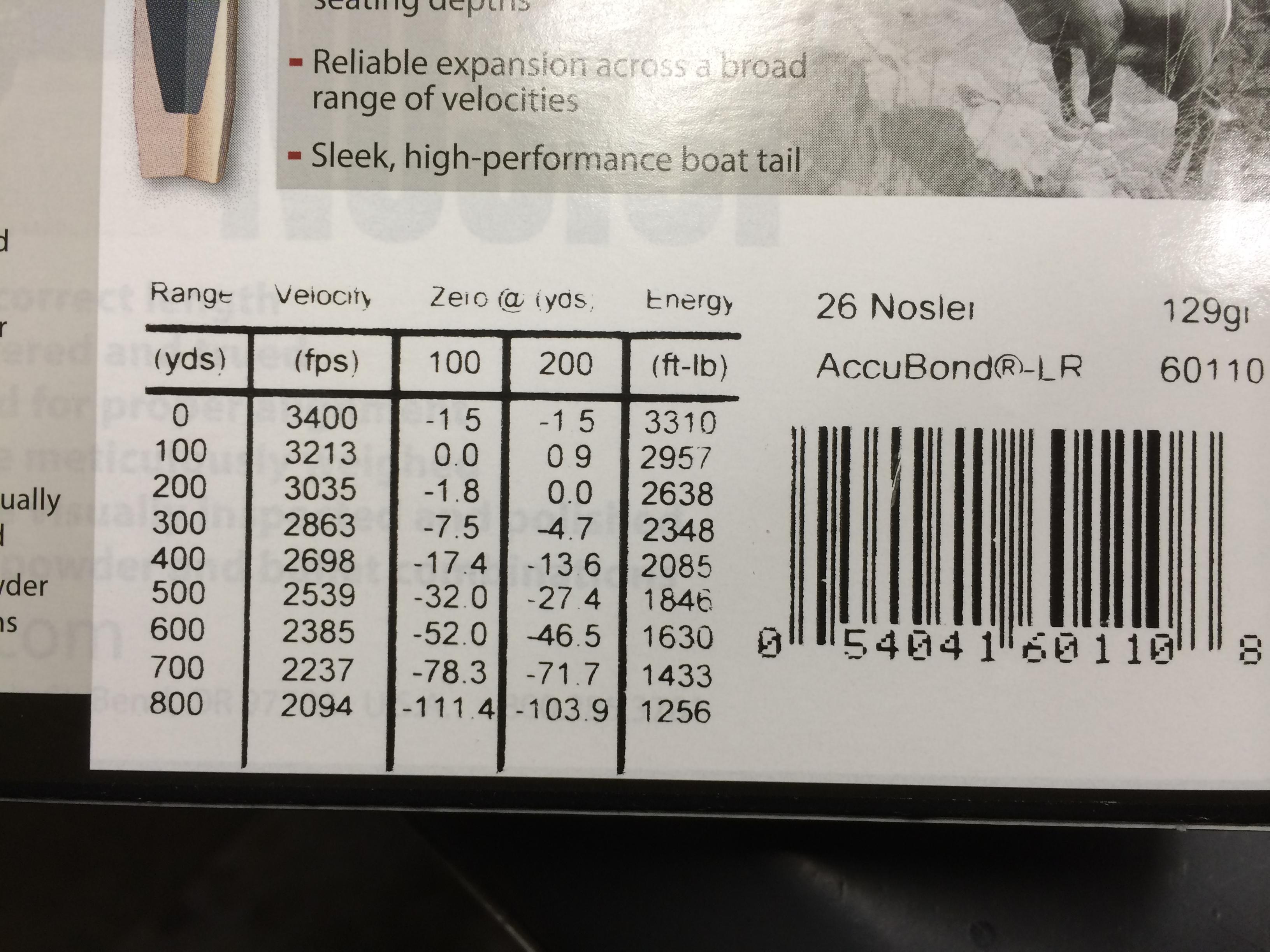

Factory 129gr ABLR20 rounds suppliedAdvertized 3400fps
20 rounds fired:ALL 20 rounds were fired using the Magnetospeed
Max FPS3351fps
Avg FPS3317fps
Min FPS3291fps
ES60
SD15
Results in grouping were poor, guessing the Magnetospeed was the majority of this.
