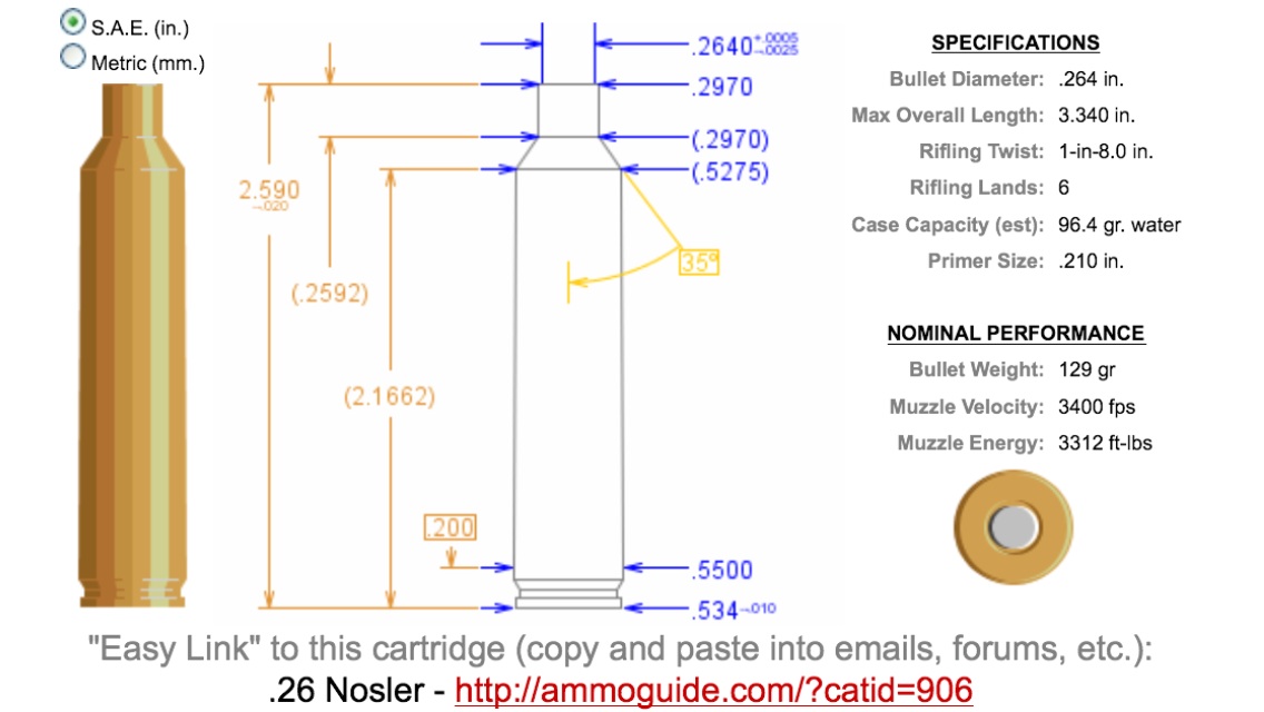

the 26 Nosler is not a 375 Ruger necked down !
it has been confirmed that it is based on the Rem Ultra Mag case shortened to 2.590"
