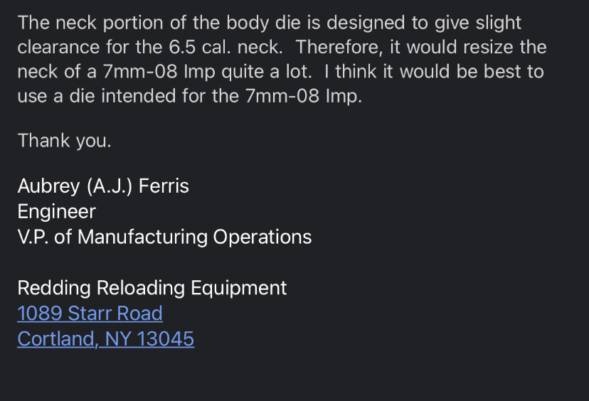

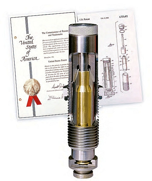

I will be starting with 7-08 brass, I didnt think abt enough room inside the redding body die for the larger neck. I did contact Redding couple days ago to ask but no response yet. However on lee’s website they did say that the ackley improved cases use same collet die as the parent case. So ig if all else fails I can collet neck size for first firing after fire form until I get a full length Ackley Improved die.

Do not use the 260ai die for 7-08ai. The hole in the die prior to the bushing is smaller than the one in the 7–08 die. Brass will never touch the bushing. Ask me how I know?? This was confirmed by Reading when I was having problems.

Thanks Redding just sent me a reply to my email this morning saying exactly what you said lol, Thanks guys!
