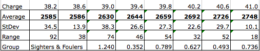

    .260 123 Nos & 2000MR
    I was able to shoot an OCW test with my new rifle today with 2000MR. The first 2 loads were used to break in and sight in. I think my next test will be 40.2-41.2 in .2 increments.
    Remington 700 SPS-.260-24" factory barrel
    XLR Element
    2000MR
    123 Nosler CC
    Wolf LR
    Nosler Brass
    2.8 OAL
    100 yards-3 rounds
    85 degrees
