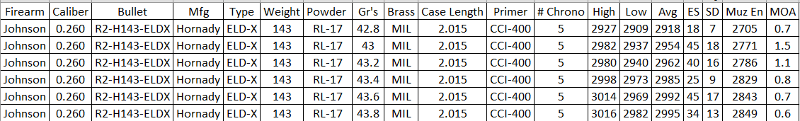

Here is the results with RL-17.
Both 43.6 and 43.8 had 1 round that shot hot as you can see in the high column. If I take that one out, the numbers drop to the below.
So I think I will choose 43.7 grs and that should keep me around the 2990fps range with a .6 MOA group. this is not where I thought this barrel would be as for accuracy but I guess it will do for right now.
