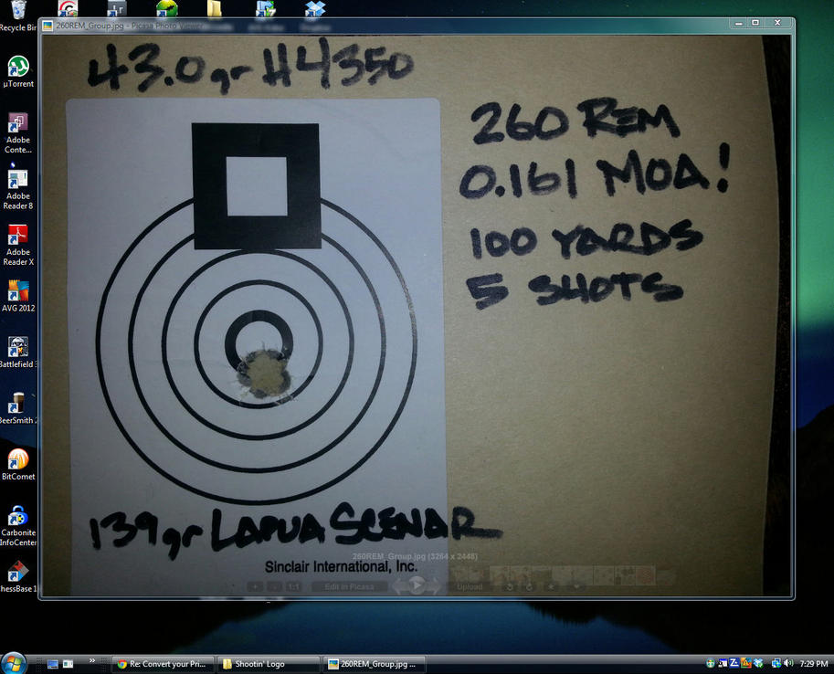

No chrono, just gonna go with most accurate load, which so far is 43g H4350 w/ 139's.
Hah! That's my load for my 260! OAL = 2.765" It's a little shorter than most folks seem to run 'em, but I like them to have plenty of room to breath in the mag. Here's my best group with it: Ryan's_Desktop.jpg
