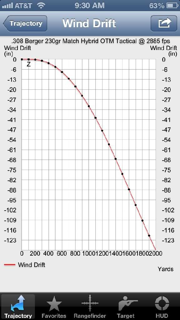

Here is a pretty damn accurate depiction of what the differences are in energy and things of that nature. These are REAL VELOCITIES that I shoot our of my own rifles. So far, every thing Ballistic :AE has predicted has been spot on.
The drift you see is a 10 mph wind at 9 o'clock. Also same atmospheric conditions.
Aimsmall what barrel length are you using to get that 230gr hog at 2885fps?

I push the 230 Berger at about 2850 with a 26" tube. Can't remember the exact number but 7.7 mils at 1000 yards (100 yd zero) seems like it. The 6.5 Creedmoor (very close to 260) is 8.5 mil at 1000 (2850 FPS with 142 SMK).
The thing about the 230 OTM is ability to stay "stable" into transsonic territory.
