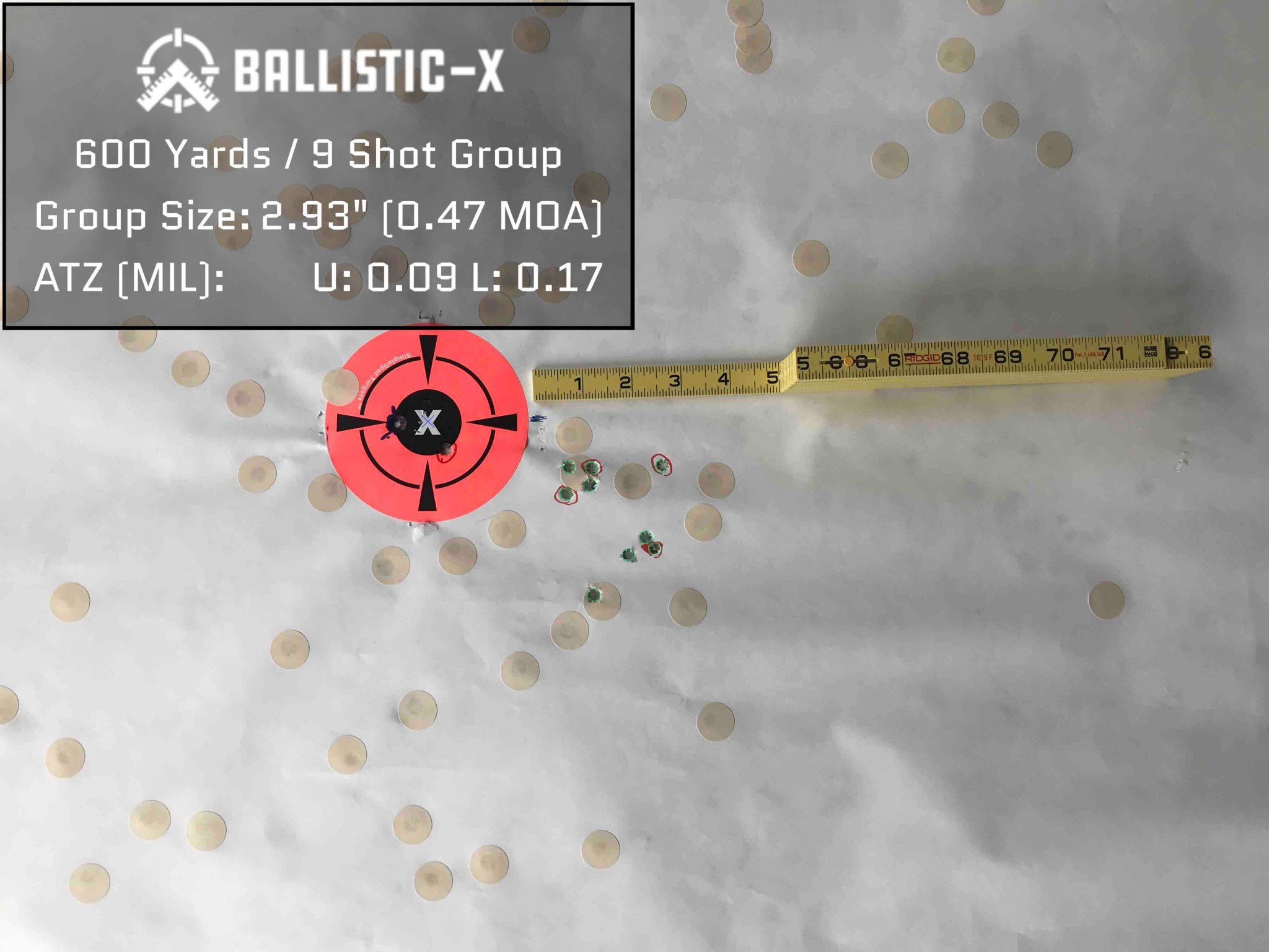

I run 44.4gr in my Tikka CTR with the same combo. 2.900” COL. Fits in the mag. Shoots 2” at 600.
started at 40.5. Worked up in 0.5gr increments. 43.5-44.5 shoots into the same group at 600 for my rifle. After some fine tuning inside that range 44.4 is the tightest shooting in my rifle.
5 shots of 43.7 and 4 shots of 44.4 into the same group.
