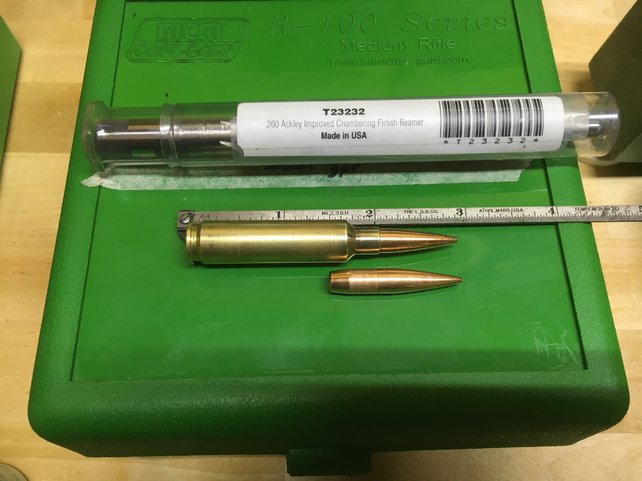

This is a 140vld set .010" off the lands in a .060" freebore chamber. They're seated pretty deep but I'm still at 2925fps out of a 27" barrel and they fit and feed out of my FN tbm mags. There is room to go faster but this is where the accuracy is. On draw back with the AI is getting them to feed. The shoulder is steep... my coned breach helps a lot though. I'm not sure I'd run it in a flat or stepped breach; not sure what the Howa has. When my last straight 260 barrel was at its peak, I was right at 2900 but not many run that fast and not trash brass

The howa has a stepped breach I believe. Feeding is something I really didn't think about. What kind of mv are people getting out of the creedmoor? The 30degree shoulder should feed well?
