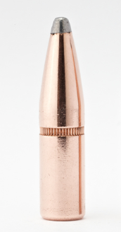

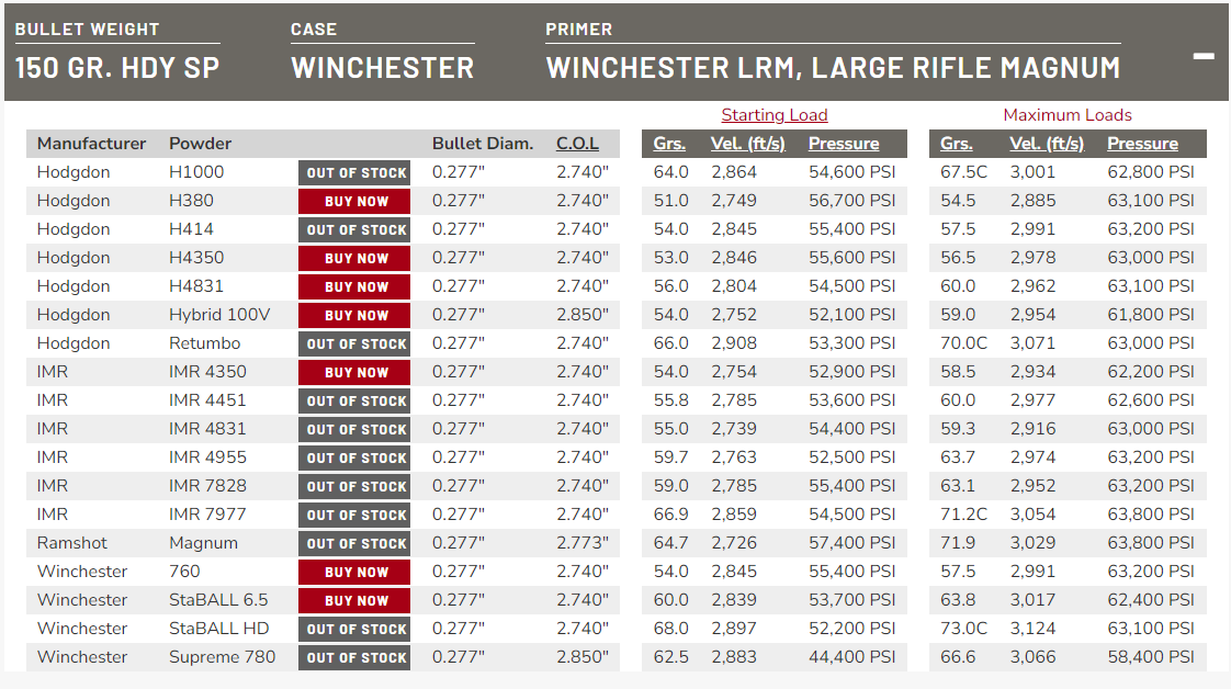

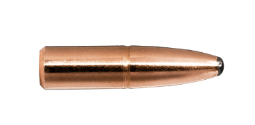

Here is the Norma 150 and the Hornady 150
Both have a similar base design and bearing lengths.

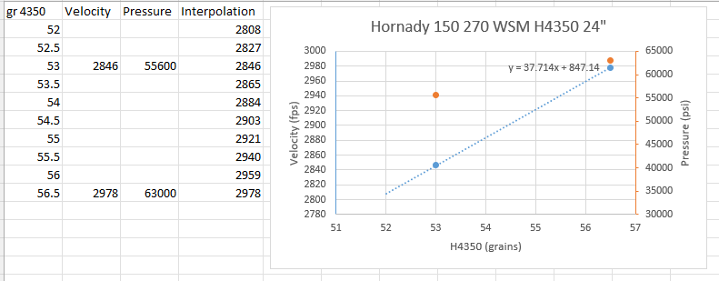

I would chart the data for the Hornady 150 with H4350 and keep it with me while I did the ladder testing. You would see if there was a great offset either higher or lower, but I think you have a good chance of staying safe if they track. It might look something like this:
Good Luck and in for the range report.

View attachment 8236294View attachment 8236296
