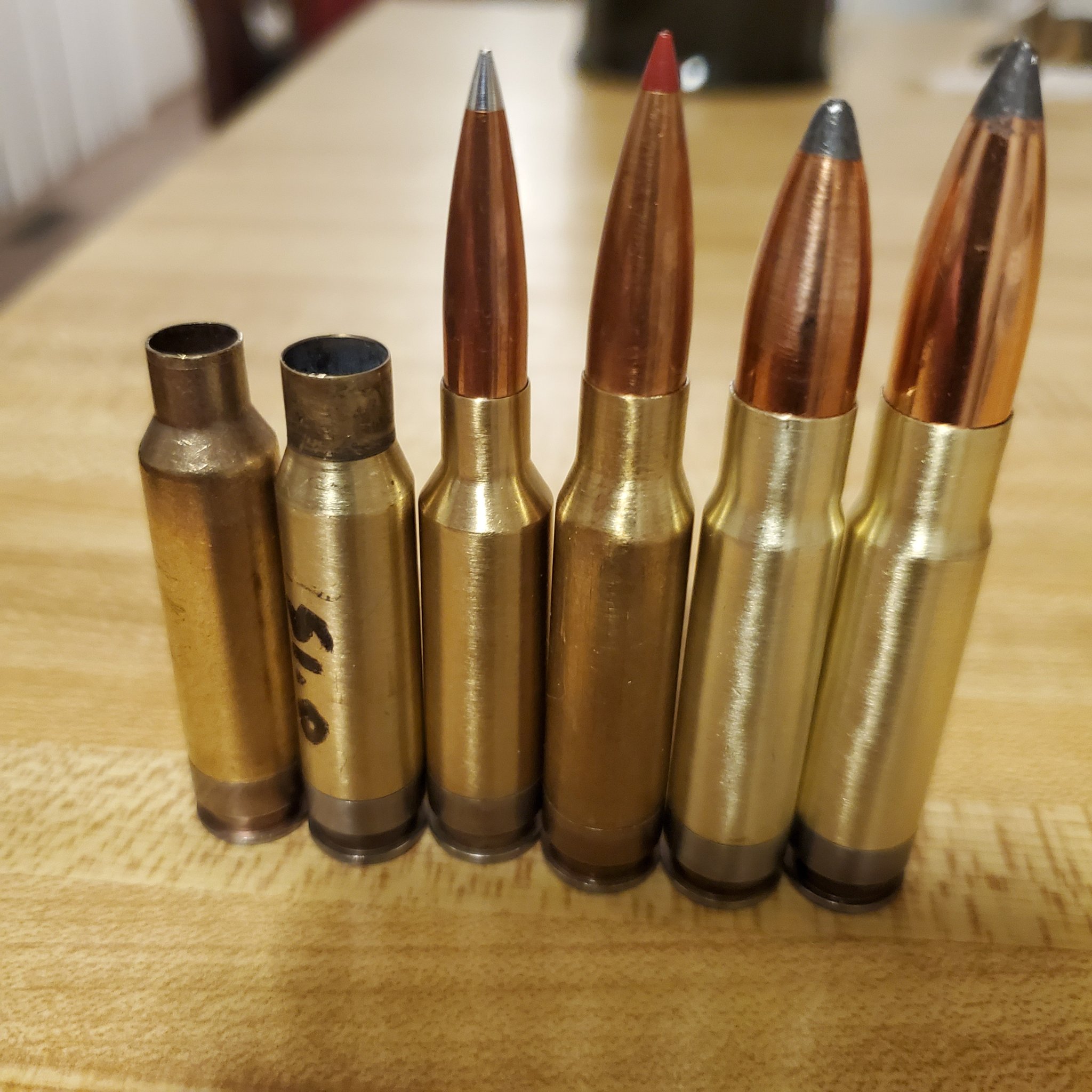

And for those interested with common sense and good reloading skills one can use the 6.8 X 51 hybrid brass for the 308, 6.5 CM, 8.6 Blackout, 358 Win and improve the velocity of any cartridge based on the 308 case head with shorter or similar COAL. And ya don't need 80,000 psi for an improvement. But neck turning and annealing are needed.

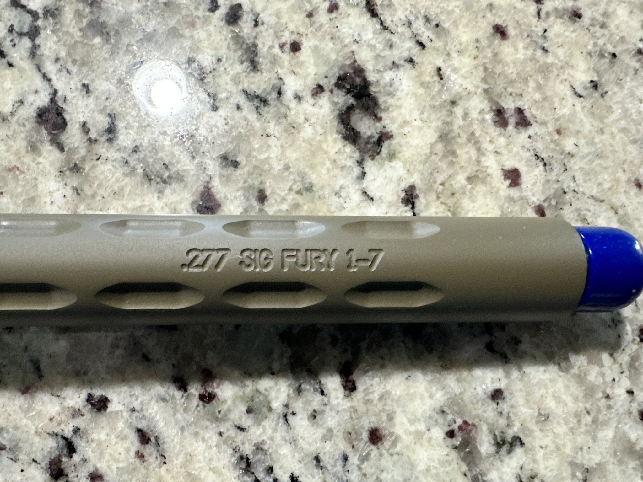

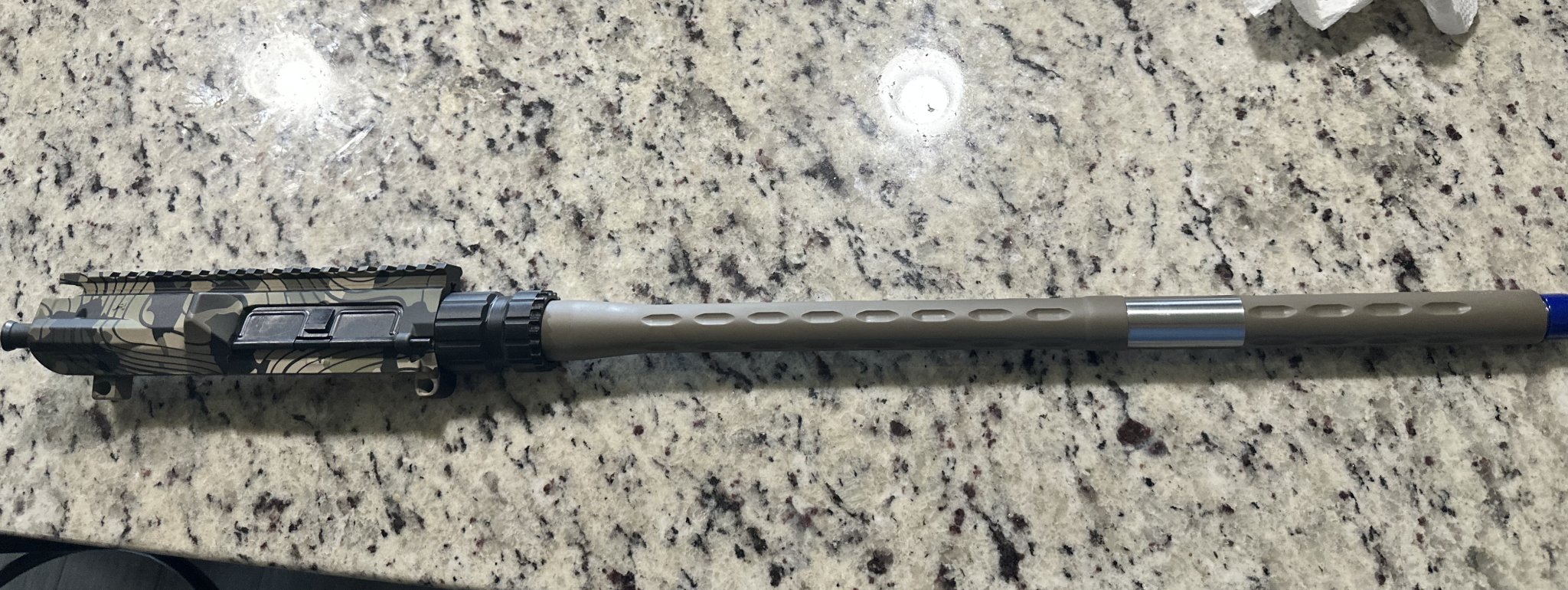

Currently running a x-caliber barrel. https://www.x-caliber.net/ar-10
I chose 4140, 20 in SOCOM Bull barrel, 5R, 1:7 twist. I wish it was better but seeing 1/2 to 1 MOA accuracy. Also using their high pressure bolt.
Remember this is a 65,000 max pressure
.277 Fury, as stated by the manufacturer, not the 6.8 X 51 80,000 psi platform.
