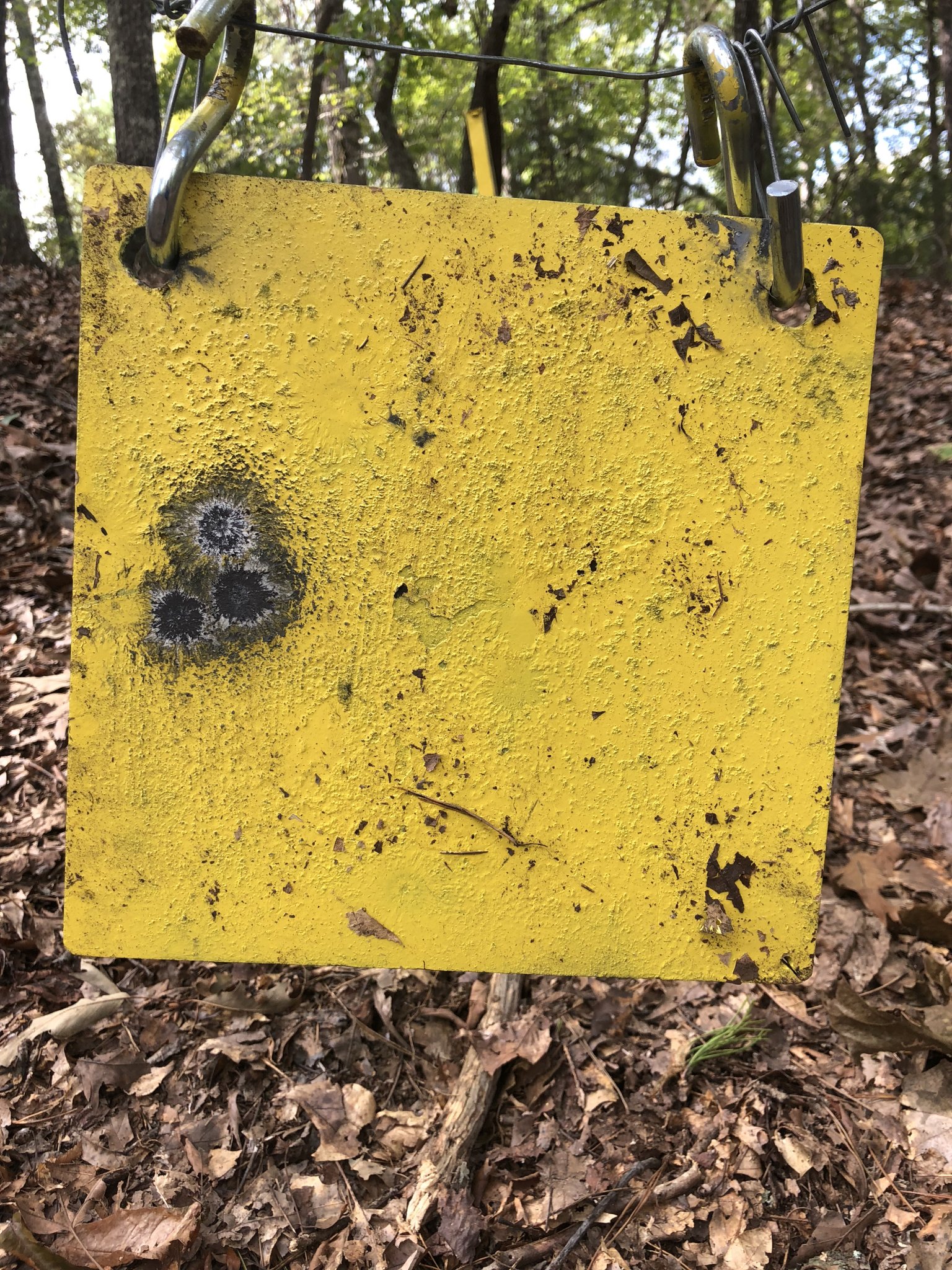

I have a 280AI that was built by Robert Gradous and I love it. Currently I am pushing 168 Berger’s at 2915 and here is a 500 yard group. I would stay at 24 on barrel length.
