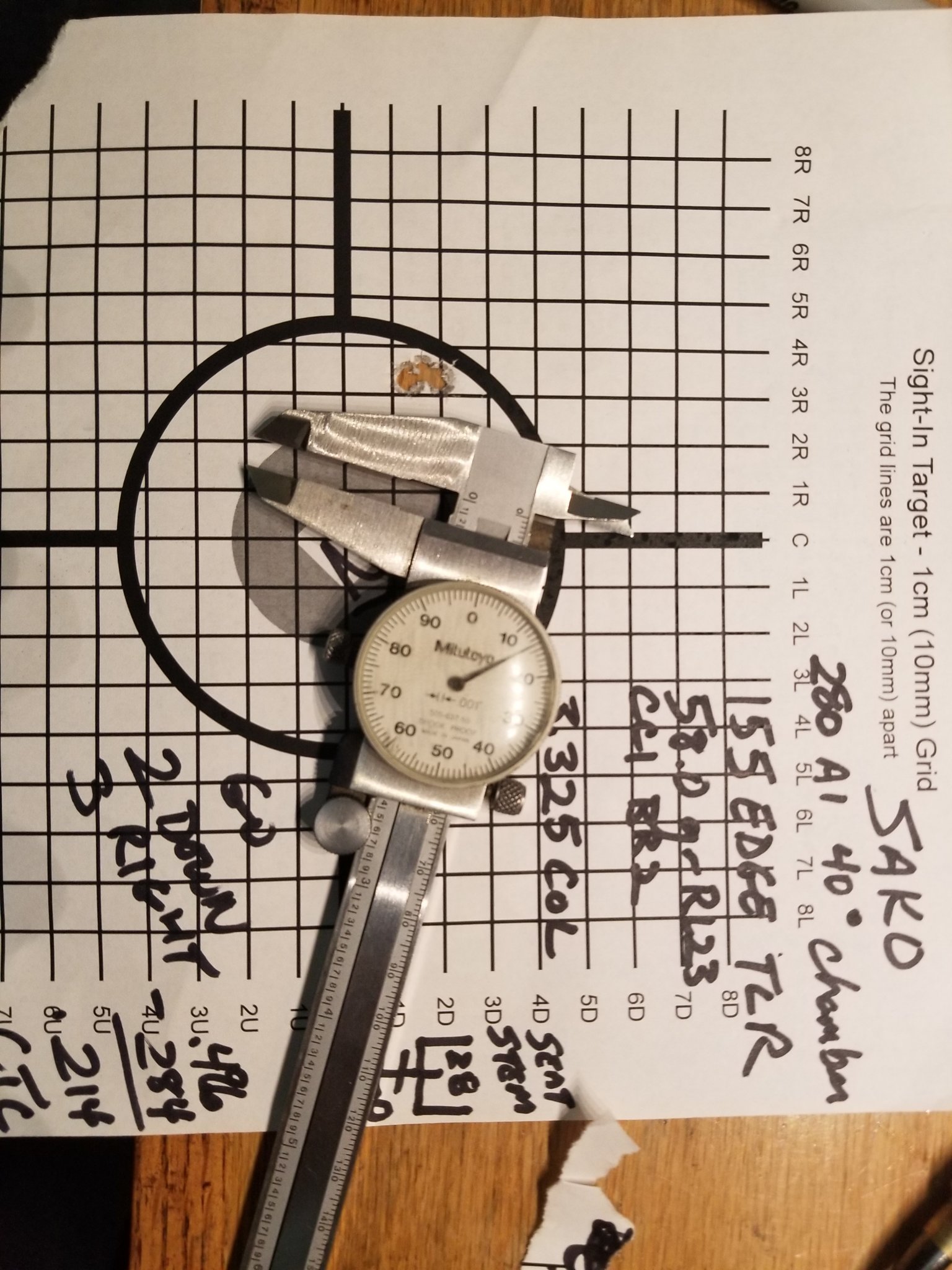

Re: 280AI loads
01/14/2017
NORMA 280ai brass
Fed 210 primers
62.5gr 2213sc (h4831sc)
162gr eldx
3160fps
Es - 45
Sd - 14
Need some more work (current .8" group). Likely to drop back to around 3000fps.
Berger 168gr VLD hunting
Same component as above
60.5gr 2213sc (h4831sc)
2905 fps

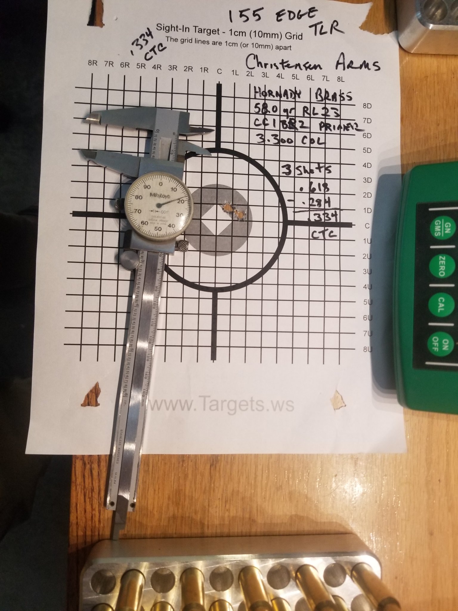

162 d m. 61.4 gr re 26. Nosler brass cci 200 gives best sd so far, wlr gives best group so far. Good groups at .500 with average around .750. 3010 fps out of a 26" barrel. Needs more verifying for accuracy.
Working up a load for new rifle:
26" 1:9" Shilen match barrel - varmint contour
using H4831sc and 162 eld-x's from 56.7 to 59.2 grains
had horrible ES deviations except for one load - 58.6 grains had avg velocity of 2936 and ES of 4. Every other load had ES above 40.

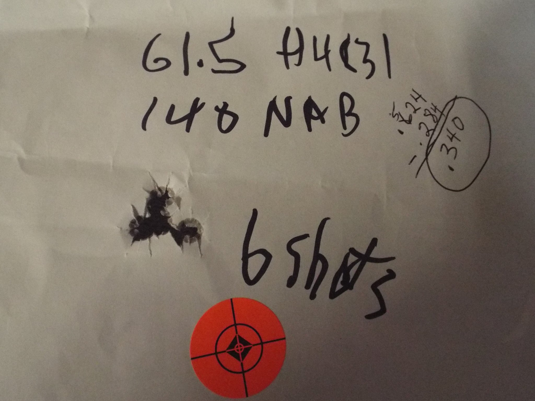

That was the node i found as well. 58.5 4831 sc. There was another at 46.5, but it was really slow.

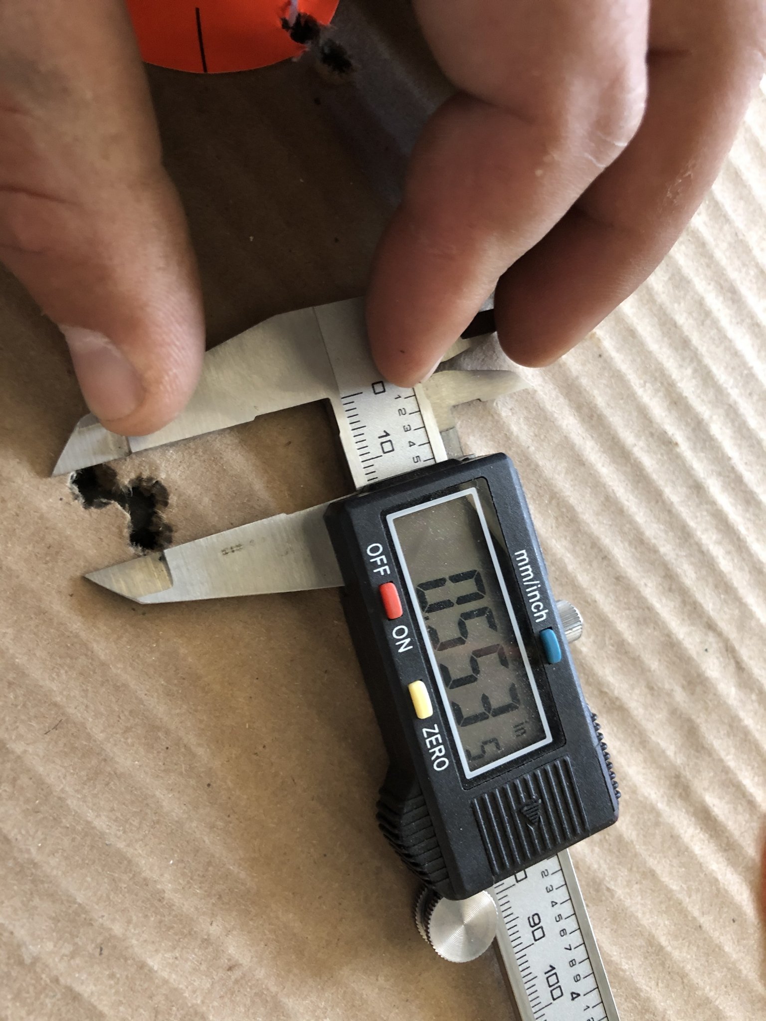

Advice needed, I'm running hornady brass, federal match primers, 180 grn eldm, COAL of 3.480, .010 avg off the lands. My es stays below 20, and sd below 10. My speeds are around 3005 fps, I cannot seem to get better than .75" groups. Shillen 29.5" 1:8 twist barrel. Thanks Logan.
And 63.5 gr of H1000, some pressure signs, nothing crazy.
Try dicking around with seating depth a bit. Maybe .005 closer and .005 further. Back off the powder charge a touch, no need to have ANY pressure signs. Is the neck tension consistent? I anneal every 2 firings on nosler brass and it definitely helped with consistency... just a few things to try
The neck tension seems to be just fine, I was talking to a custom loader around here. He informed me that just because I have great es and sd doesn't mean I am on an accuracy mode. Which makes sense. Thanks for the advice Hookturnr.
Personally I think you have missed your accuracy node - F-class shooters running 7SAUMs tend to run 180s, Bergers or otherwise around the 2940-2950 mark, I'd back the load off to that node. I run 180s in my 280AI at 2820 with excellent accuracy out to 800 metres. I run RL23 with CCI magnum primers and Norma brass -the Hornady stuff is ok though.
I moved closer to the lands, about .008 out. I also backed off the powder from 63.5 gr to 62, and the groups are getting down to around 1/2 inch. I think I might drop the powder a hair more, maybe get .003 closer to the lands. Its running 2940 right now. I'd like to tighten up my groups and speeds.
Good to hear that is taking you in the right direction regarding accuracy. Its certainly not always about speed with the heavy bullets but I reckon seating depth will be the thing that really tightens up your groups now. A change of primers may also help. I only use Federal Gold Match if I can't get my hands on CCI. My go to primer is CCI magnum or benchrest - you may find that helps bring down your ES/SD.
Reactions: [email protected]
Thank you for the advice!

I found a sweet spot around .030 off the rifling in almost every rifle I load for. 59 grs of RL23 with the 162 ELDM 30 thousandths off
just seems to work in every 280 AI we've tried ( 3 rifles here).
I far as hunting ELK, I found a great load with the new Federal Edge TLR 7mm 155 gr in 280 AI. The bullet builds pressure different than a cup/core bullet so take that into account. It behaves like a Barnes more. The rear of the bullet is solid copper and that's probably the reason. I could not get the velocity I was with the 162 ELDM but it was close. The bullet liked .050 to .060 jump and it came alive.
I was getting 1 1/4 to 3/4 groups ( 3 shot) with hunting weight rigs until I hit that sweet spot with the seating depth. 2 rifles with Saami spec chambers, one a Christensen Arms with a carbon fiber barrel and the other was a Savage with a Broughton 5c installed shot the exact same load. 58 gr RL23 CCI Br2 primers, Hornady Brass, 155 EDGE TLR seated aprox .050 off the lands at 3.300 COL. Shoots around
3/8 to 1/2 in both guns. The other was a Sako rebarreled to a 280 AI 40Degree, older reamer . It was same load just at .060 off the lands.
Shot .214 CTC with a pencil barrel for 3 shots. Sako was slowest at 2940 FPS the Christensen was around 3004 FPS avg.
I really didn't expect that bullet to perform like that but it does. I got nothing to write home about up close to the lands, but .050 to .060 off really made them shine in all 3 rifles.

New 280AI
Brux finished at 26"
140 gr Accubond
61.5 grs. of H-4831SC
CCI BR primers
Norma 280 brass
Today I put 6 shots into a group that looks promising. No pressure signs in my rifle. Also, 56.0 grs. of IMR 4350 shot even better. Day after tomorrow I will take some more of the same powder charges and go out again. I shot 50 rounds today and was a little rummy toward the end. LOL.

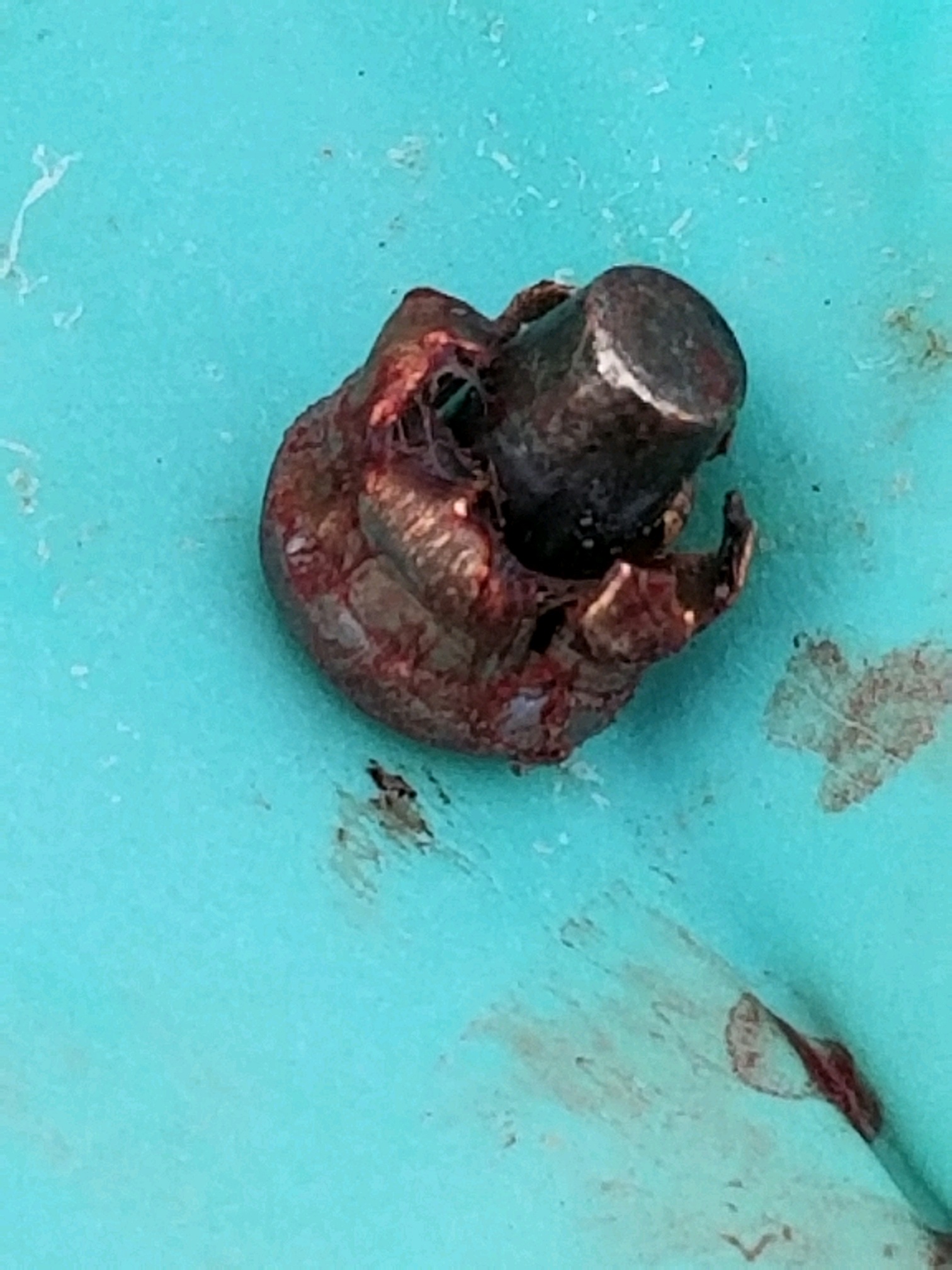

I think the Accubond LR is great for deer, not so much for ELK. My cousin shot 2 Accubond LR 142 gr 6.5s into a 5x5 Elk last year and both of them came apart at 500 yds. It killed it but the bullet is too soft. We won't use them anymore. Here is a pic of a TLR that went from left front shoulder to right hip and stuck under hide on a 6x6
Bull this season. 7mm 155 Edge TLR 280 AI muzzle velocity about 3000 impact at aprox 250 yds on 750-800 lb animal. My brother took this one and my cousin took a cow broadside with same load and bullet was complete pass through.

Thanks for sharing and nice elk! How was accuracy with those TLR's?
I'm bummed to hear those Accubond LR's are breaking up. That has been the complaint of the ELD-X too, I was hoping the bonded Noslers would be better.
I have heard those TLR's are performing well on animals but the article I read says they aren't a match bullet and average about 1 moa.
