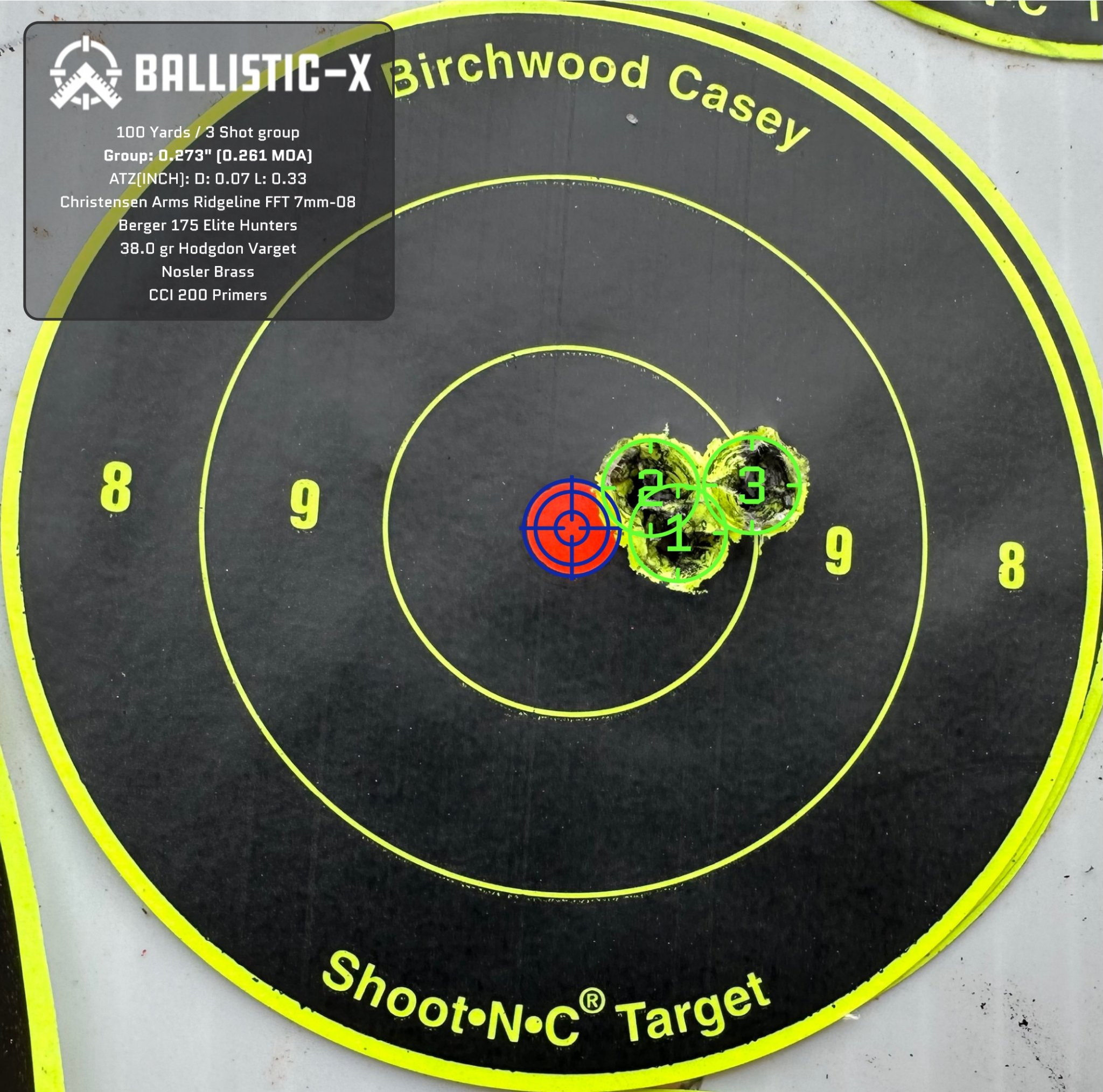

There's your problem... Everyone loves to suck-off Tikka on this forum, but facts are, they're really not that great for custom actions to build into long-action cartridges, unless you stick to factory ammo. Factory rifles and short-action cartridges, sure... But LA cases...No.
But to help you out... I have a 7mm-08 that I'm jumping Berger 175 Elite Hunter at 0.135" due to the short-action not having the feed ramps milled for an AICS mag (which will get done when I have to rebarrel it), and they shoot 1/4 MOA (typical groups are around 1/3 MOA)... The best way to go about this, is to set your OAL, and then work up loads with different charge weights to find what shoots best. This is how I do all my load development, but it also works best to do this with rifles limited by mag length, where you have to set your OAL by the magazine.
