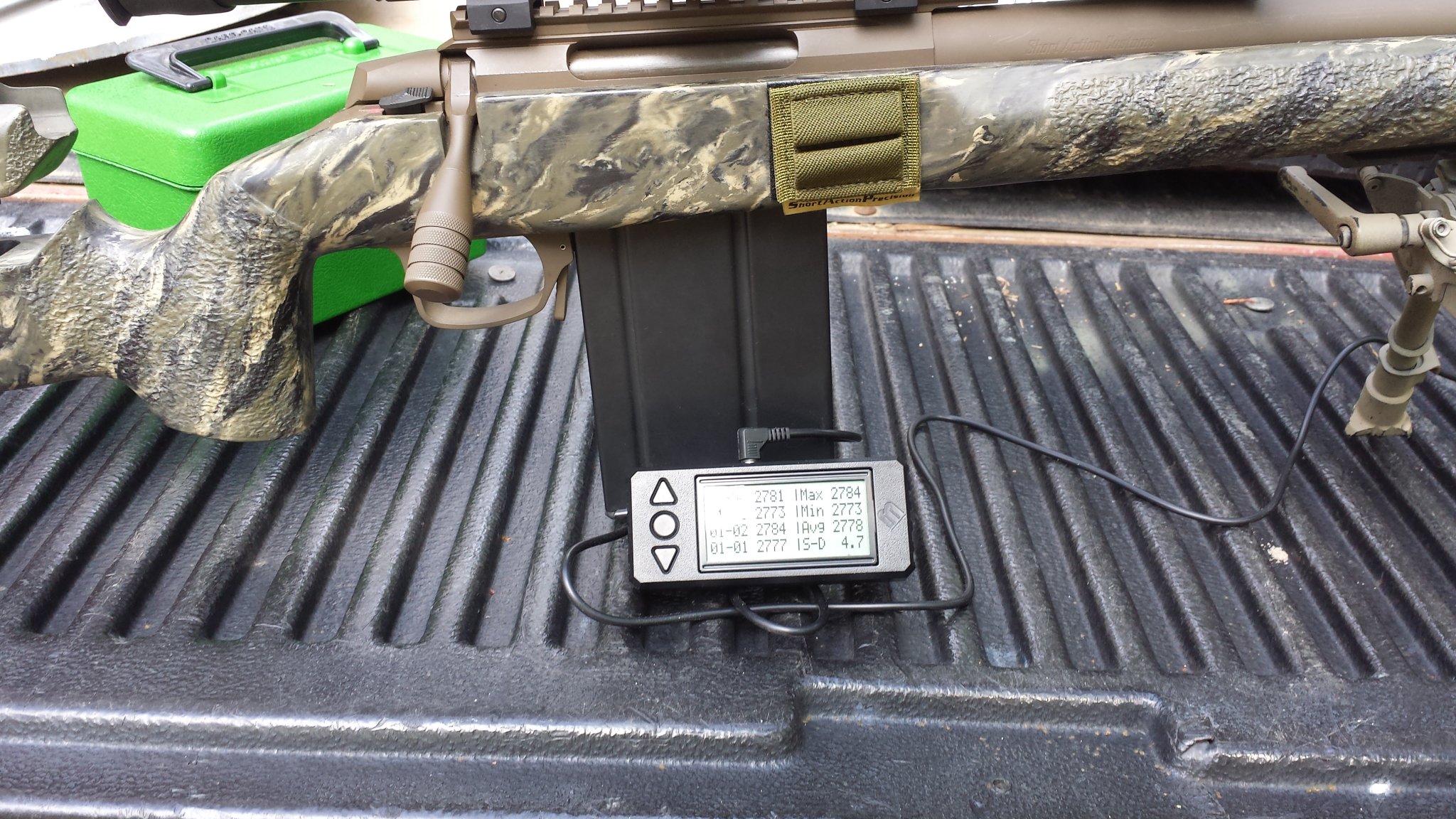

Thinking of building a hunting rifle in .284 Shehane or straight .284. Could I get some feedback on velocities out of a 26" barrel with 180's. Most everything I find on velocities of the Shehane are the Fclass guys running 30-32" barrels. Thanks
This is a Bartlein 26" barrel in straight 284 with Berger 180 hybrids. I'm in the low mode here with H4831SC. You could push it more than this, I chose the low node for a little more barrel life and because it shot so well.
Reactions: xsn10s and lou400a

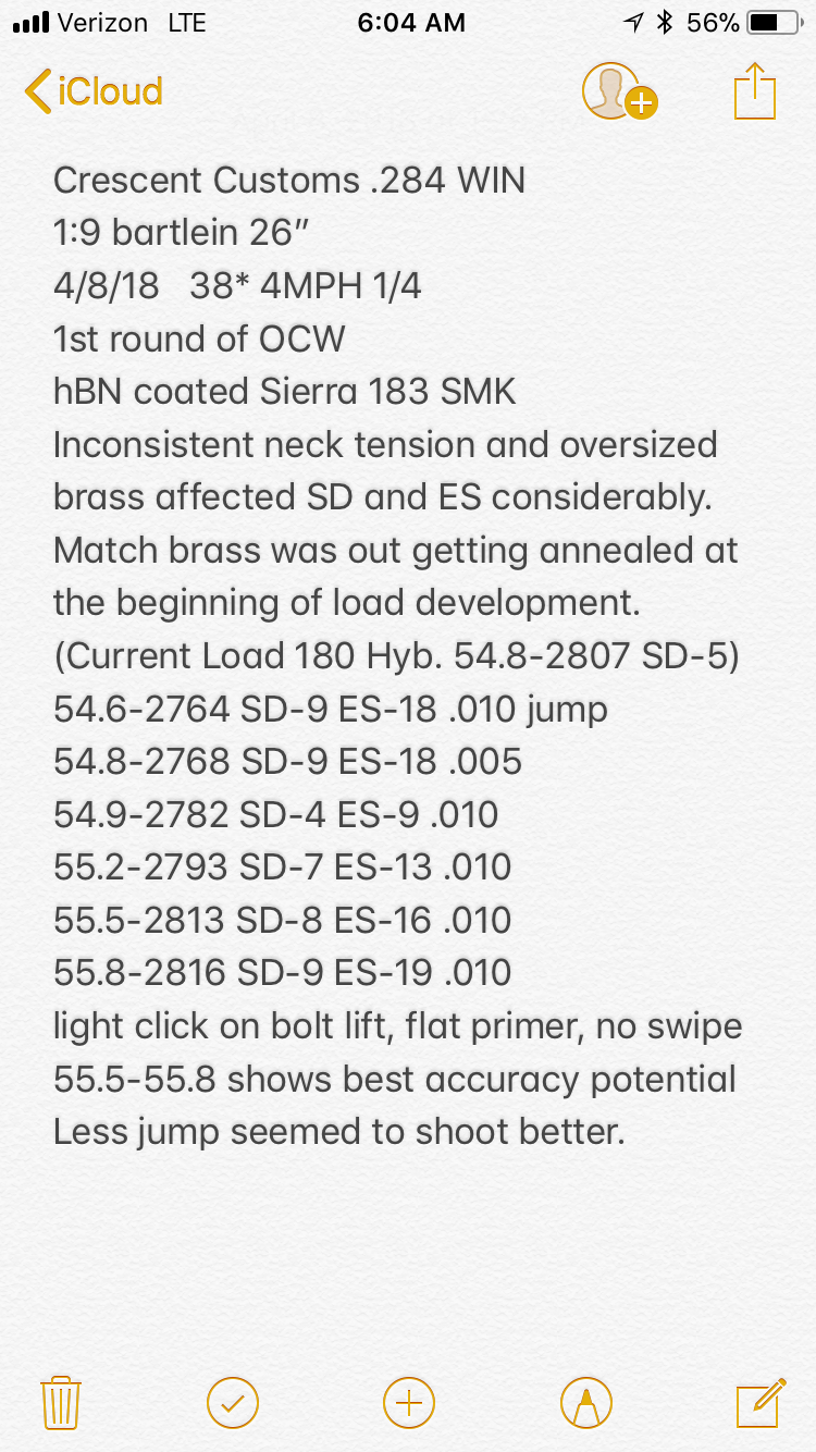

Don’t know if it’s worth anything to you, but here’s a few notes I jotted down during load development.
