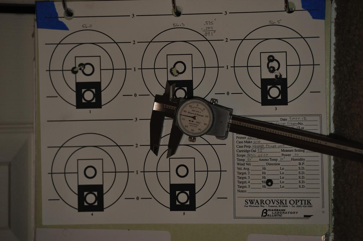

I'll chime in with my two cents.
Winchester brass. SAAMI minimum chamber throated to load Berger 180 Hybrids to 3.2" OAL.
Match-prep the brass. Weigh, trim, flash hole, etc...
56.3 gr of H4831SC.
Here are the results:
