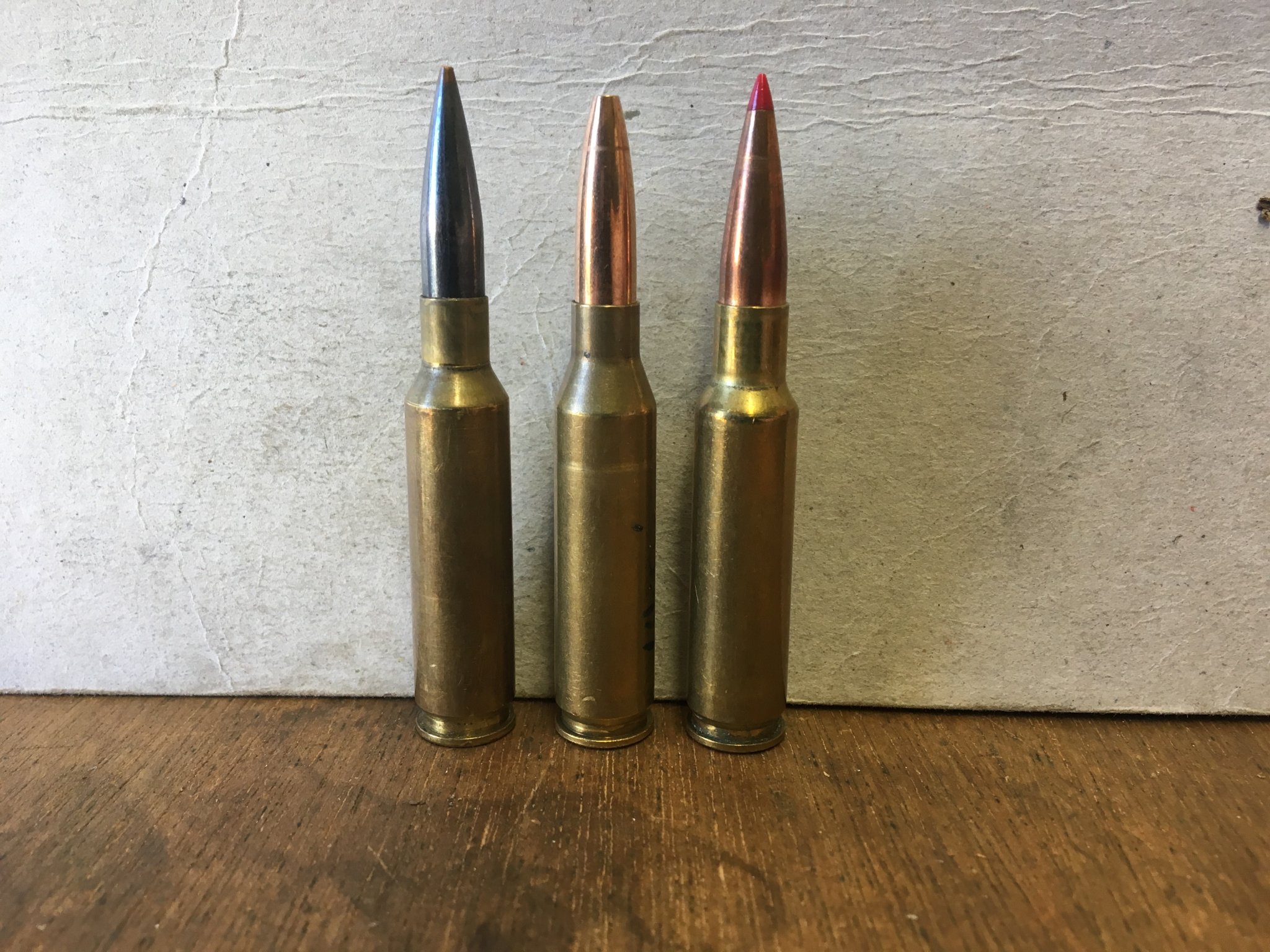

I forgot to ask about this, how comparable would the brass dimensions of a 7mmSAW be to what a 7mm SLR would be? I haven't found any details on the 7mm SLR on ye olde interwebs
I don't think a 7SLR is a thing. The SAW looks like someone took the 6 and 6.5SLR design and simplicity to the 7-08. Same idea. Longer neck and a 30*shoulder
I followed this up and had a mate take a pic of one of my rounds with one of his 6.5SLR rounds. It’s pretty much as you said. The 7mm SAW case is a virgin case, my fired cases have a sharper shoulder edge.
6.5SLR, 260 Rem, 7mm SAW
