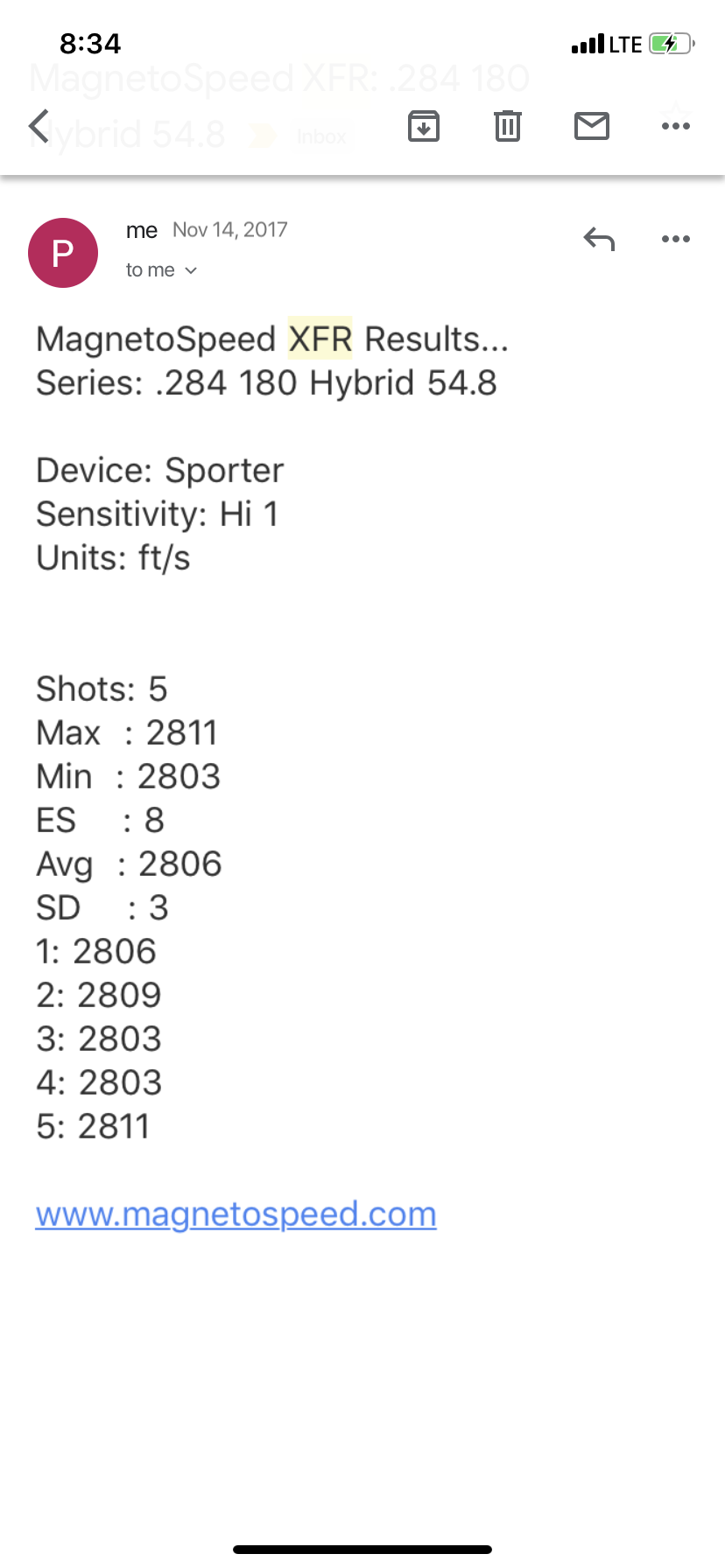

26” .284 WIN. Middle of the road charge with 4831SC.
No problem. If it makes any difference, it’s a 9t Bartlein spun up by Moon on a defiance. FGMM LR primers and Winchester brass. It is the most consistent rifle I own. I don’t shoot it much anymore, but when I go on a hunting trip it’s all I take.

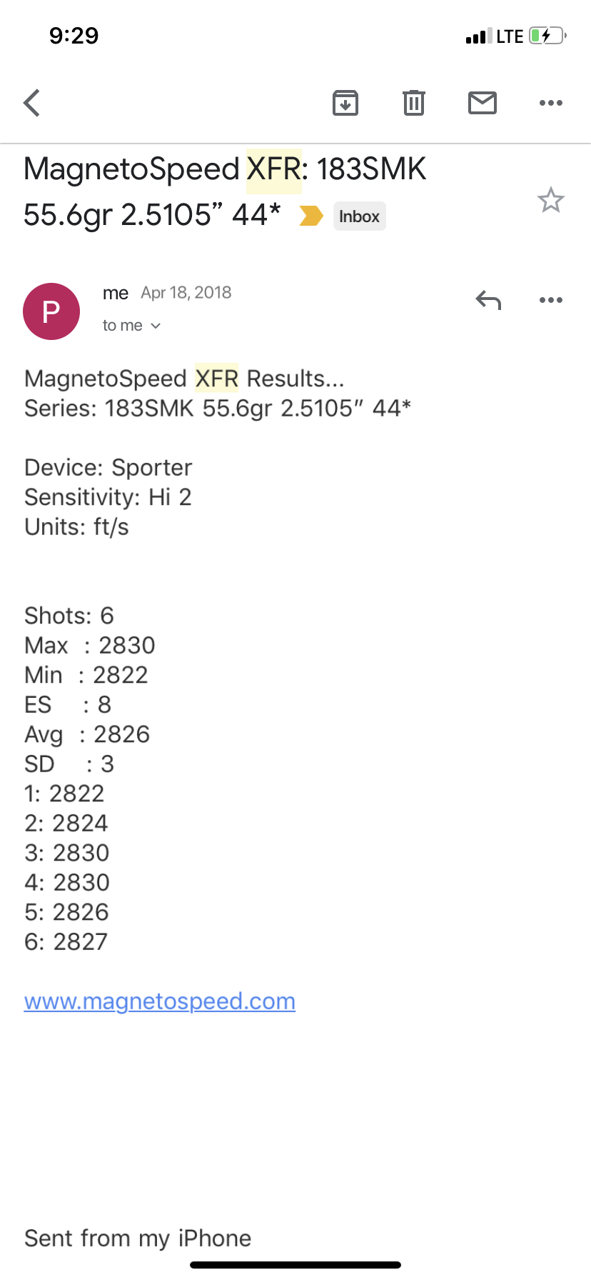

Found this, pretty hot loads if I remember correctly.
