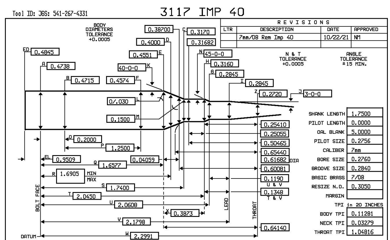

Shit, I have both sitting around. JGS reamer and Forster go, no-go. What reamer you go with? Here's mine:
