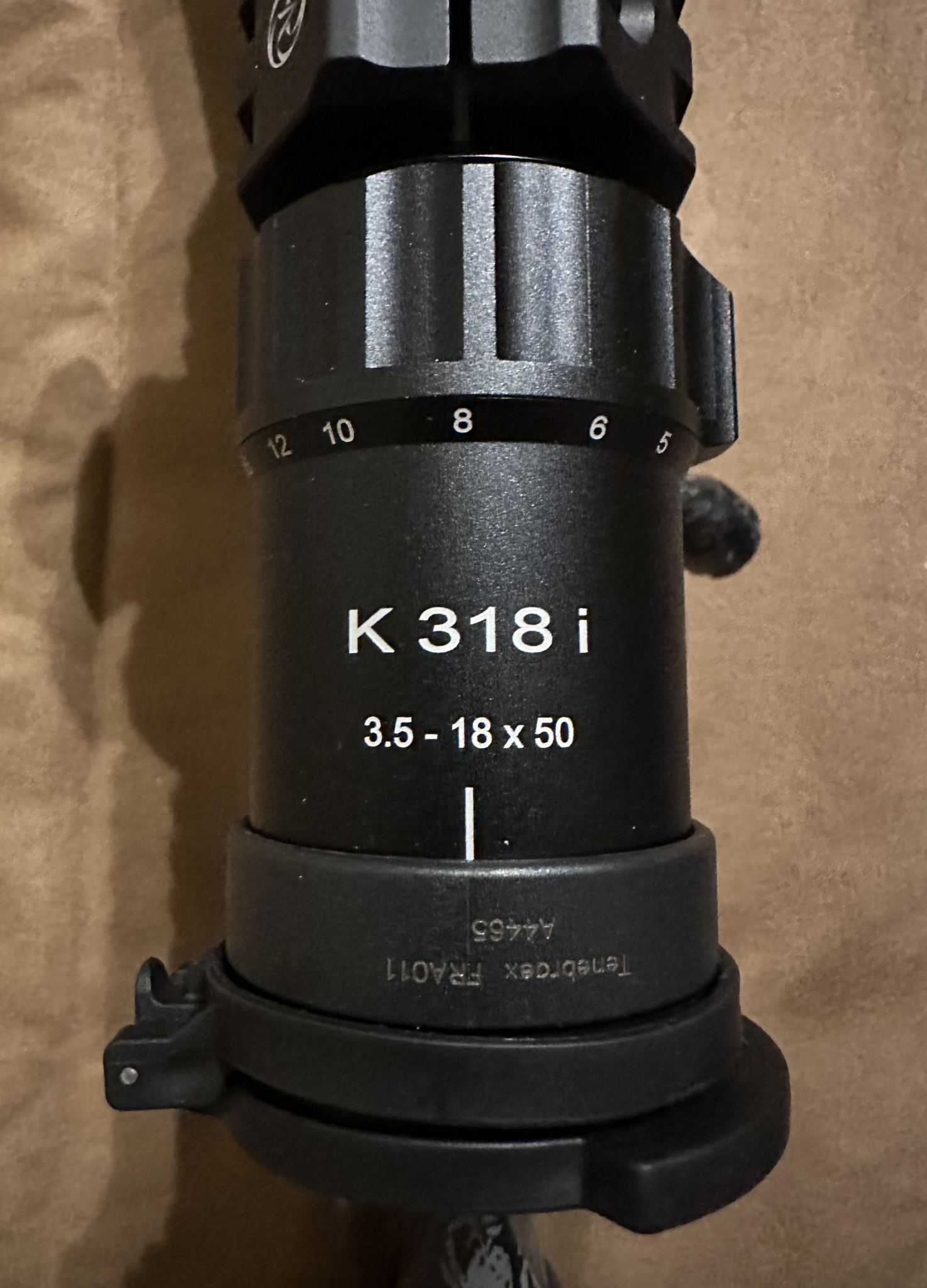

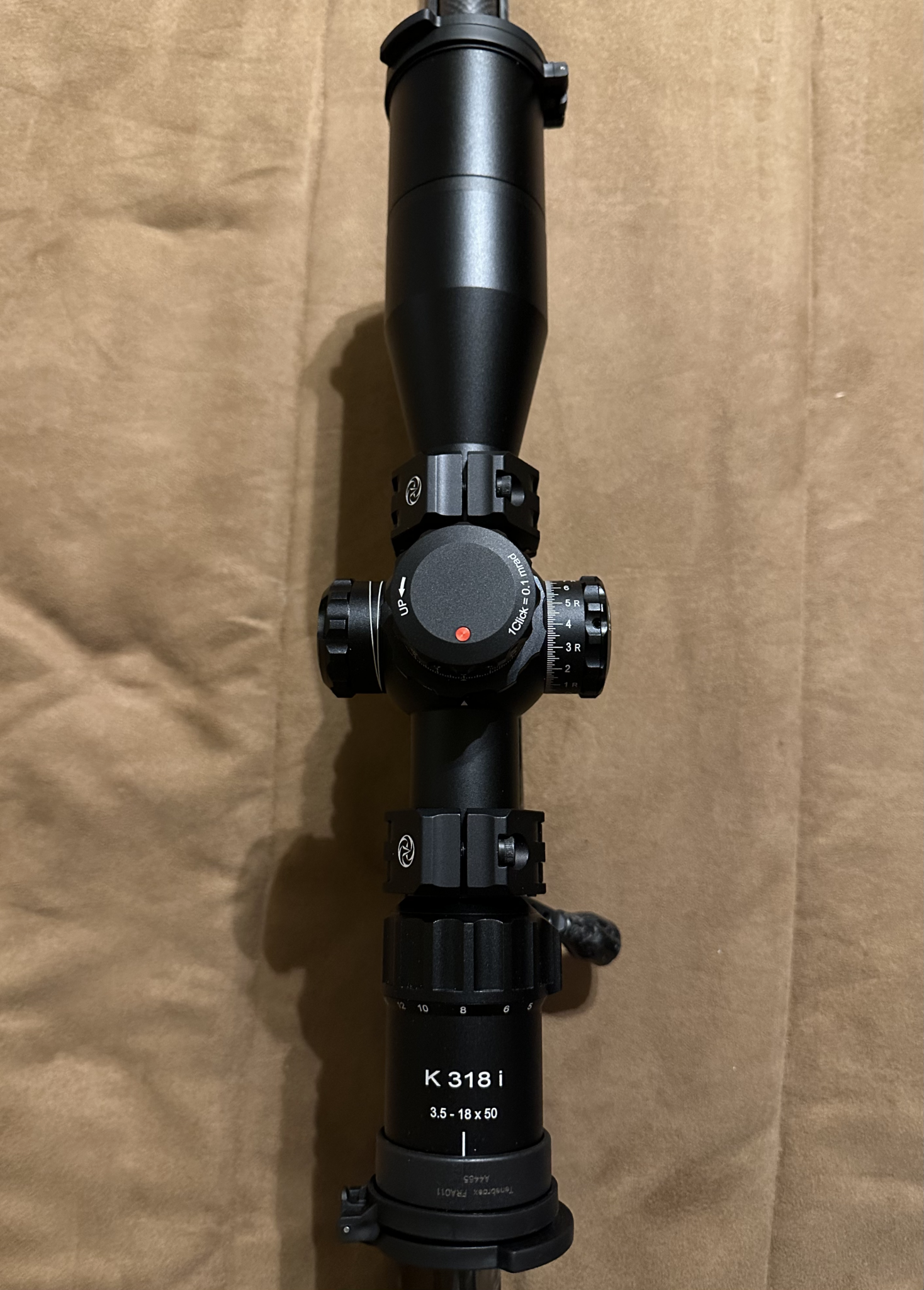

Well, because of this thread and some other sources (reviews and videos from the Dark Lord of optics and glassaholic) I´m listing those right now:
Kahles K318i
Steiner M7Xi 2,9-20
Zeiss LRP5S 3-18x50
March D2452 IFML
I think they are all very good, and each of them has their pros and cons, which I´m trying to find out right now.
Kahles K318i
Steiner M7Xi 2,9-20
Zeiss LRP5S 3-18x50
March D2452 IFML
