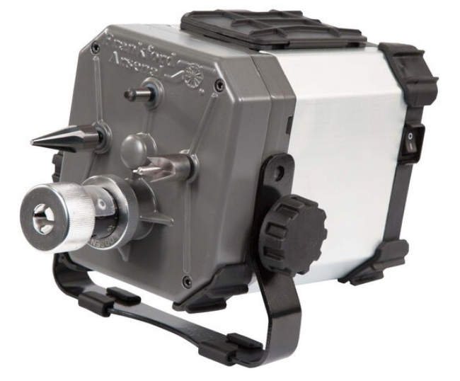

    On that list above, there is a Frankfort Arsenal Platinum Case Prep Center with trimmer that is missing because it is a straight cut. It is an entry level tool, but a very good one for the money and is a shoulder index type that is fairly universal. Looks like this. It is not a three-way machine but a straight cut where you then still must move your work to the inside and outside chamfer tool before it is finished. Still pretty fast and and easier on the budget. YMMV
