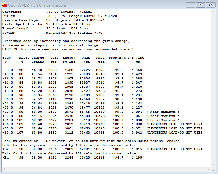

    Anybody try this combination yet? Getting ready to try it with Berger LRT 175's. According to QuickLOAD ... it looks pretty good. 100% fill and 100% burn at about 59gr with 2625 fps velocity. The numbers actually spec out better than the Accurate 4350, MagPro, and IMR 4831 that I have as powder alternatives. Thoughts ... Experiences ... Advice ???

    I did, for several other bullets I use. I learned a secret from chatting with them. They use QuickLOAD to determine the majority of their load recommendations. And where they have independent numbers either through test or recommendation ... they verify via QuickLOAD prior to publishing them. It's one of the reasons I bought the software. It's awesome to get good starting points for load development, and thus far for my 6.5-CM and 300-WM testing, it's been remarkably accurate.
